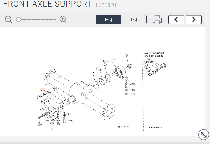

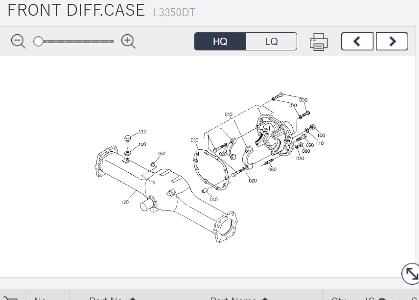

My question is what are the next most likely "fuses"/weak links inside the front axle?
Appears parts availability is decent(?) and plan to do the work myself (should have any specialty tools required)
Looking at the exploded, appears the input is direct to the pinion?
As stated by the seller and confirmed by myself:
  • the output from the rear spins fine when engaged
  • while lightly worn, the splines on the prop shaft and couplers are serviceable
  • the input (pinion) of the front axle will spin freely by hand with *NO* detectable gear mesh felt​
This leads me to think the ring and/or pinion is roached?
Unless someone thinks the R&P could be rotated by hand and some other hard parts outboard might also be to blame?
Once it's here, will be opening it up to find out 😬

Unlike smaller models that require you to pull the hub and axle and multiple other parts to get to the guts, this one you pull a couple mounts' and a cover and you'll have your answer staring you in the face.

My assumption was the ends would still need to be disassembled to pull the inner axle shafts out of the side gears, before that removable center section would come out, correct?

Well dang, looked at it way too quick, you might be right on the mark with that... 😣

Even if all the gearteeth were gone, I'd expect some residual noise/feel and a handful of metal in the oil. Just to broaden the scope, I'll bet that something inside has been removed :)

Agreed... Was able to spend a few minutes earlier today checking.
Raised the front tires off the ground:
drivers side took more effort and could feel it spinning parts...
pass. side spun freely, as if zero gears/shafts connecting it...
pinion input continues to spin with moderate effort and no movement from spinning the tires
Unfortunately, will be "several" weeks before I have time for exploratory
