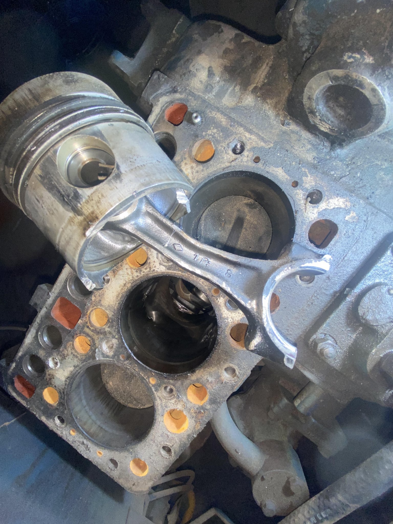

I apologize for not going back to my room and closing the door… But…this is a picture from that other thread. Apparently connecting rods are two piece like I had imagined, as they are on a typical gasoline engine.
So if anyone can explain to me why, if it’s possible to remove the oil pan and the head while the engines in place, why it would not be possible to remove the connecting rod/piston, it would help me sleep better during the afternoon nap that I never take…🙂
I’m absolutely missing the point why the engine would have to be pulled out to remove a connecting rod/piston (the original question), IF the oil pan could be removed and the head could be removed while the engine is in place.
If anyone can explain exactly what I missing I’d appreciate it.
edit: 😂😂😂 You guys have proven again that you’re a lot smarter than I am! Or at least you read better and pay attention to the details! After reading the original question, probably 10 times I see that the OP wants to pull the piston connecting rod out the bottom of the engine. I would’ve never thought to ask that on my own in a million years…
most connecting rods are two pieces, the main shaft, then the part on the bottom that bolts around the crank, onto the bottom of the rod, the bottom piece is held on with two bolts that fasten it to the lower section of the rod. just like a car/truck engine, once the oil pan is removed, you then unbolt the lower section, then tap, hammer..how ever it takes ?..to work the rod/piston out the top of the engine. mind you, the head has to be removed before you can get the piston out the top.
