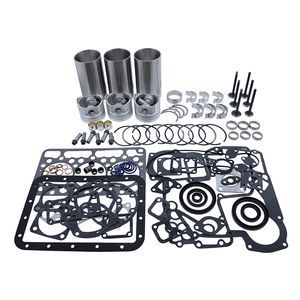

Pistons are easy, there are whole kits available
But like others have stated if the crank is bad, that can be a real killer.
The crank is the same for a D650, D750, D850, D950.
I do believe original pistons had a different skirt on #2 piston, but I think Aftermarket pistons are all the same.
