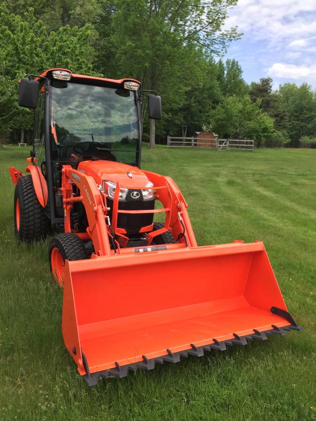

I just completed installing my PTB. Took around 45 minutes.
I am going to use my loader as soon as it cools off. I will be moving dirt from a hard bank behind my house in the cow pasture. I will advise the difference as I have gotten dirt there before the install.
By the looks of the PTB I think I will be happy.

I have some of the rockiest soil I have ever see in my life. I used my tractor for two years to dig out rocks before I decided to buy the PTB. I am very happy with it. I wish that I did not wait so long to bite the bullet and buy that bar. I have never read a bad word about it and I cannot think of anything except good to say about it. You have several endorsements from others on this forum. I think all would agree that it is one of the best things we could buy for our tractors. It truly is money well spent.
