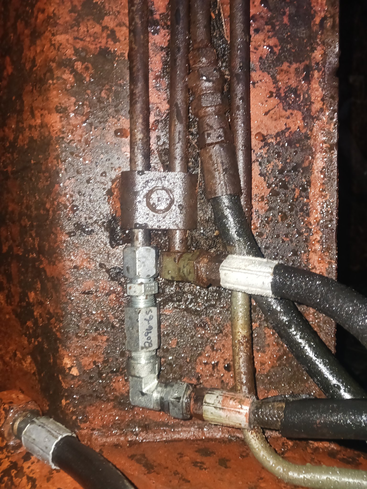

Pinhole leak in metal hydraulic line

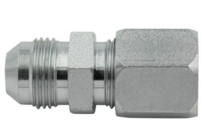

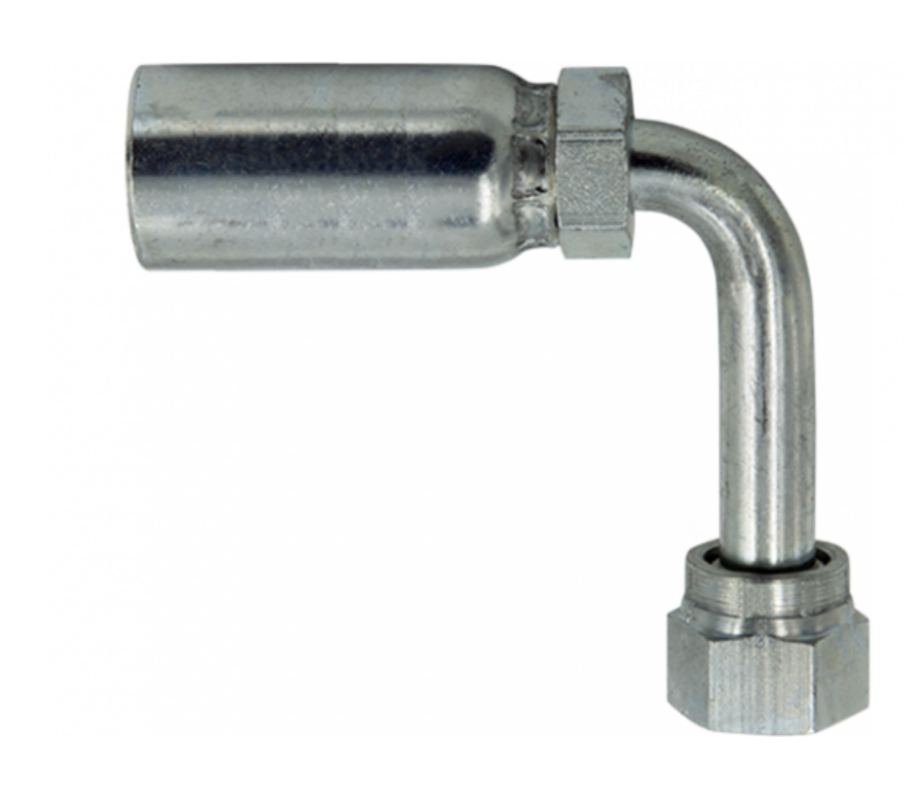

Another option is to use a compression to JIC adapter, then have a new hose made with a long 90° JIC fitting on the end.
I like that idea a lot 😍
Just cut the end off the existing hose and crimp on the new one. Any hydraulic shop can do that.
These convert-a-flare tube nuts, sleeves, and a plain JIC tube union are much less expensive than the male JIC compression fitting. I use all of those bits a lot and have them on hand. In addition to being a lot less expensive they allow you to skip dash sizes - e.g put a -08 end on a -06 tube.

I'd just caution OP to measure that hard line before ordering parts.

Thanks all for your input! I went to a hydraulic hose shop as recommended. They did not think a compression or flare fitting would be a viable option.
The compression fitting is a good solution; I have used it and have seen it used many times. Just cut the tube back a little to get to a good section of the tube, and emery cloth it clean and smooth.
Their first recommendation was to tack weld it ALA Smokeydog.
Do not try welding it. The tube is worn thin and rusted—pitted. If you weld it, you will very likely get debris from the weld in your control valve.
Their second recommendation was to replace the whole metal section with rubber hose (I tried sourcing the OEM part [70050-00709] but it's discontinued and impossible to find.) They were thinking this is would cost about $150 to $300, which is actually less than I thought but still steep for a poor tightwad like me.
I have a friend that can MIG weld it for free, but not until next Sunday and I really need it ASAP.
A couple people have recommended JB Weld. I have some which is rated to 5000#.
Only in your wildest dreams would JB Weld repair a high-pressure leak in a hydraulic tube.
Do I have anything to lose by cleaning it up really good and trying that first?
Use a compression fitting and add a short section of hose to repair it. Just use two P clamps around the tubes rather than the c-clamp to hold the hose and tube in place.

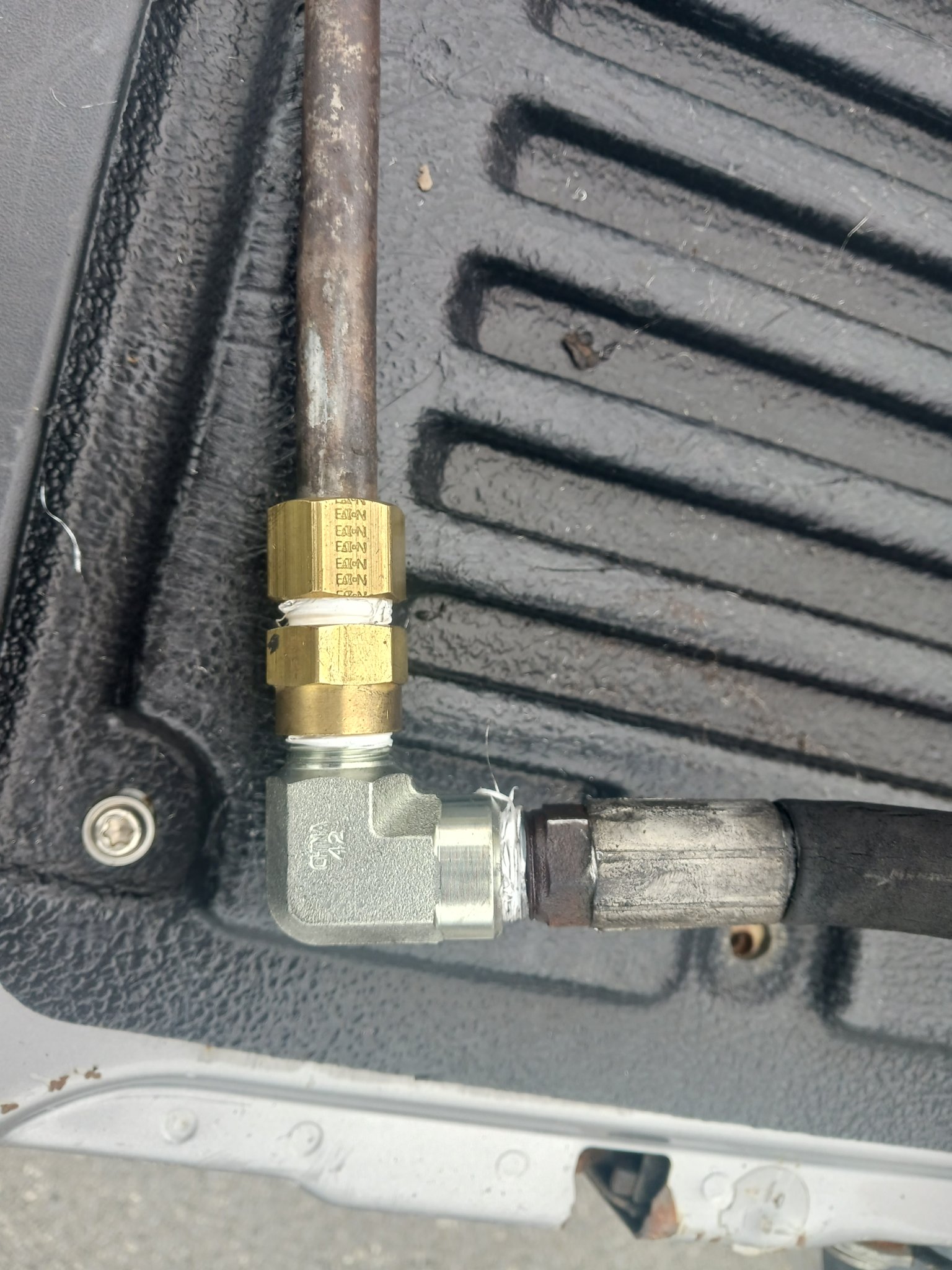

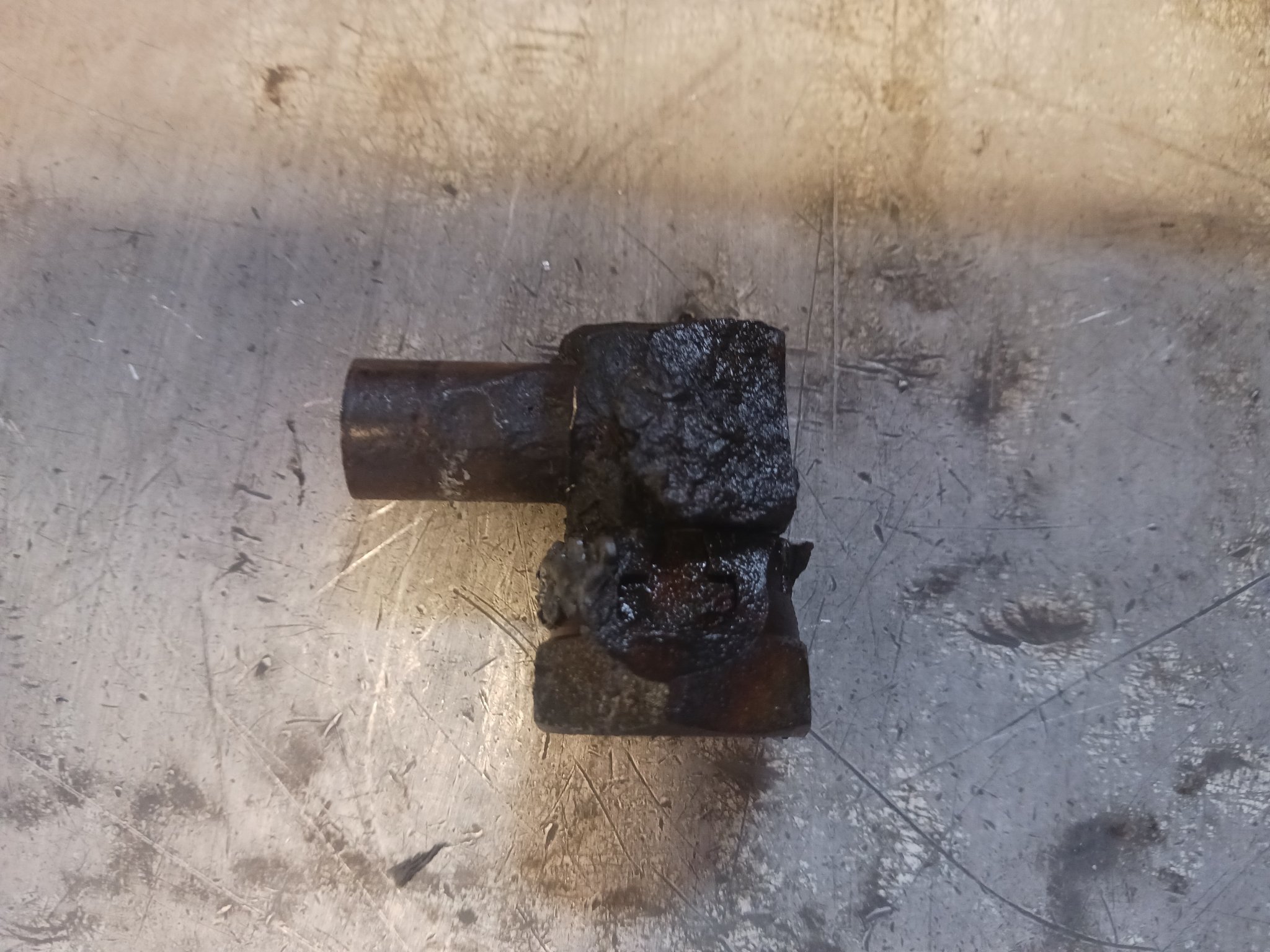

I was able to find a compression fitting and an elbow at Napa, total $30.
As you can see from the picture below, turns out the pinhole was just one of many issues with that joint on the original hose. I have no idea what happened to it but it looks like hell.

That compression fitting looks to be the 100% wrong type.
The brass is the giveaway.
Hydraulic fittings are always steel, as Brass can not hold up to the pressures.

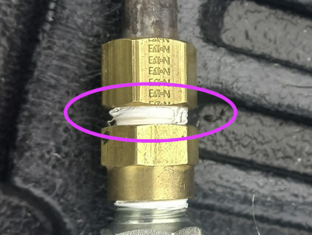

In addition to what others have said about not using brass fittings for hydraulic, do not use thread tape on compression fittings.
Got it. I actually asked the desk person if I should use thread tape and he said yes (also, there is evidence of thread tape on all the other hoses on the tractor.) I guess it makes sense he also I will remove it, thanks for the advice.
Purely out of curiosity, why not? Bits of tape in the system?
10,426
5,613
Purely out of curiosity, why not? Bits of tape in à system?
The desk guy ia clueless.
You only use thread sealant on joints that seal on the threads. Thats pretty much limited to rigid male pipe connections.
SPECIFICALLY
You do not use thread sealant on fittings that do not seal on the threads:
  1. JIC
  2. ORB
  3. BSPP
  4. Compression fitting nuts
  5. Female pipe swivels.
