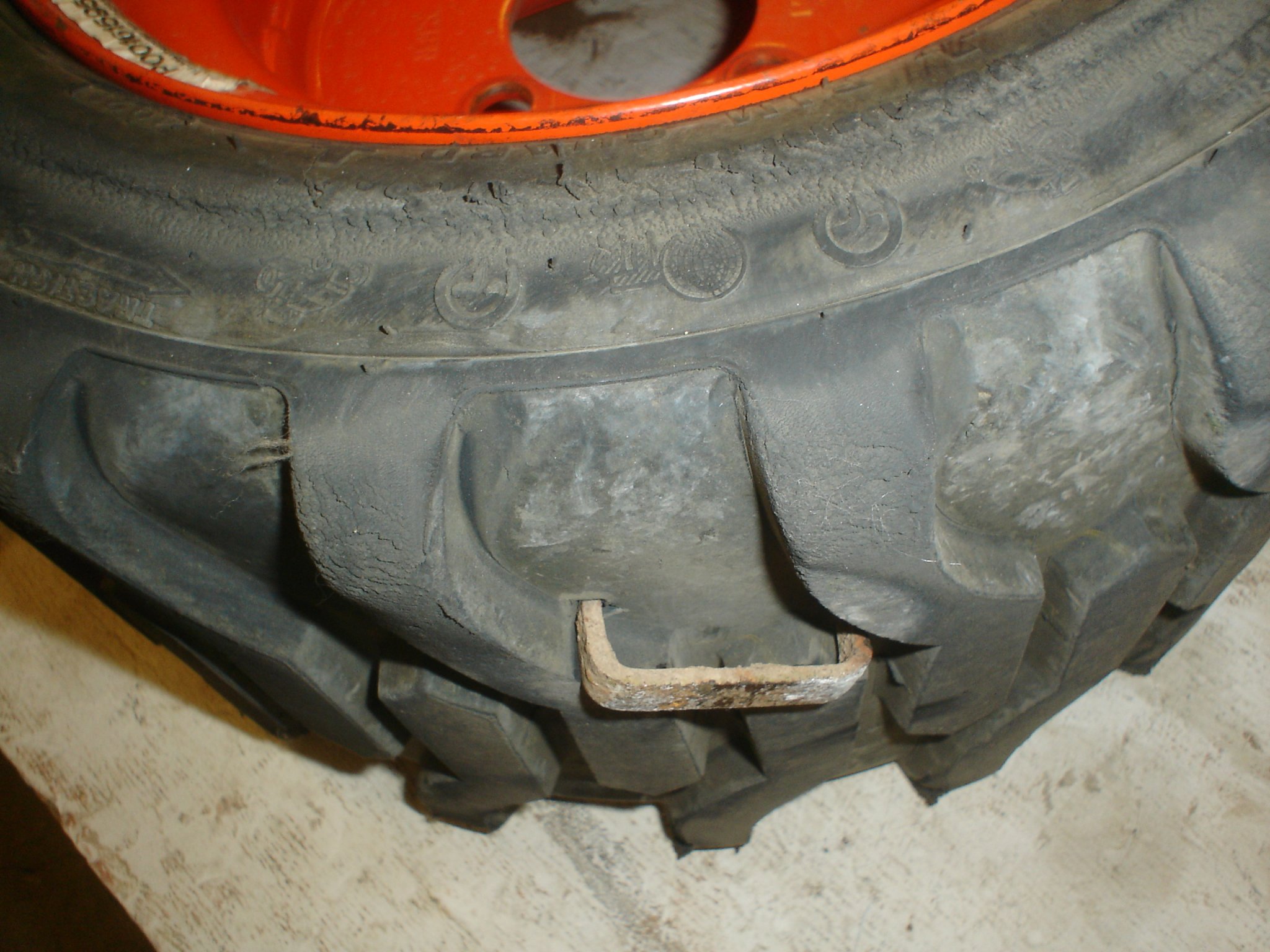

I have a L3130. I was mowing over by the neighbors and evidently, they tossed a small piece of 2x4 with a framing nail punched through and pointing up. My rear picked it up and when I removed it, the air gushed out.
Now, I see some use a plug to fix it and others say have it patched. What's the best route for a permanent fix?
I had an older L-3800 , R-1 , tires. Plug did not work as tires were tubed. Front were tubeless, plugged a few times.
Check with dealer who sold to you?
