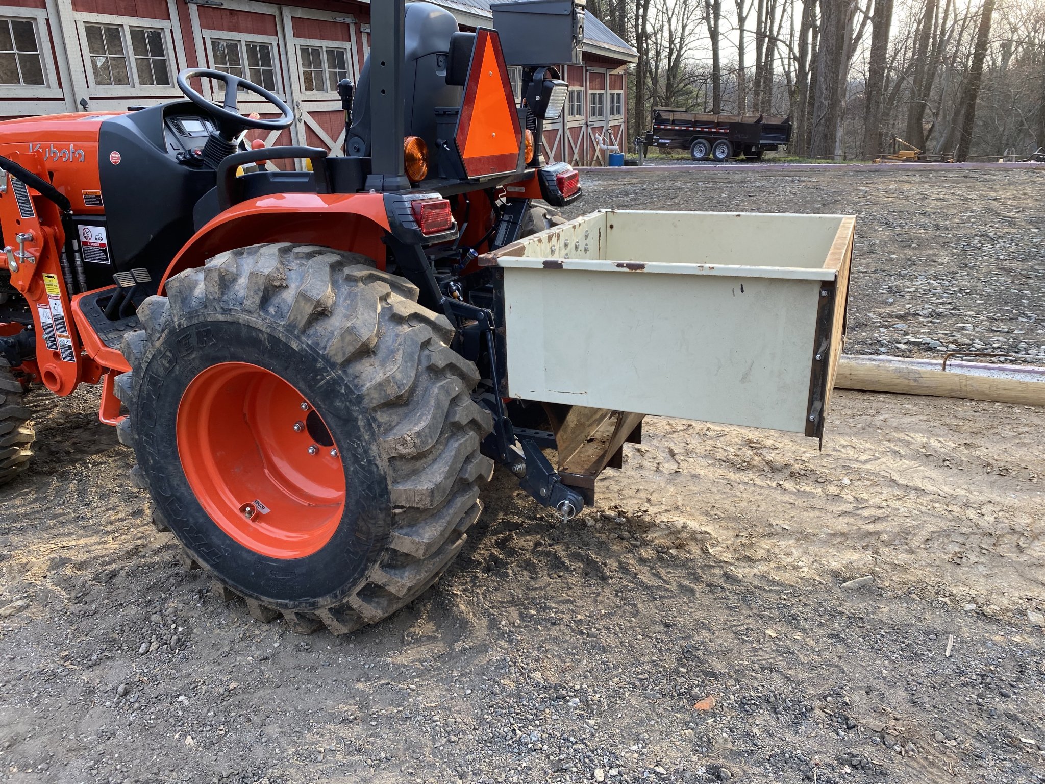

I don't use the rear PTO very often but I do have a need to carry tools, chainsaws etc... quite often. I cut a garden cart in half and made a short "pick-up" bed which is working out well.

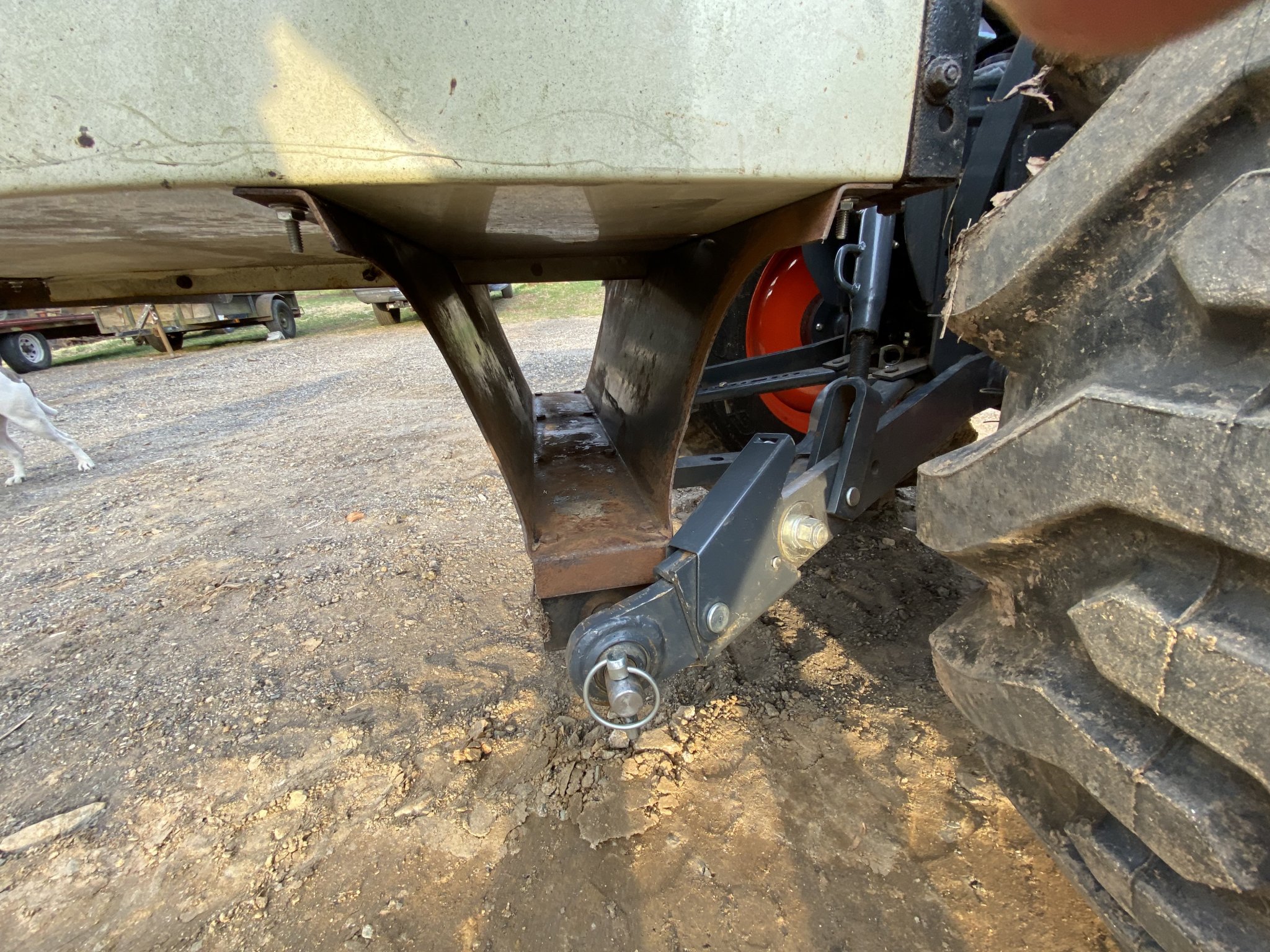

Great idea! Beware that sheet metal base can fold up and collapse if you fully load that box with something heavy like soil. I put a 2x2 steel tube sub frame and ball hitch under mine and a 1,500 lbs axel with golf cart wheels to fix it. The box is the only thing that survives from the original trailer!
34,961
10,227
Great Idea, but, Implements like this are normally designed so that they clear everything when the three point is in the full up position, by the looks of your dimensions, if you accidentally lift it your going to put it through the fenders and lights. and into the back of the seat.
some models have a manual max lift stop, I hope yours does.

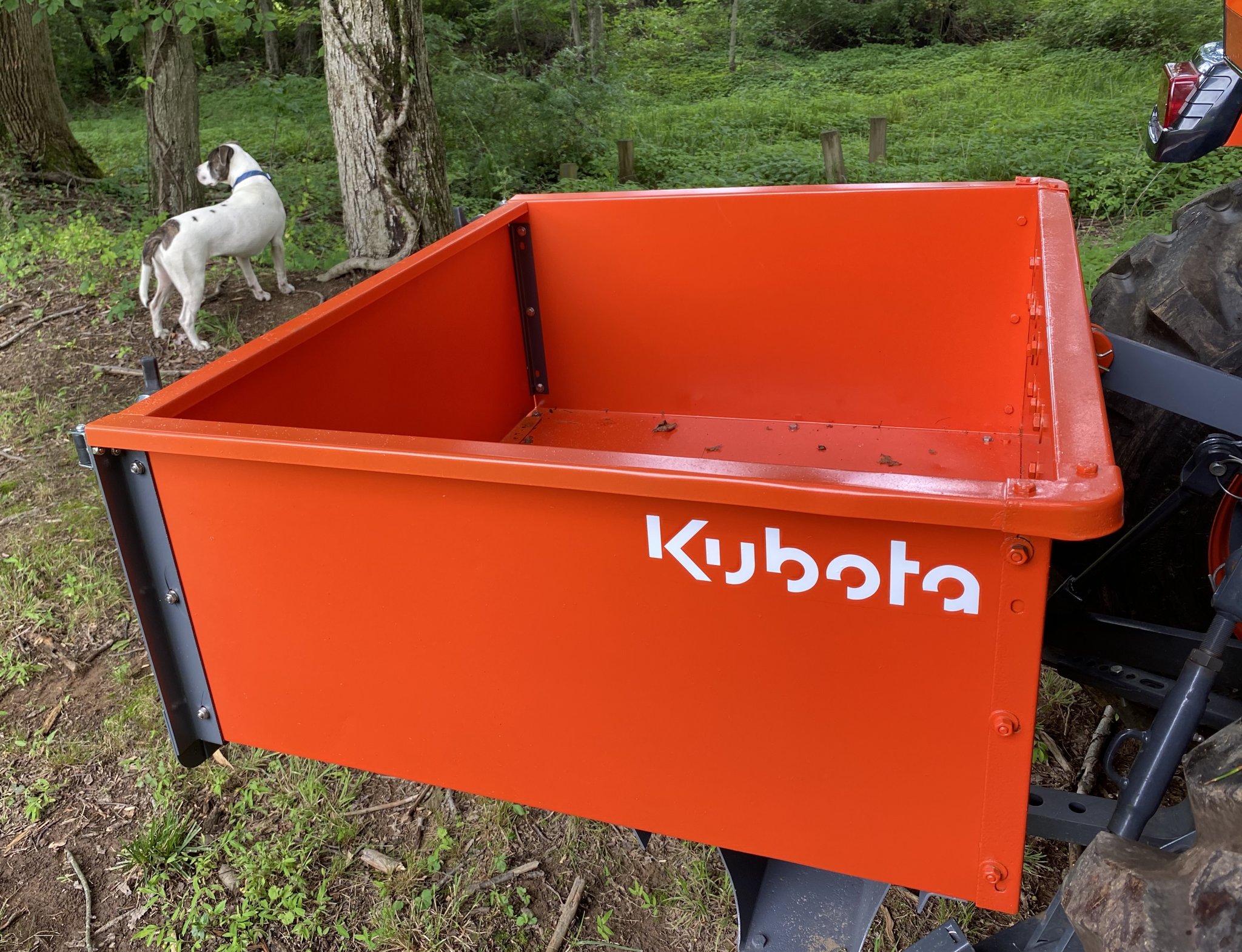

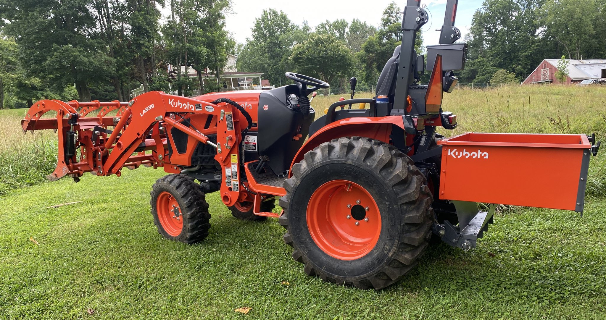

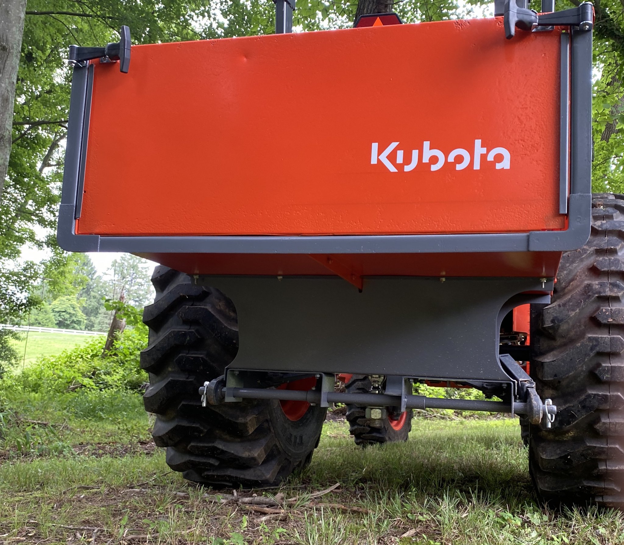

My friend got his sandblaster operational so after some delay the garden cart-pickup bed is finally painted.
For the cost of a quart of paint and a few decals I think it turned out pretty factory looking.
robj
P.S. Wolfman, Thanks for that tip. I did wire tie the lift so the handle can't be moved by accident.
P.P.S. 3 decals came in the kit so I thought what the heck.
