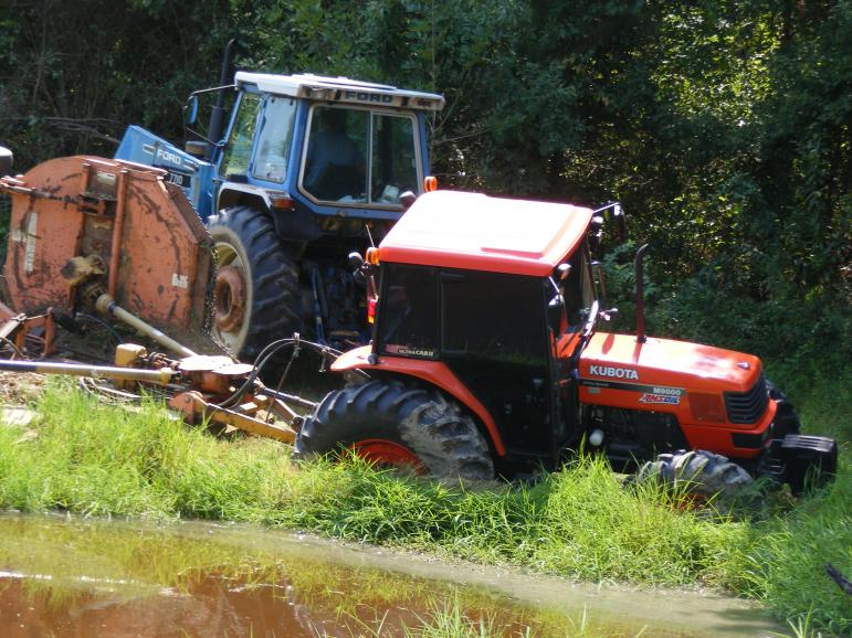

Bulldog,
It's funny, your picture looks safer than it actually is. Not only is it uneven, the ground is soft being next to water. That raise the stakes and pucker factor to an even higher level. I cut next to a pond and with my old b2920 it got a little hairy.
