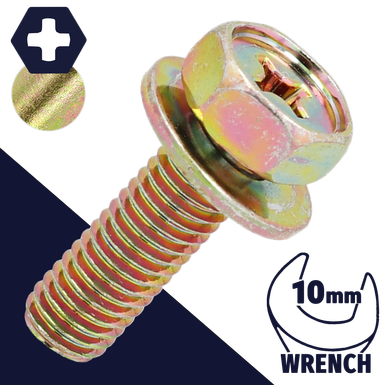

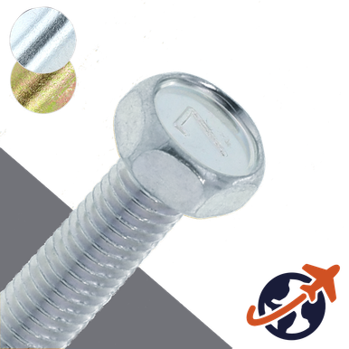

Dont over think this.
I think the original fastener is a SEMs screw made to JIS standard. I gave encoutered them in the past. It has a 10mm modified hex head with cross point (Phillips) drive in the center of the head and a caotive underhead washer. Bel Metric sells them but not in that length and they are special order.
In practice a JIS hex head bolt is nearly identical but without the Philips drive and captuve washer.
A flange head JIS bolt wont need the washer.
A metric hex bolt ftom a big box store will be a DIN standard fadtener with a 11mm head.
Thats the technical difference in the fasteners and for all practical purposes this is a tempest in a teapot. Any of those options will work fine.

1792502183303.png I think this is what i pulled out of there.. Whats throwing me off is the heads of these bolts where painted like they were installed OEM from the factory. But they are def not pan heads.

I think your getting hung up on the part name:
And yes Kubota manuals and descriptions gets the part name wrong some of the time.
Front cover bolts: 01202-50655
BOLT M6x1.0x55 mm
Rear cover bolts: 01202-50660
BOLT M6x1.0x60 mm
