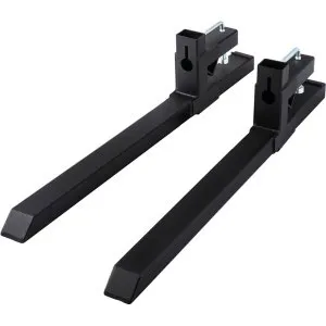

Bought a clamp on pair from VEVOR. Less than a C note, free delivery and more than adequate for my needs.

Not sure if you have them locally, but Storm 2000. Weigh 185lbs and up to 2000lbs. I debated them but realized I pretty much was going to use it to move brush so I just got some clamp ons for under $100.
