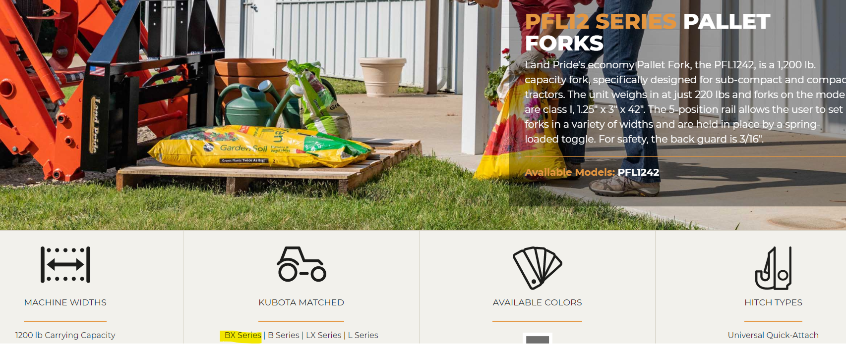

Brand new member, just purchased BX2680 with the BX2410 SSQA coupler. I am looking at purchasing the Land Pride PFL 1242 pallet fork. Now my Kubota dealer states it will not fit and a salesmen from elsewhere says it will fit. Confused. Does anyone out there use the PFL 1242 from Land Pride on a Kubota BX2680 with bx2410 quick release? Thanks for your help

Go to the land pride web site. They have filters by model category. "Kubota matched" they call it.

This would seem to imply that any SSQA would work but theirs has the benefit of being lighter (167 lbs) to allow for more of the lifting capacity to be used for what you are trying to lift.

Decided to get the Landpro PFL1242. On my way home with it. I will let you know how it fits. Many thanks to all that replied and assisted. Awesome forum!!!
