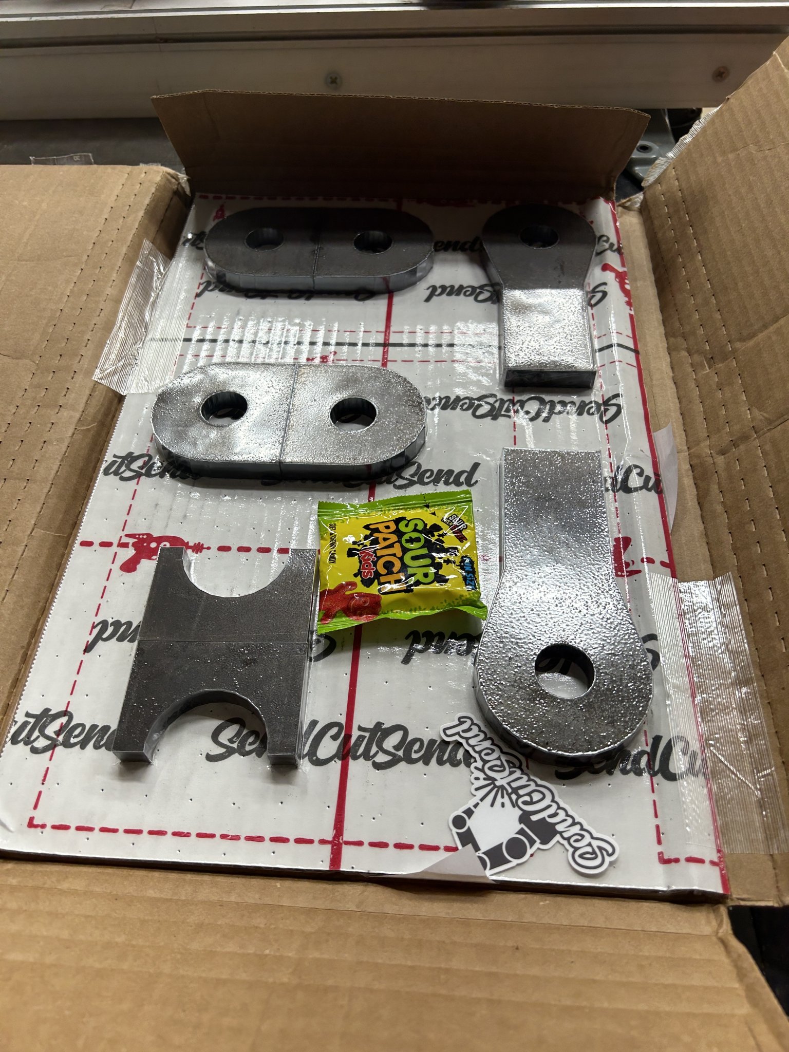

I ordered the 1/2" plate pieces with round holes from SendCutSend. The main tubes are 2x4x0.25". Installed a zerk in the forward pivot (which I machined from a piece of bar stock), so all the pivots are greasable.

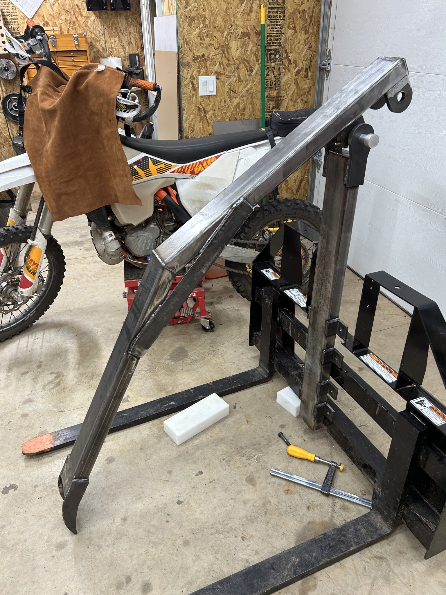

That’s awesome. If you lift the loader up and roll the forks all the way forward how does that do plucking rocks and large rounds of wood? Keep the pics coming. That seems like very functional and from pics pretty clean fab job. 👍

Parts from SendCutSend - 1/2" thick, no way I wanted to cut those myself.

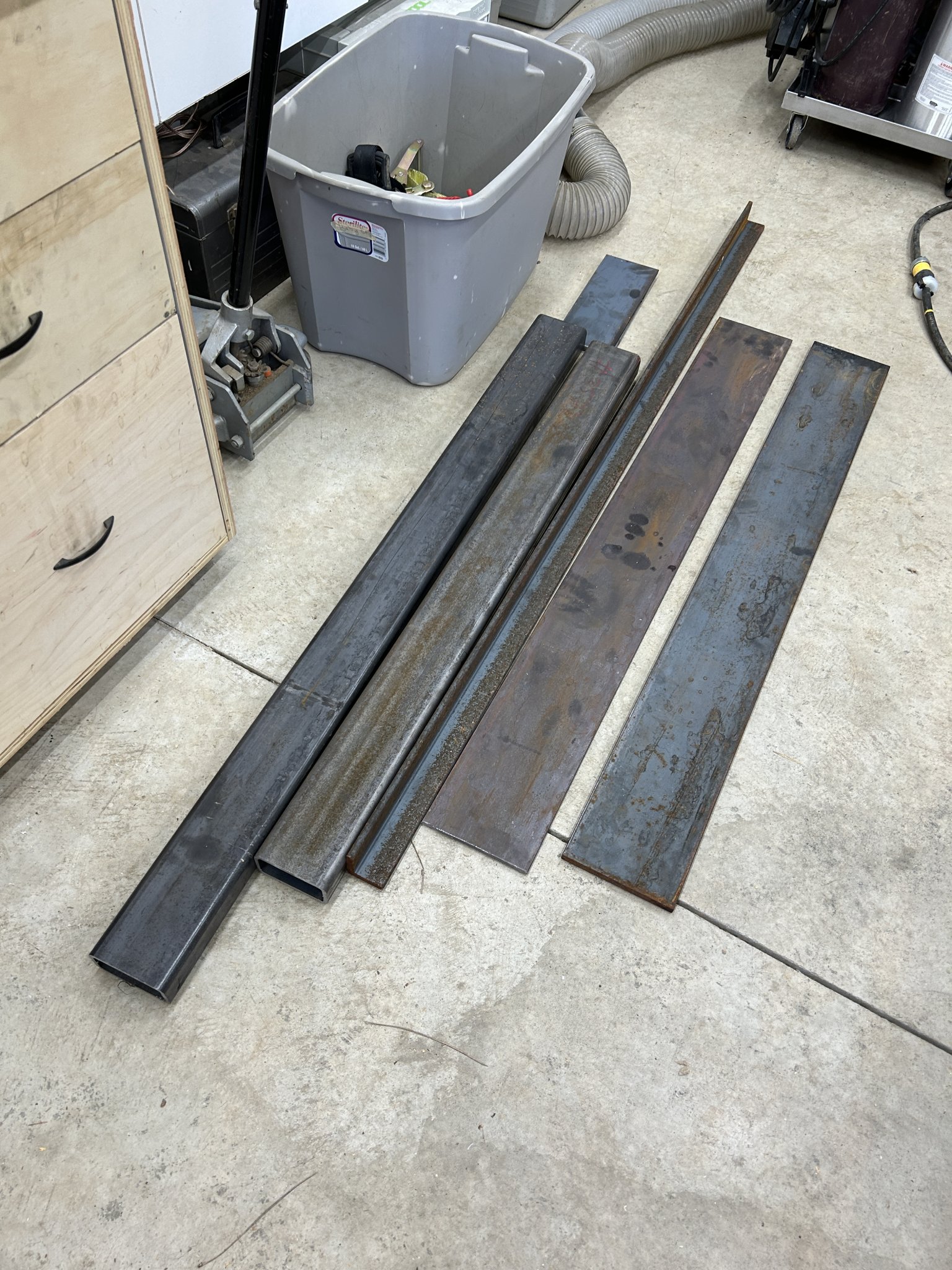

Most of the raw material, all from the drops zone at my local steel yard

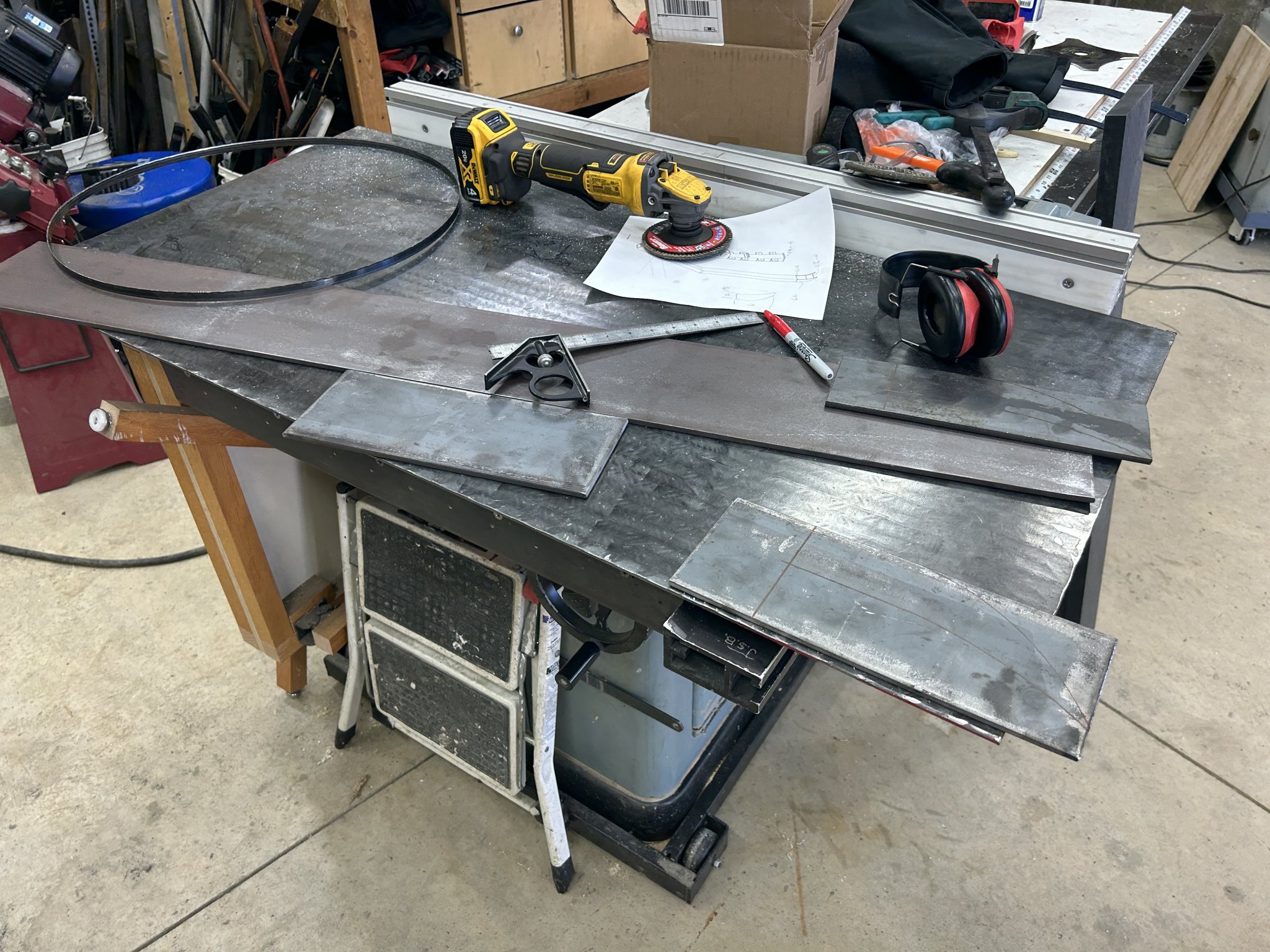

Welding table = sheet of diamond plate on my table saw

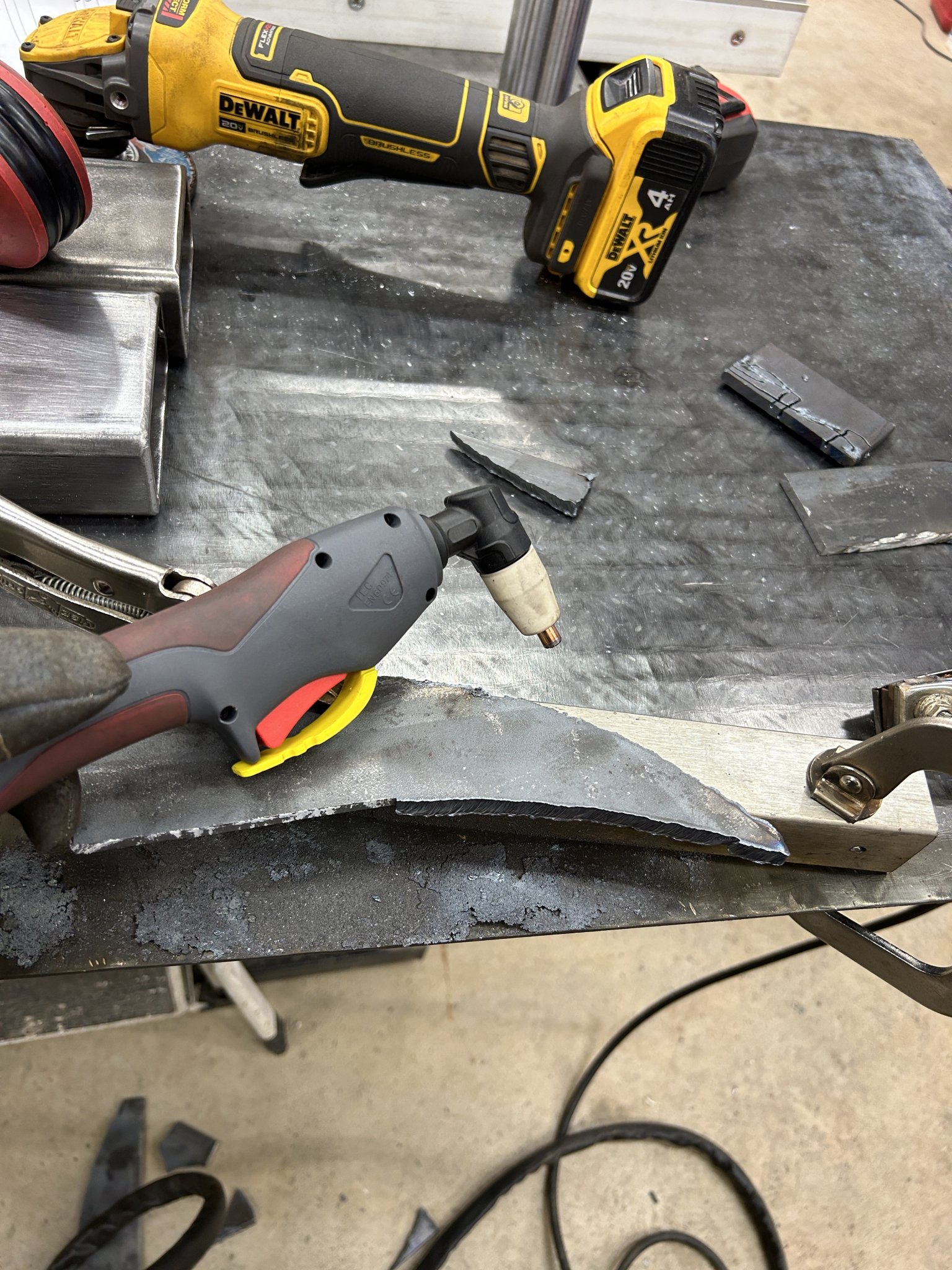

Light saber action. Someday maybe I'll learn to get cleaner cuts with this thing...

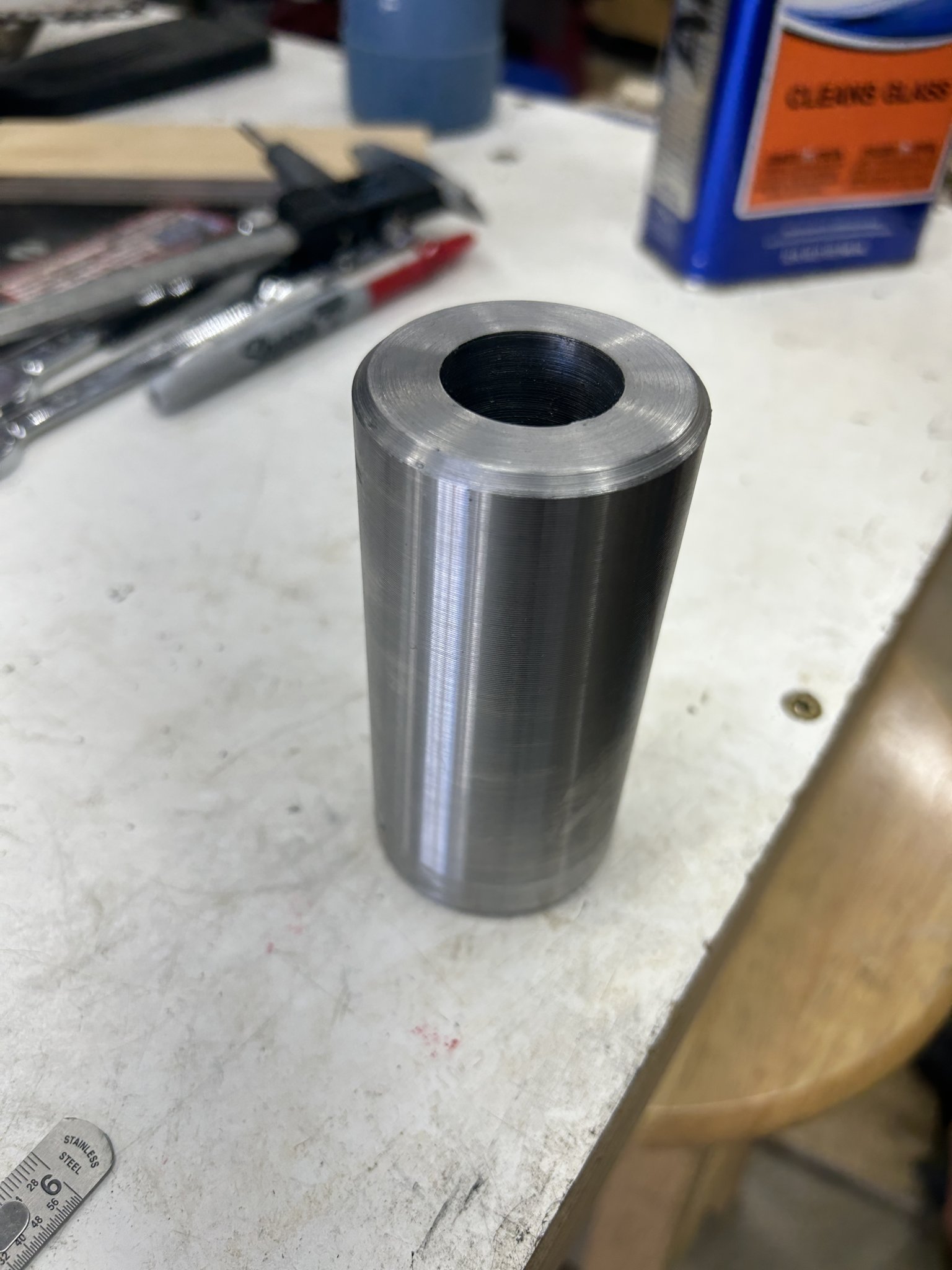

Main pivot housing I turned out of a 2" dia steel bar stock. Boring out the 1" dia hole was an exercise in patience on the lathe.
Mocking up the mounting. The tabs on the vertical tube were my original plan to mount it to the pallet fork frame, using a plate on the back side to clamp it in place. I failed to notice that the frame's horizontal beams are different thicknesses. In frustration, and not wanting to go buy longer bolts, I decided to just drill & tap two holes in the frame. Since the arm is mostly pulling against itself (unless I tried to dig with it), the forces trying to rip it off the frame stay pretty small. If I'm wrong and that attachment fails, I can go back to the original plan.
That aluminum pivot pin is just for mockup, the steel pins hadn't arrived yet.

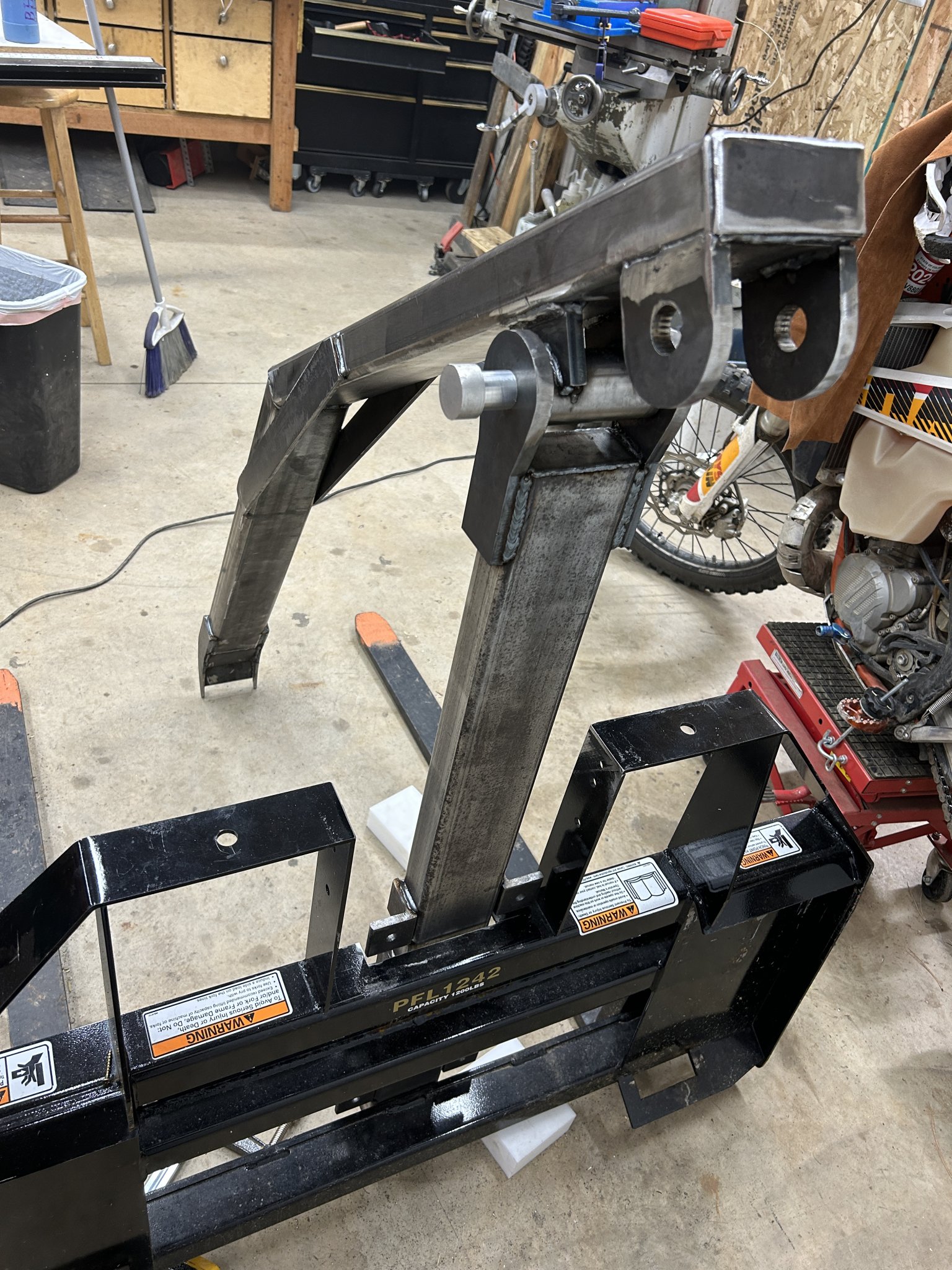

I capped off all the tubing to slow down corrosion, since it will live outside. You can see the pivot housing welded to two ear tabs attached to the arm tube. I put a zerk in that pivot housing for greasing.
A detail not shown: I made all the pivot pins non-rotating in their outer mounts so that the rotation would only happen in the close-fitting and lubricated inner sleeves (the pivot sleeve I made, plus the
ones on either end of the hydraulic cylinder).
Also not shown: thanks to a boneheaded lapse on my part, the 1" dia holes in those 1/2" thick parts were excessively faceted (polygonal) and not round. I had to buy a cheap adjustable reamer to clean those up. Couldn't use a twist drill because the material removal was too small and it just bound up rather than cut.

FWIW. drill a small hole in the arm end, squirt oil or spray rustcheck or similar, then screw in a selftapping screw. Over time , heat will drag the oil here ,there, everywhere inside the tubing.
7,134
2,567
For a smoother cut you can figure out the offset from the center of tip to a surface on the cutter (like the white part somewhere). Then you can draw your shape on paper then trace it at the offset onto plywood or something similar and then use that as a guide to follow with your plasma cutter.

Thanks. My problem is not so much the guide, it's getting consistent clean cut all the way through the material without the slag reforming on the back side. I suspect it's about getting the current + airflow + torch travel speed balanced correctly; I haven't spent much time really working on this yet.
