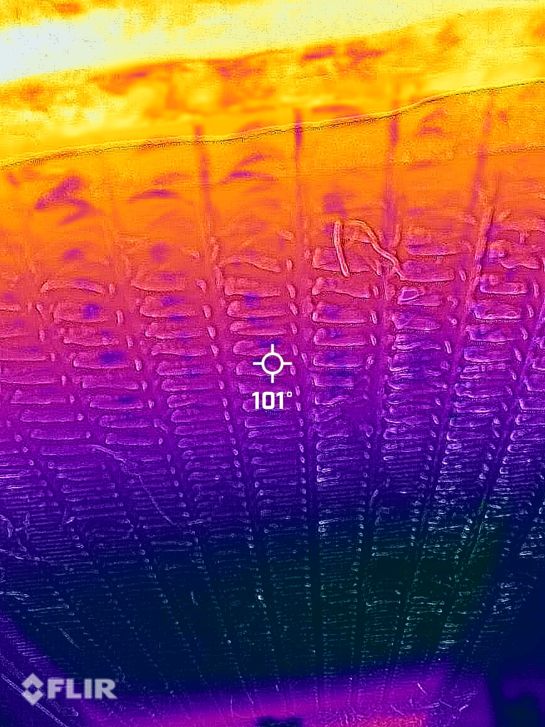

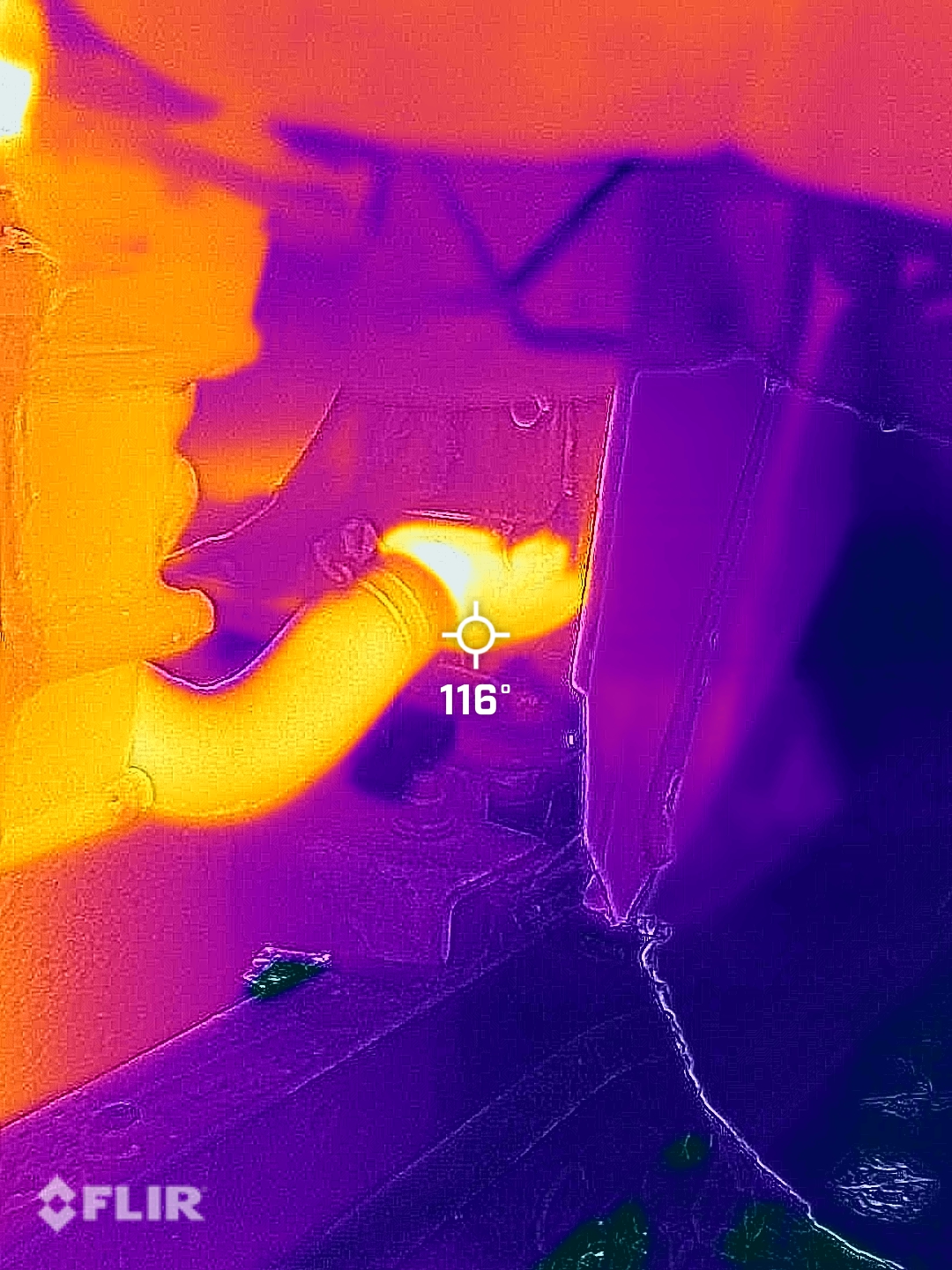

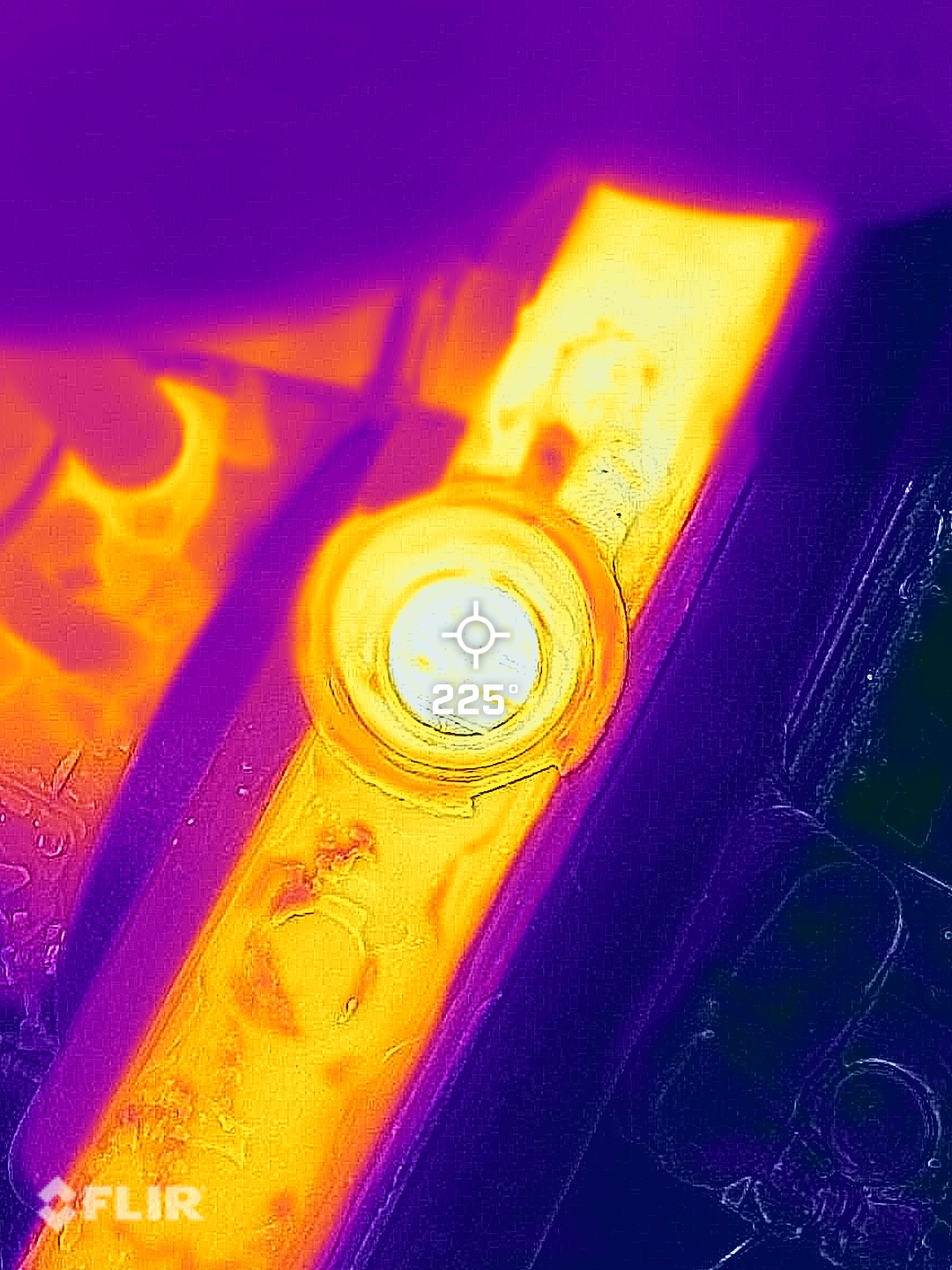

Not trying to hijack the thread but I have a similar issue. I think I tried everything except straitening the fins. I got some temperature reading right before the engine overheated. Could someone take a look to see if the numbers don't make sense? Thank you! (the pictures were taking with removed thermostat).

No or little coolant flow through the radiator. Bad water pump, plugged radiator tubes, or stuck thermostat.

Tstat is new so let's not consider it. Can I assume that water pump works based on the fact that coolant is coming through the bottom pipe? The radiator is not in the best shape but should I see the radiator tubes to be hotter than fins on the thermal image (I am thinking to bring it to a shop to rod out but don't want to spend money if it's not strictly necessary)?

Try this first. Could be a cheap solution.
