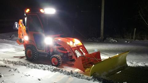

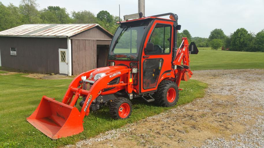

I installed two led floods for the front of my bx on the hood brushguard bracket, and one 18w led flood on the back, they work great,
