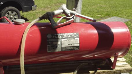

I was given a 15 Gallon Fuel Station fuel tank. It's steel with a gasoline-style pump handle. It's gravity-fed with a shutoff valve underneath.
I currently use 2 5-gal gasoline containers that I usually fill every other month or so - mainly for lawnmowers, 4-wheelers, etc. This seems like it could save some trips to the gas station.
I am, however, a little concerned about mounting this. I dont want it on the inside of my barn at all - makes me too nervous. I would mount it outside, under a covered awning and maybe just load it in the truck for trips to the gas station.
Anyone use something like this? Pros/Cons?

I've had the same one for 3-years now,
PRO: It's great for the lawn morrows and 4-Wheeler's, its just plane handy! I drilled a small hole through the cap and put a brazing rod threw it with an old brass float from a gas tank (soldered) so it will float. when the tank was empty set the rod length and bent the top at 90 deg. Now with just a glance I know how much is in it.
Now at my convenience when i'm in town, I'll just pick up 1-2 cans of gas on dump in it.
CON: The hose run's slow, with the ground wire inside the hose, theirs not much of a stream, (slow/real slow) Also, the handle on mine is so cheap, if you don't watch how you pull-it, it will come loose.
(It's in a lean-to with a ground rod and ground wire attached)
All in all I like-it, and I've become kind of dependent on it.

If you mount it on the wall, how do you plan to re-fill it?
If you put it in your truck, how will you re-locate it when you fill it up? It'll weigh about 125 lbs! I can barely manage my full German Jerry cans -6 gallons at nearly 70lbs full.
Plus, once mounted, everything you fill would have to be within hose reach.
Auto gas has a terribly short life without stabilizers. With double dose Stabil, I get 9mos out of my auto gas reserve and then burn it in my truck. Never a problem.
Storing fuel in manageable containers is the easiest solution I have found. In winter, I augment my steel storage with racing fuel containers (stout plastic) that are very unlikely to ever leak. Through the summer months, I store only the steel Gerry cans which seal tightly. Everything gets double Stabil and I use Redline Fuel System cleaner once a year, usually after using up stored fuel.
If you have someone who can help you carry this storage can, then I might consider it. But, give the limitations of trying to haul it and lift it for storage, especially elevated, and given the slow fill rate, I think I'd sell it and buy more manageable containers.
By the way... with the potential for war in the "Middle Earth" this summer, you might want to swap out and refresh those supplies while you can. Stabil will enable you to store gasoline indefinitely by re-treatment. Having some extra on hand could be very nice. You never know...
Anyone interested in starting a "disaster prep" thread?

Great info, guys. Also, good point about the grounding rod. I suspect static electricity wouldnt be too good around this thing! I think I'll find a way to mount it and see how it works.
rmasonjr
Mar 16, 2015
19
brookhaven, ms
@Ray - after mounting, I would just fill it with the 5-gal containers. This would keep me from going to the gas station so often. I thought about taking it down, filling it up at the gas station, then putting it back up - I'd use the front-end loader for that - would be way too heavy to lift by myself :)

Mines about chest high, if i fill it with a can that the spout is a problem, i just set the can on the rack of the 4-wheeler and stand on the running board, not hard at all, That's where its parked any way, Just plan out your location and you'll be glad you have another option for fuel storage.
