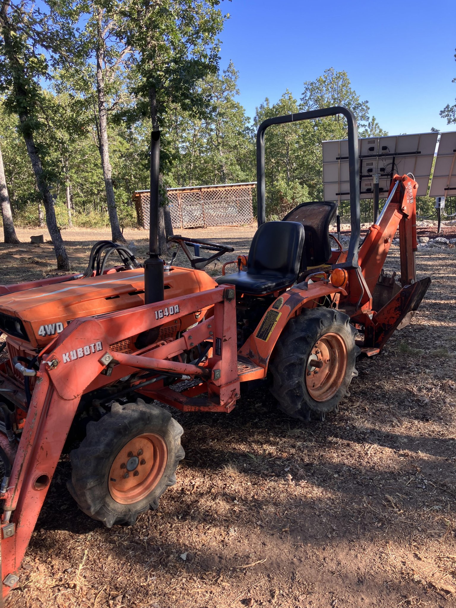

Can someone tell me what speed to run my PTO when using my backhoe as well as how many RPM's I should be running my engine on my older B5200 and 4520A backhoe? I just picked this up for $5500. Seems to run great, I think that it was a steal. Thanks in advance.
7,843
5,066
Can someone tell me what speed to run my PTO when using my backhoe as well as how many RPM's I should be running my engine on my older B5200 and 4520A backhoe? I just picked this up for $5500. Seems to run great, I think that it was a steal. Thanks in advance. View attachment 108449
From outward appearance it does appear that you stole it!

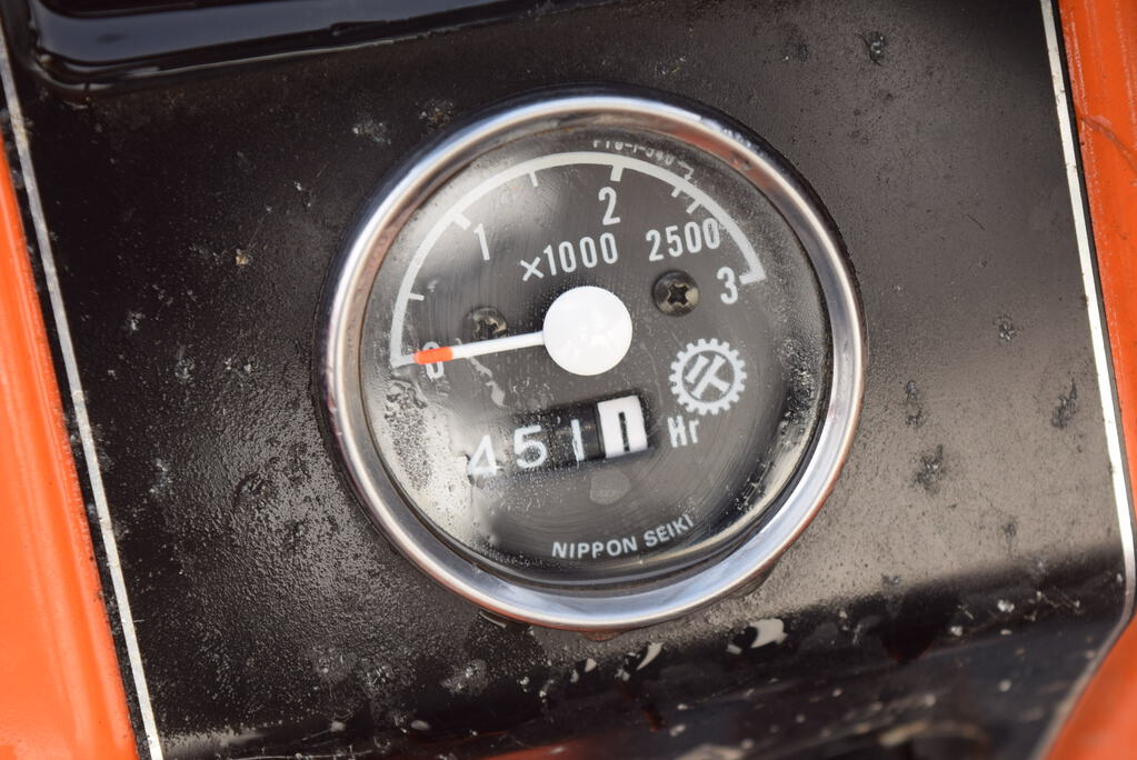

Is there an arrow or notch within the tach? Kinda like this

That is the engine speed where your low range PTO speed will be 540rpm. Usually a tractor is geared so the engine is making max HP at that speed -- great if you are blowing snow, etc. But using a PTO pump powered backhoe, there's little to no increase in digging force and a beginner will likely find the controls too touchy at that speed.
