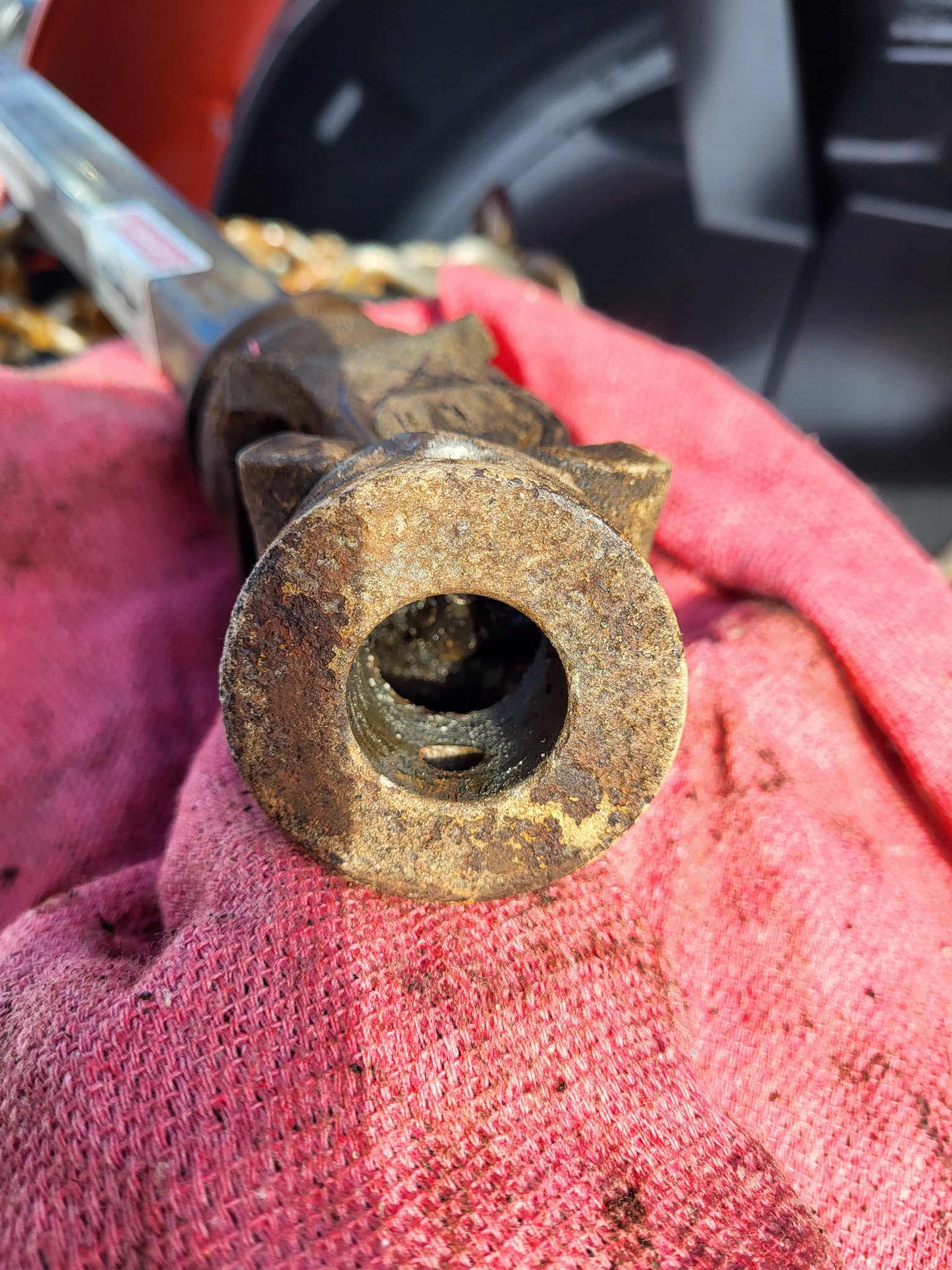

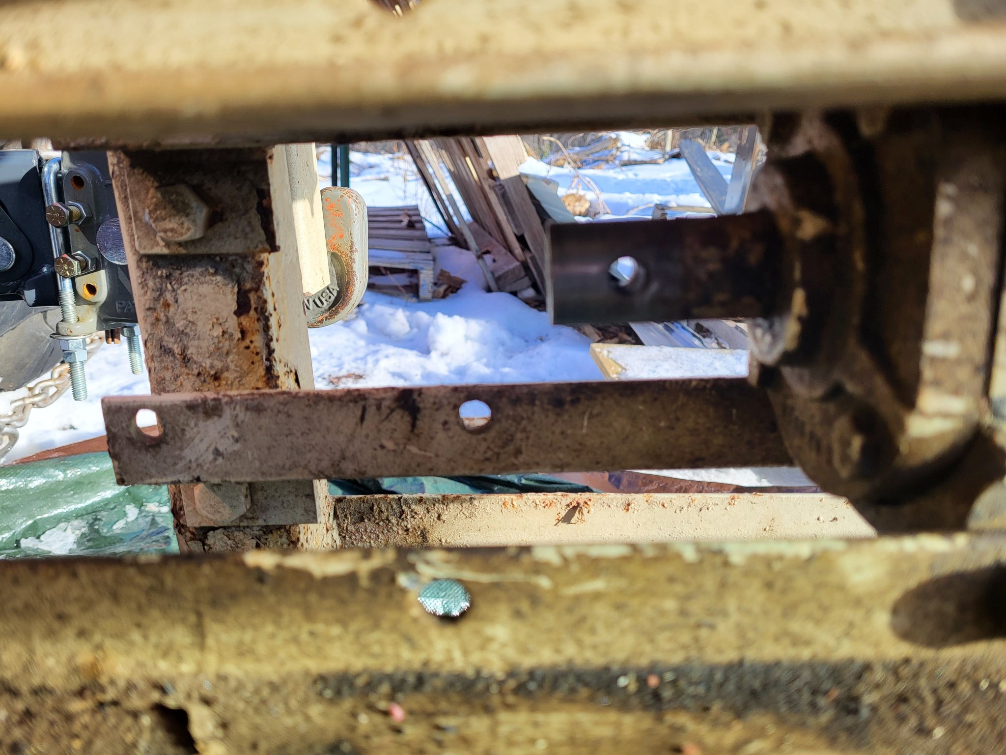

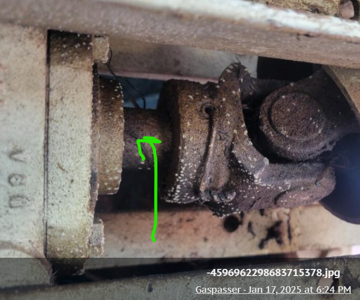

So gearbox shaft is 1 inch diameter. Tried to punch out spring pin. As you can see from Wolfman's pic with the green arrow, there was a steel wire through the hole presumably added by previous owner. Cut that loose and tried to knock out spring pin with no luck. On one side it appears to be missing. The other side I can see isn't budging with punch and hammer. Besides PB blaster, heating, and continuing to pound on it, any other tricks? Is it a sin to drill it out with the same diameter bit?
So Wolfman, the shaft is 1 inch, required PTO length is approx 34 inches. I know i may have to trim it. Does it make sense to add a 6 spline 1 3/8 male shaft to the 1 inch spreader side shaft and just use a conventional PTO shaft? That way, the PTO shaft may be able to be used (assuming correct length) on other future implements. Or is it better to stick with the original setup and bolt the PTO directly to the spreader shaft? Appreciate all the help.

yes, spring pin (roll pin) has to come out.
Don't use a 'drift', try using a bolt ! If it's a 1/4" roll pin, use a 1/4" bolt, cut the threads off and lighlty make it smaller in diameter. The 'trick' is for it to just fit inside the hole. Hold it with pliers THEN whack with hammer. A good, stout WHACK. The 'idea' is the shock will break up the rust.
if that fails, try drilling the roll pin out, again if 1/4" ,use GOOD, new 1/4" bit. Now it may 'grab' in the spiral of the rollpin, depends upon design of the pin. Pins are 'hardened' but they can be drilled.
Once out, use a few big open ended wrenches as spacers between gear box and Ujoint, insert pickle fork between last wrench and ujoint, see what a few whacks do.....helps to have trained octopus to hold the wrenches.
as always LOTS of oil, heat and patience will help !

There are tools specifically designed for removing those spring pins. They are called roll pin punch sets and are not expensive. I suggest you get a set in metric and inch sizes since you won’t be able to measure the size of the pin or hole.
And get a good penetrating oil like PB Blaster or anything similar

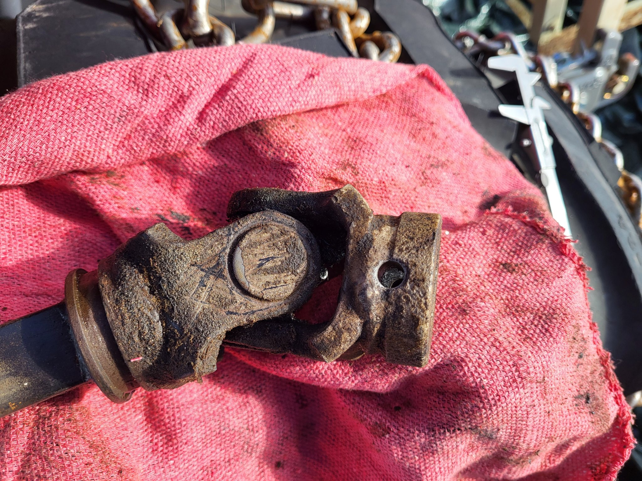

Well gang, good news. Following everyone's advice, I was able to get the roll pin out after PB Blaster, torch heating, pounding with bolts and pin punches and of course some carefully chosen words for the occasion. There was some blood shed as well. Then used Greenville's advice of using large adjustable wrenches as pickle forks. Had to heat with torch again whie pounding on the wrenches but got the
Implement end of the PTO to slide off the shaft. So now have 1 inch diameter gearbox shaft with 5/16 hole where the spring pin lives. The hole 'center is 3/4 inch from end of shaft. This hole and spring pin was the only thing holding PTO universal joint to the round shaft.There is no keyway or other means of fixation. Amazing that the spring pin endures all that torque. So Wolfmsn, to your point, the distance between end of sander shaft to end of tractor PTO shaft is 34 inches at the shortest horizontal 3 pt angle. This would be longer at lower angle as when resting on the ground.
So, if I add a 1 inch round to 6 spline 1 3/8 diameter standard male adapter to the spreader shaft, this would allow me to use a standard female to female 6 spline x 1 3/8 generic PT0 shaft. Of course, the adapter would need to be attached with only a 5/16 inch spring pin as there is no keyway on shaft. Do they make something like this?
Otherwise, I'll have to connect the spreader side of the longer PTO directly to the gear shaft as was done by manufacturer. That eliminates the possible use of the PTO shsft on other implements.

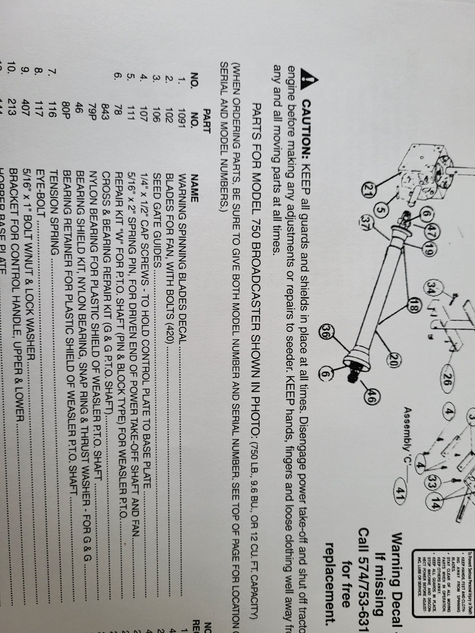

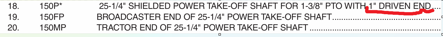

In Post #22 I listed 3 options with all the parts links:
Option #1 Will just replace that shaft completely or depending on the length, just replace the other end if it will make it long enough.
Option #2 Has the Adapter to make it a 1 3/8 6 spline and the PTO shaft of 1 3/8 6 spline to 1 3/8 6 spline
I don't think you want to go option #3 because you don't have a keyway.

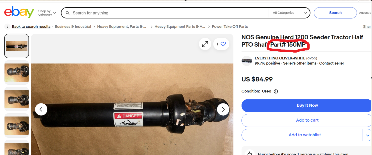

You could also buy a new PTO that was loge enough, and put your Implement Side Yoke on the new shaft to keep everything stock.
Did you determine that this would not give you enough length?

Thanks Bisquit. Unfortunatey, not long enough (like my wife says). Thank you for the reply though. Best...

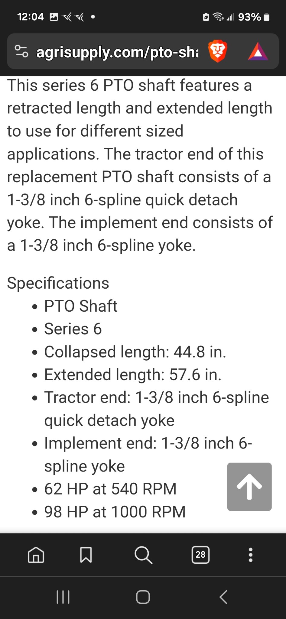

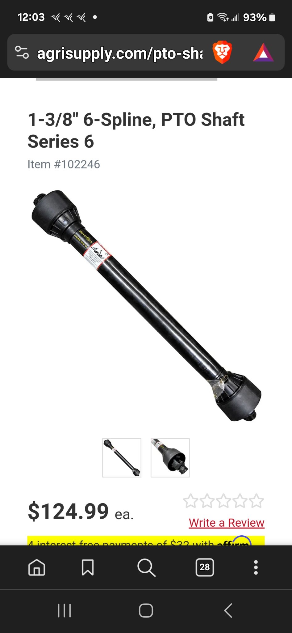

Ok, so hopefully last post to torture you guys with this subject. AgriSupply sells the adapter (1 inch round shaft to male 6 spline 1 3/8 for the implement shaft. Then will get their PTO shaft (plenty long enough; item number 102246) with female 1 3/8 6 spline on both ends. One end has retractable collar (tractor side) and the other end has a "yoke" connection (implement side). Is it safe to assume that the yoke connection bolts onto the male 1 3/8 6 spline cnnector adapter? The pics do not make it clear and their rep was unable to answer that question for me.
