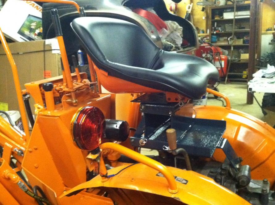

So, I ran the tractor today with the pressure gauge attached about a mile down the road and she did great, nothing less than 45-50 psi at idle and 60-65 at max! Its about time I caught a break on this thing!!!
I was able to get that broken bolt by heating and cooling it with a torch....took 2 hours but I got that @#$% out.
I fabed out some new pins for the seat, painted everthing and put the complete swivel bracket and new seat on; and I dont mind saying she looks great!
Now I found that several of my freeze plugs are leaking......&@%*$*&#$!!!!
Have a new set on its way and will replace them all.....
Here are a few pics as she sits today...:D
7,760
2,931
Glenn, it looks great! I wish mine was that pretty! Love the new seat, tires, & paint! I have my backhoe all done & have the tractor here at the house, but a neighbor wants me to do some box blade work on Tuesday, so I'll have to wait till later in the week to mount the hoe.
Is that your only bucket, and are there removable teeth on it? It looks like just the stubs.... no teeth caps.....
Looks like a great shop/garage, too. Whats the car in the background?

Hi Bill, thanks for compliment. As you are well aware, it's a lot of work.
As for the bucket, I really haven't tried to see if they are teeth or the teeth anchors. I really wish I could find a narrower bucket, say 10-12 inches; basically a trenching bucket.
