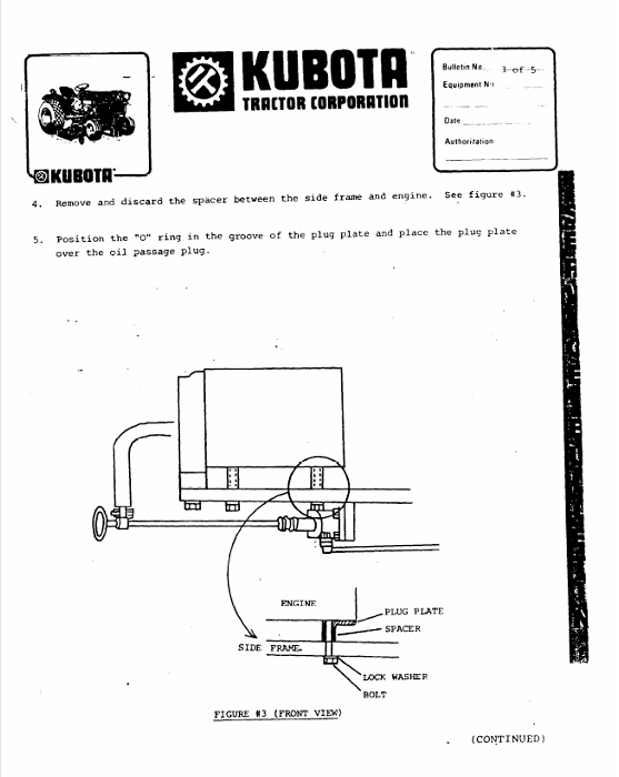

I believe 40 plus years ago there was a service bulletin from Kubota put out about this plug blowing out. I will look and see if I have the updated part that bolted on to hold the plug in. The other option is to tap the block out and just thread a pipe plug in. Your tractor must be one of the early serial numbers.

It was PSB-1981-006:
