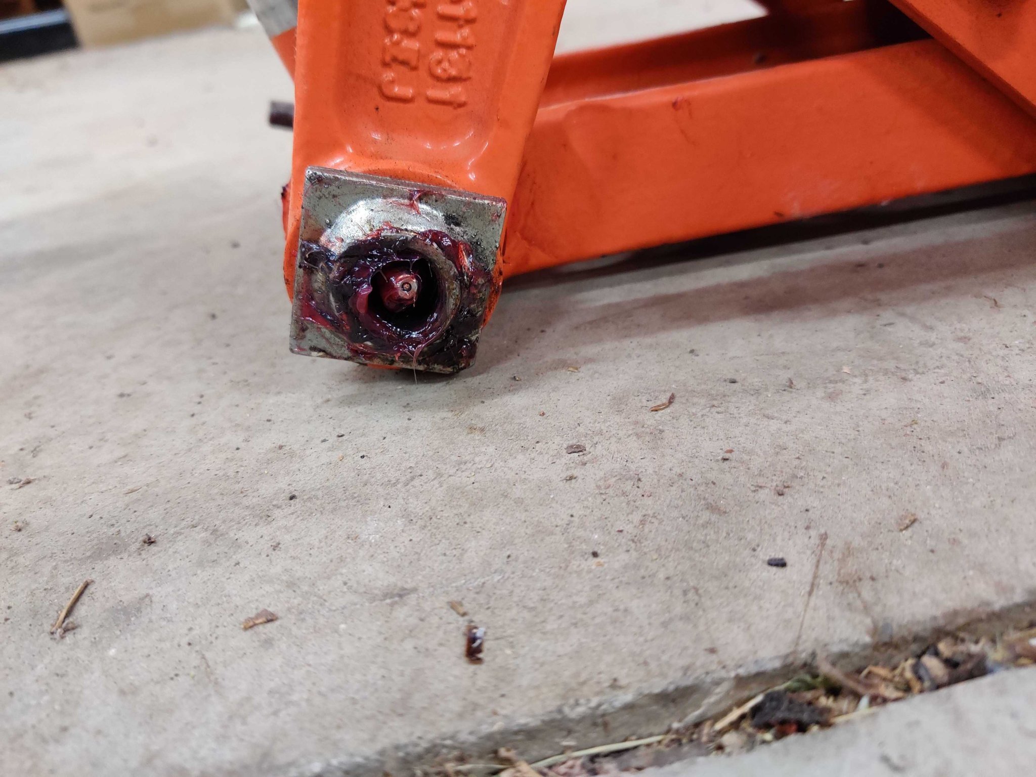

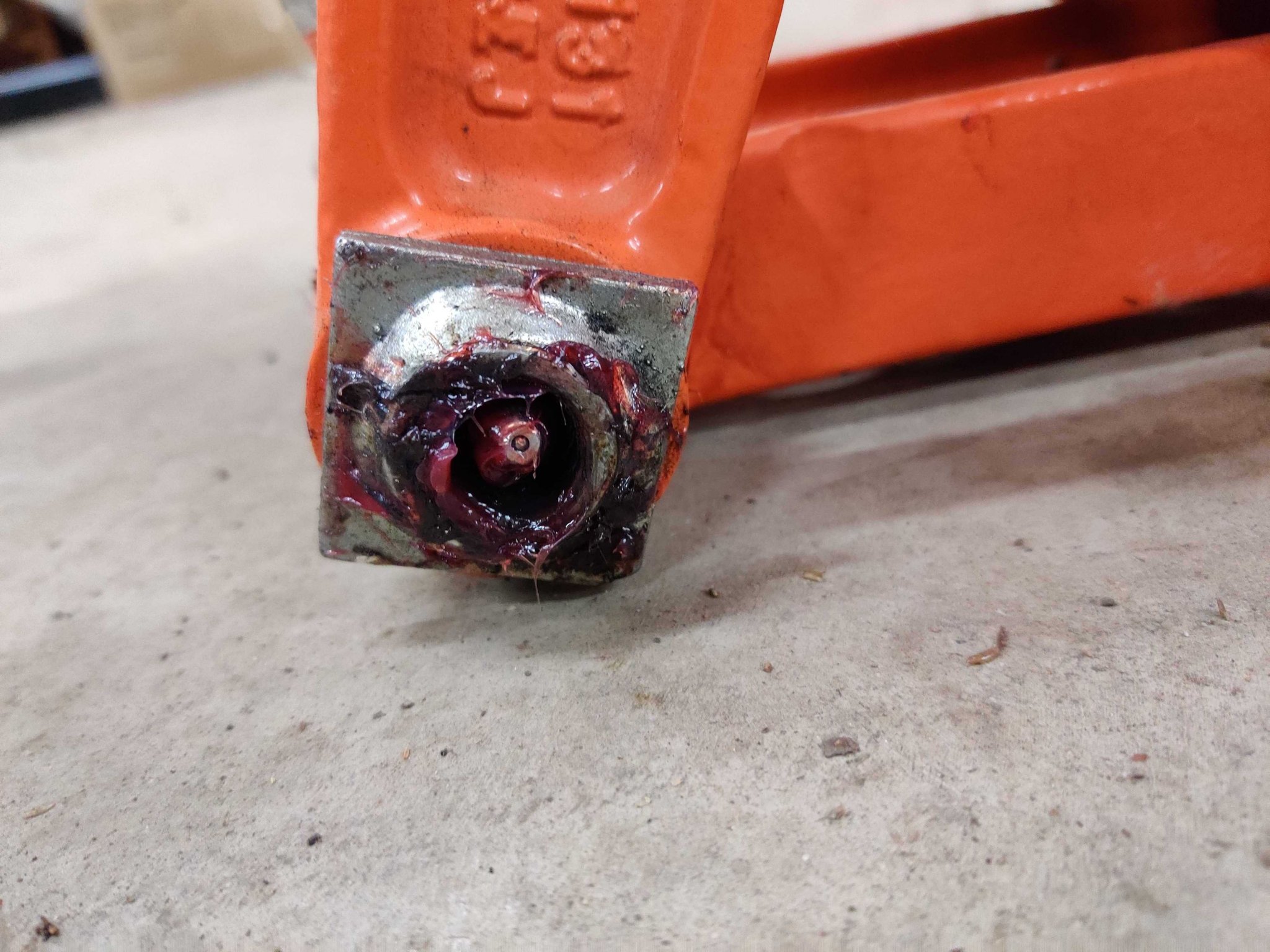

Hi,
I was greasing my tractor (BX23S) and discovered that once of the zerks is "off-center" and I can't get the grease gun to connect to it. This is the 2nd time that I've greased the tractor and I'm pretty sure that I greased this one last time, but I have a new grease gun now.
I have some pictures and I'm looking for suggestions. Should I somehow repair/replace it? Should I get an extension which might be narrower? ???
Thanks in advance for any suggestions!
Jeff

I agree. It's probably bent or cross threaded. Get a new fitting and hopefully the threads aren't ruined and it will go in straight.

Thanks - I'll try that. I had unscrewed it and pulled it out and it looked OK to me, but I'm still a novice.....

Look at the hole, if it is off center or tapped crooked, replace the pin.
AND if new, get the dealer to supply the replacement pin.

First things FIRST. Pull the pin, examine to see if the zerk-hole is “centered” and if you can simply replace the zerk with another that is not “bent” or cross-threaded.
Zerks can be SAE or Metric. Many Kubota accessories (front end loader or backhoe etc) are made in the U.S. and have SAE parts. Some items are made elsewhere …or have Metric for various reasons. You’ll have to determine THESE THings before you jump to calling in a dealer for “warranty” work on a pin.

I'd be amazed if the hole were off center. And those fittings are recessed to prevent getting broken.

Update. I pulled the zerk and it looked fine to me (see picture). The hole in the pin also looked fine to me. I suspect that the previous owner somehow cross threaded the zerk. With a little bit of strong love I was able to screw the zerk back in centered :). All is good for now and I have some ideas about what to do if this eventually fails.
I like the idea of a "placeholder" pin to keep things from shifting when replacing the pin - I was thinking the same thing - it's nice to know that I wasn't crazy :)
Thanks to EVERYONE for the thoughtful/helpful suggestions.
