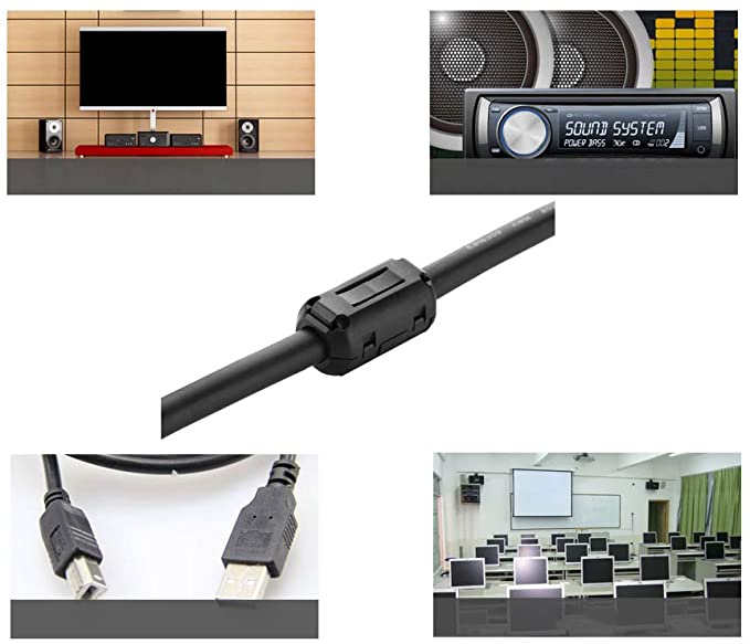

I replaced the front overhead lights with a cheep set of LED's and I put a cheep LED on both sides of the cab for snow blowing at night. The cheep ones light up the area great but as soon as I turn them on I lose my radio reception. I have researched a lot and have tried a few different things but still no radio with lights on. I am told the more expensive LED's don't run on the same RF frequency as the radio's do. I can bluetooth music to my radio when running at night so I can live with it.
Hi
I ended up installing some clip on Ferrite rings cores --- I clip them on the lead as close to the LEd bulbs as possible -- I installed 2 ferrite per lead and fixed my reception problem -- Radio is back
Purchase them on Amazon
