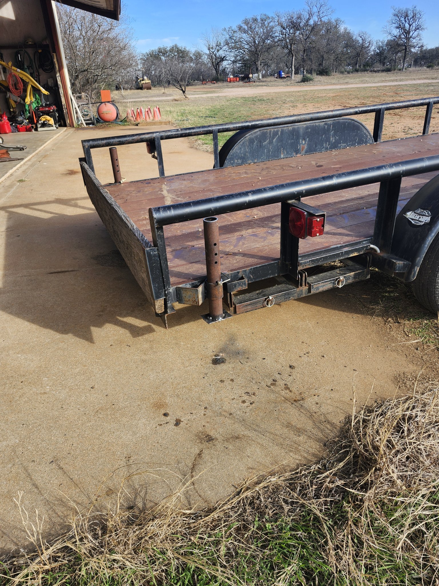

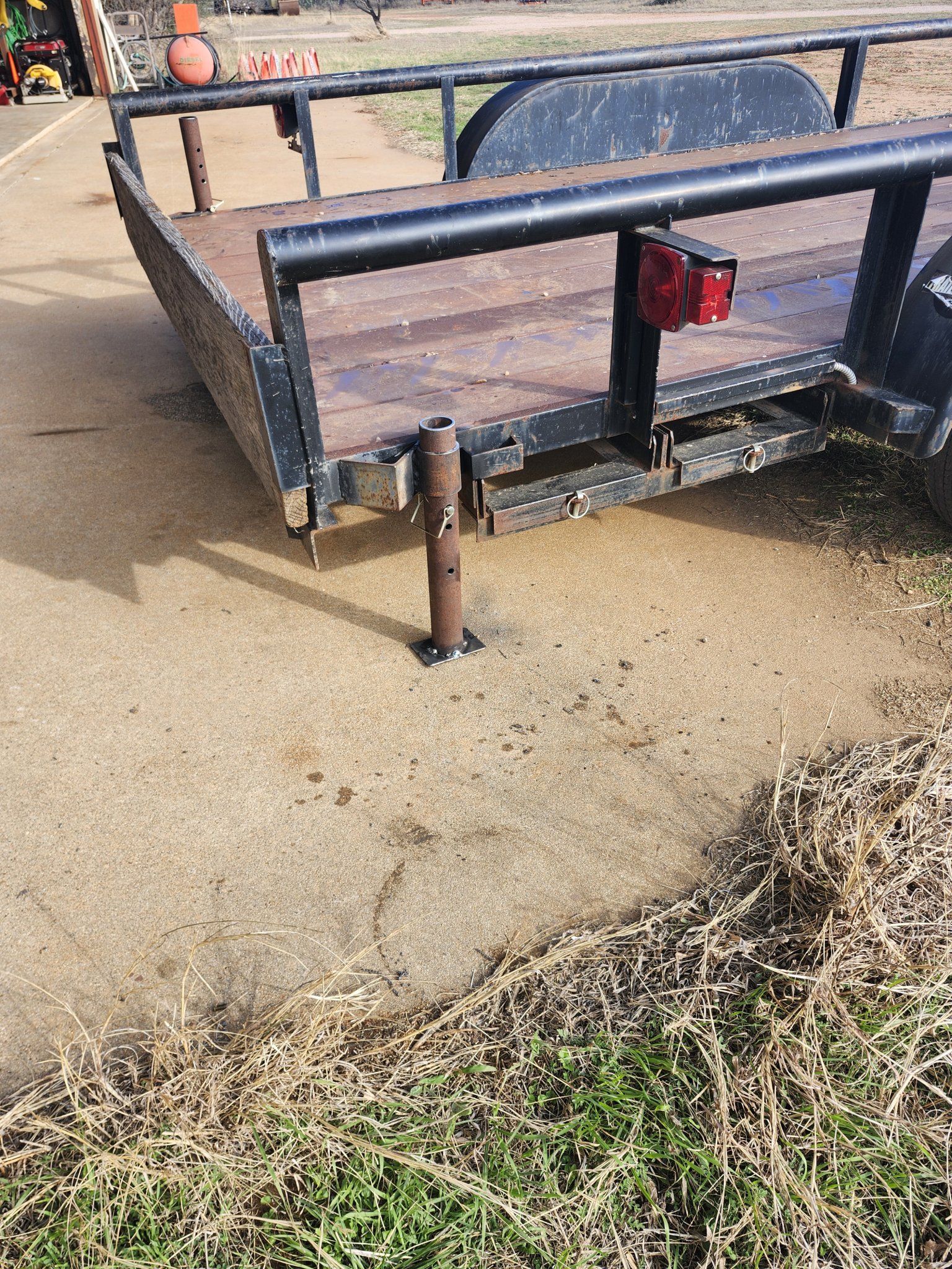

@ GrumpyFarmer : Thanks. I think I know what you mean with the flip-down ramps …the types which already have-attached supports beneath them when deployed…. But you are correct, they only work on level-ground…. no slopes are extreme angles.
This afternoon I grabbed some old pipes I had and welded up and drilled some supports for the rear of my trailer.
View attachment 169882 View attachment 169883
I appreciate a man that has a "GO" button! Get 'er done. :)

Glad everything worked out for you!
One thing I will mention about those “rear jack stands” is that you need to account for the “squattting” of the trailer when you set them up.
If not, when you load the trailer, you can’t get them out, or remove the pins, cause they are trapped underneath it.
Ask me how I know this…... ;)
I don’t want to "derail this thread" by listing all the stupid things I have done though…….Carry On👏:p

BTW, speaking of ad hoc trailer ”improvements”…. the pics I posted earlier also show the trailer-bed I made out of 8” C-purlins when the oem wood planks rotted.
I’ve done this to 3 of my trailers now with no regrets.

I picked up my tractor from the dealer yesterday PM.
The telescoping pipe-supports added to the trailer work fine.
I used 4WD and park-brake on truck while loading. No issues.
And don't ask me either!!
I’ve trapped the rear blocking on my equipment trailer enough times I now include a bottle jack in standard rigging for my equipment trailer. A little nudge from the jack is a lot quicker than unloading and reloading.
