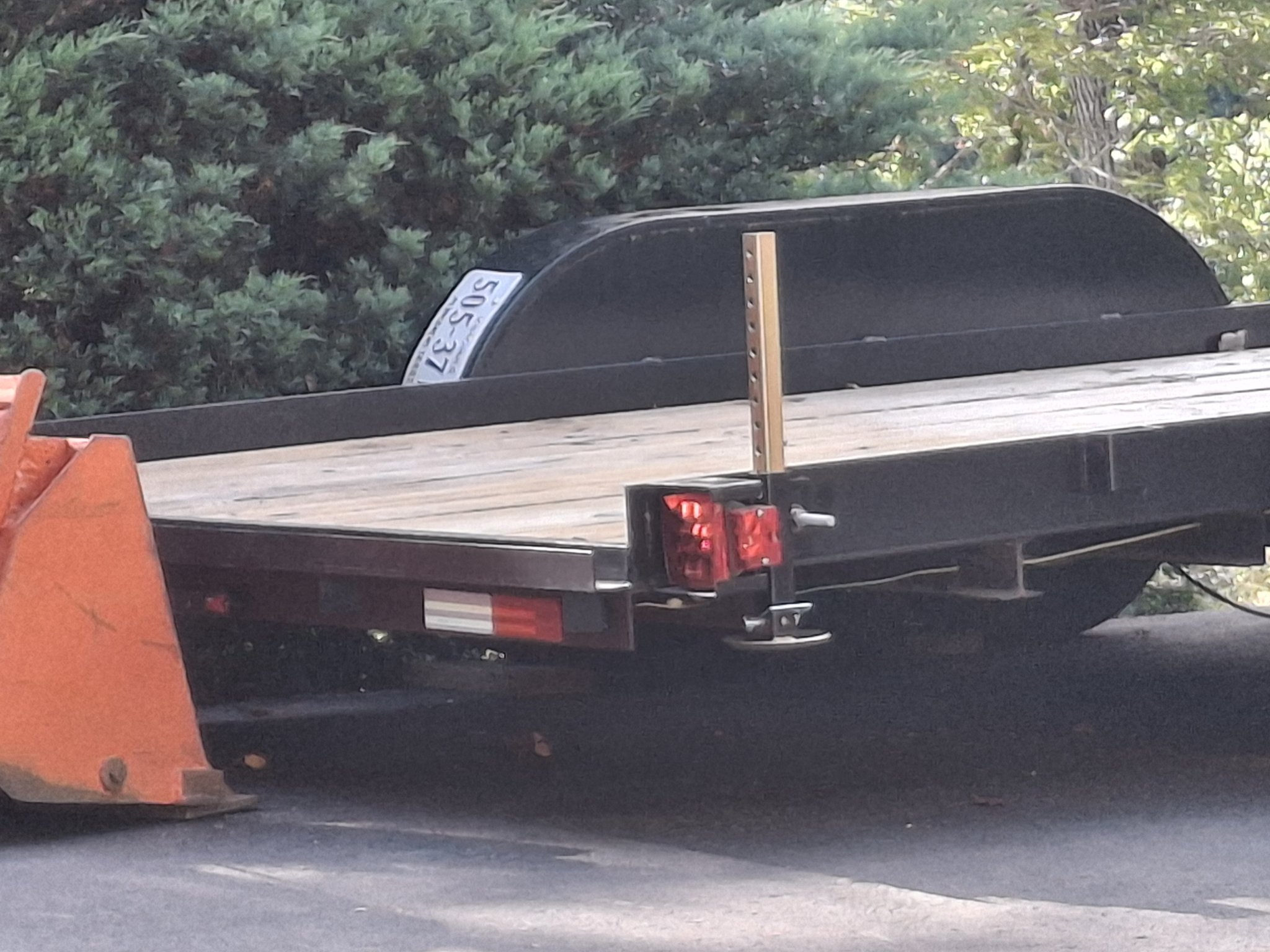

I got these from etrailer for less than I could have sourced steel and built them. I welded them to back of my 7x16 for the exact purpose you are looking for.

Thanks! That’s good info. I have been building gates this last week and have plenty of “drops” from the 2-3/8” and 3” pipe to make them.… but that’s the type I’m making.
(2-3/8” pipe telescopes within 3’ pipe very nicely)
Here’s a direct link to the product you posted, in case anyone is curious: https://www.etrailer.com/Camper-Jacks/etrailer/SJ-R208.html

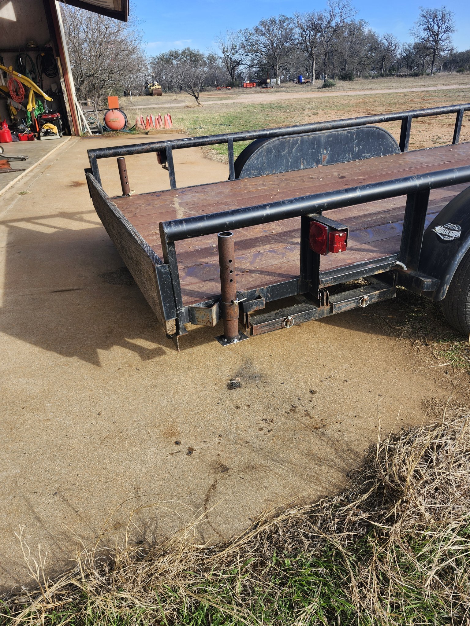

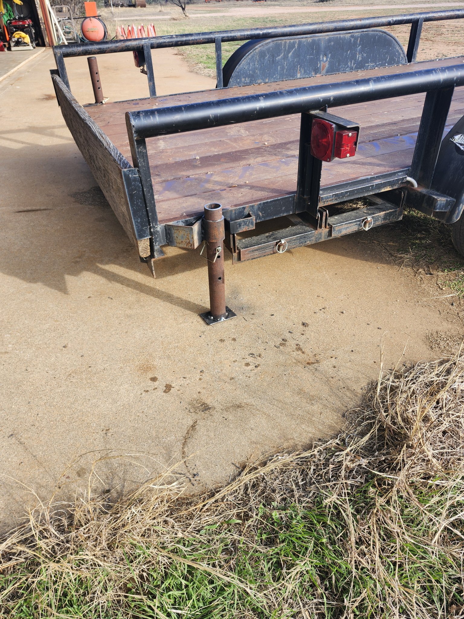

This afternoon I grabbed some old pipes I had and welded up and drilled some supports for the rear of my trailer.
