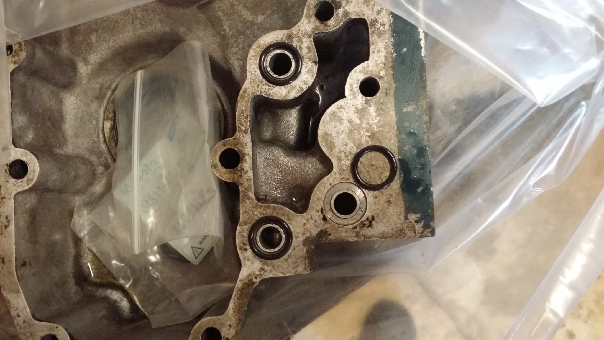

Added photo to try and explain where the to show the gap on th inner seat. The oring sits firm in the outer ring and there is enough relief when compressed against the block face to seat on to the inner ring when its bolted up.
It is a square cut seat and I can only think it is designed to do this unless the oring was much thicker. Overlook the dirty gear case, I was only seeing if the orings will fit before final cleaning

Thanks for your post. I am convinced these are the correct size O-rings

Okay on the fit on the OD, I assumed you were stretching them over the ID.
I would not have a problem using those. You might want to see if putting thick grease in the groove helps with holding the oring in place during assembly.
I never trust those blind assemblies like that! They are just a leap of faith to assemble.

Thanks Russell after they have been seated in for a while they seem to be firm so I wont need to put anything on them. The recess they are in are a right angle cut circle. I panicked at first because they didnt seem to want to fit in. Because its square cut they wont want to pop out. Now I would be able to turn the gear case upside down and they would stay in. I will just be very careful putting the case back on the block that I dont jar it and it slides on smoothly. Thanks for your advice
