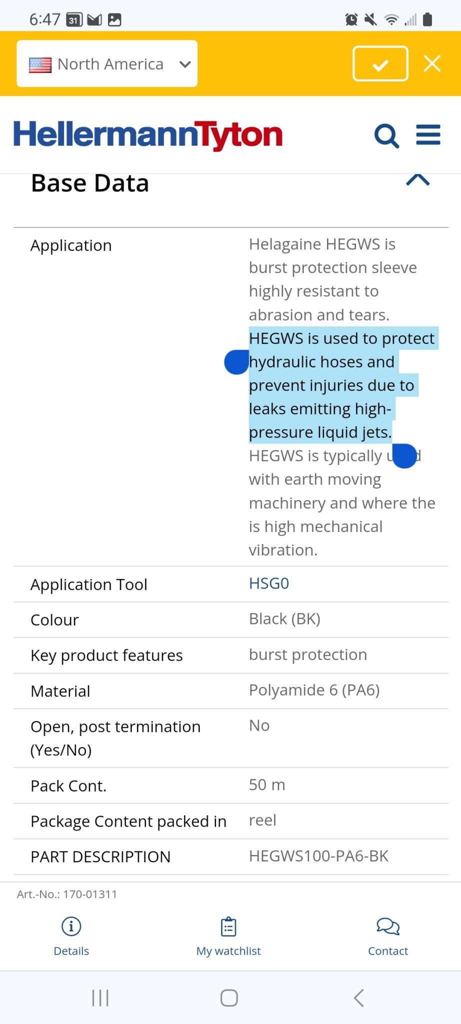

My understanding is that the sleeves are to protect from highly pressurized oil spray. Not necessarily to protect the hoses.

This was my #1 understanding as well. Had a line blow on a zero turn and this helped control the high pressure release. Seen it
5,227
3,869
This is correct. High-pressure hydraulic oil will penetrate the skin and cause tissue damage that is extremely difficult and sometimes impossible to treat. That is why manufacturers are now wrapping hoses with protective sleeves to eliminate the risk to the user. It is for this very reason that when I see a rubber coating on a hydraulic hose starting to crack I replace it with new. Failure to do so would put my life in jeopardy if it were to break and spray me with hot hydraulic oil. As you get older the more conscious you become of possible danger that could end your life prematurely.

Thats not how the manufacturers descrIbe it. Its primary purpose is abrasion protection, UV protection, and hose, wire, cable management. Burst protection seems to be an afterthought.
A typical OEM sell sheet:
Standard Sleeve Features and Benefits:
  • Protects against physical abrasion, damage and deterioration
  • Meets ISO 6945 abrasion standards
  • Provides limits burst and containment protection
  • Extremely durable and flexible Nylon
  • Guaranteed to fit your specific application
  • Multiple round ID width available
Protective Sleeving Product Highlights:
  • Solution Dyed Nylon
  • MSHA IC 171/1
  • UV Protected
  • Colors: black
  • Inside Width: 1.00" - 9,125"
  • Sizes Measured in Round ID: 0.71" - 5.76"
  • Rolled / Printed
Applications:
  1. Protects hose from abrasion and degradation
  2. Offers limited protection from the effects of hose bursting and pinhole occurrences
  3. Allows bundling of hose, cable, rope, chain, wire, etc.
  • MSHA IC 171/1
  • UV Protected
  • Colors: black
  • Rolled / Printed
Applications:
Learn something every day.
There are some that do, and some that don't protect against injury from oil spray.
7,012
3,393
I thought we were talking about the flimsy NPS everybody uses on these little Harry Homeowner tractors not high dollar hose armor for excavators. Two very different markets and products.
The Evil Twin
L2501, LA526,
Jul 19, 2022
2,400
2,321
And I thought both products protected against injury to the operator.
I don't know what the OP wants. I do know that I wish I had known the differences in the sleeve material and what each specifically was intended for. Its not much to go with one that protects from ruptures. At only $0.30 more per foot, I would have gone with the burst rated sleeve on the grapple.
