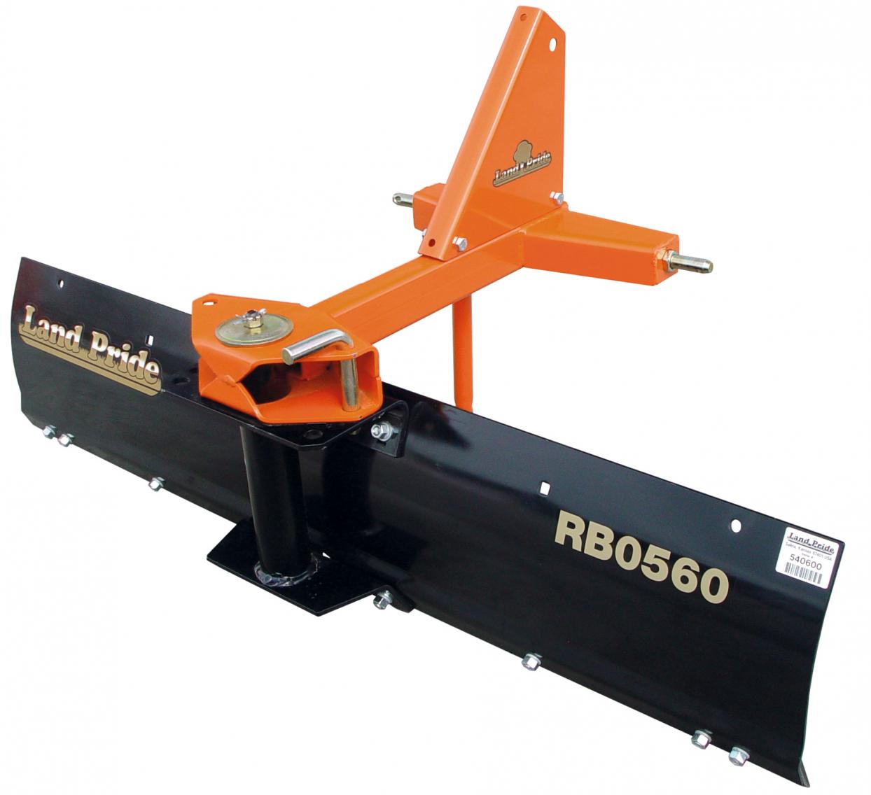

Mine would not rotate 360 degrees the way it came from Land Pride, and it still doesn't after modification. The ONLY way my blade would ever rotate properly when mounted on a BX is cut the blade width down.
Very common to have a blade that will not spin 360* when hitched up.
But your blade even when not hitched up would not spin 360* when first purchased??? :confused:

Yes, those are 5/8" plate cut out and welded in place. It does not affect the OEM mounts which are designed to work for cat 2 & 3 hitches. :cool:
No, it will spin just fine if you unhook it from the tractor. My point was that despite being offered in Kubota orange and sized for the BX series, it is quite obvious that nobody at Land Pride EVER actually hitched one up to a BX to see how it did. I find that rather apalling. :mad:
Will your blade spin around "off the tractor" now that you have added your additions?
As far as not lifting high enough when purchased new, this is a common problem with pretty much most of the rear blades and landscape rakes I think.

Mountain View pointed out there might be hazards to making a downward extension. Here is a picture to illustrate the problems someone might or might not have if they bought a Woods blade for one of these tractors. I lucked out because I bought a 6 foot blade, mostly because that was as big as I thought I needed or wanted to trip over when stored in the barn. It is the shortest in this series which, as near as I can tell, all have the same support beam etc. Mine has 20 inches of clearance to the tire which includes the 4.5 horizontal inches that the Quick Hitch adds. It swivels, although easily is not the word I'd use to describe horsing it around. So if you bought the 8 foot blade w/o the Quick Hitch it would still swivel with about 3 inches clearance to the tire. But if you had to make an extension as Mtn View and Diesel Bob have done to get better lift height, (the pink sketch) a blade longer than 6 feet might lose its ability to swivel 360 degrees.
I am not impressed with the precision construction etc on this blade. In the blade reversed position the two drop in pins wouldn't. One did eventually with persuasion by hammer, the other one is sitting there loose. Same difficulty with lining up the pin for the jack stand. A little re-engineering needed with a drill bit size I don't currently have :mad::mad::mad:
