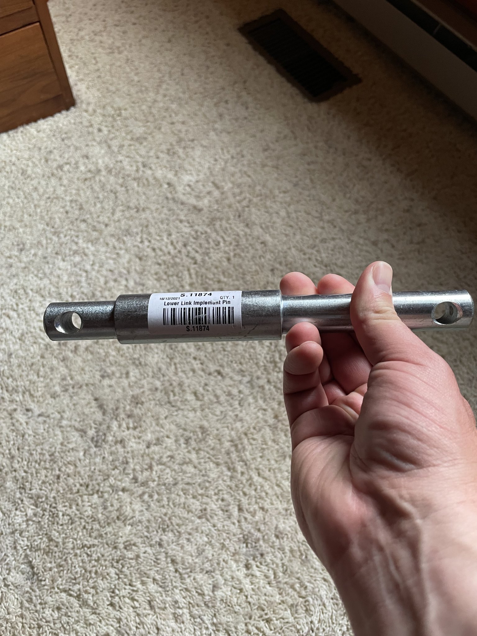

Do you have a picture of what you mean? I have LP imolements that are cat1 and cat2 and they have a stepped/shouldered pin that serves both cat 1 and 2 and it is simply slid into the implement frame holes then has a lynch pin to hold in place….the pins I have are at least 9” long though and meant as you can use either cat 1 or 2 at same time. See the pic…it’s not the OEM part from LP (which are available at your dealer) but it is similar…is that what you mean? My EA attachments (check the link for the GB60 and look at the pin) came with pins that I think you are describing but for only cat 1 and half the length of what’s in the pic with a the shoulder or step. (Should be able to do on line search and find something at agco or eBay or ag implement parts supplier that has pins. )

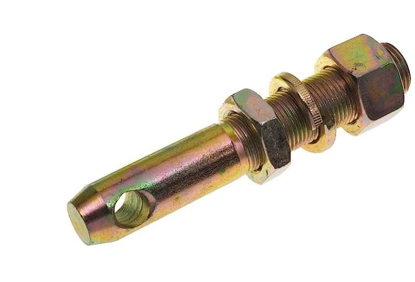

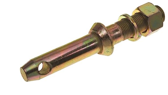

The two types of draw pins I have and what I'm finding everywhere are:

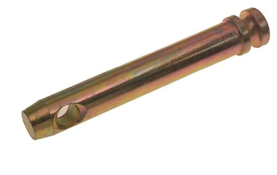

I want something like a top link (but with draw pin diameter of 7/8):
Yeah, similar concept, just without the step-down for different categories.

0K, now I'm really confused... that bolt-on pin mounts on an implement so you can attach to a 3PH. A 'bolt-less' version is just a section of 7/8" steel rod with a 3/16" hole for the lynch pin to go through, that gets welded to the implement frame.
what are you trying to connect ? Maybe post a picture of what you're trying to connect to ?

The pin in the video is just a typical top link/hitch pin. They need a support on both sides of the piece they are goung through. You can buy them in various iengths and TSC usually has a good selection.

Now that I saw the video... you could use that 'bolt-on' version . Simply run the nuts to the end and 'lock nut' them. They become the 'head',slide in, use lynch pin to secure.
