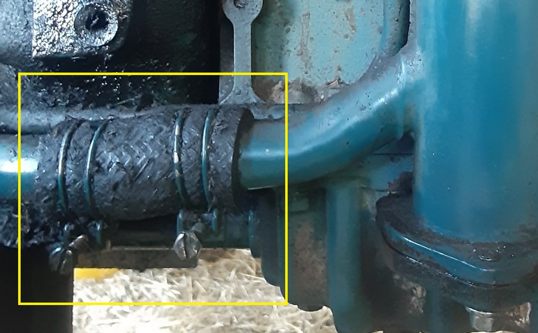

Did you remove, clean and inspect the suction screen? Did you check the entire suction line for deteriorated pieces of hose? Air leaks on the suction side of the pump cause problems.

This is not your tractor but an example of the joints that can be found on hydraulic suction lines
