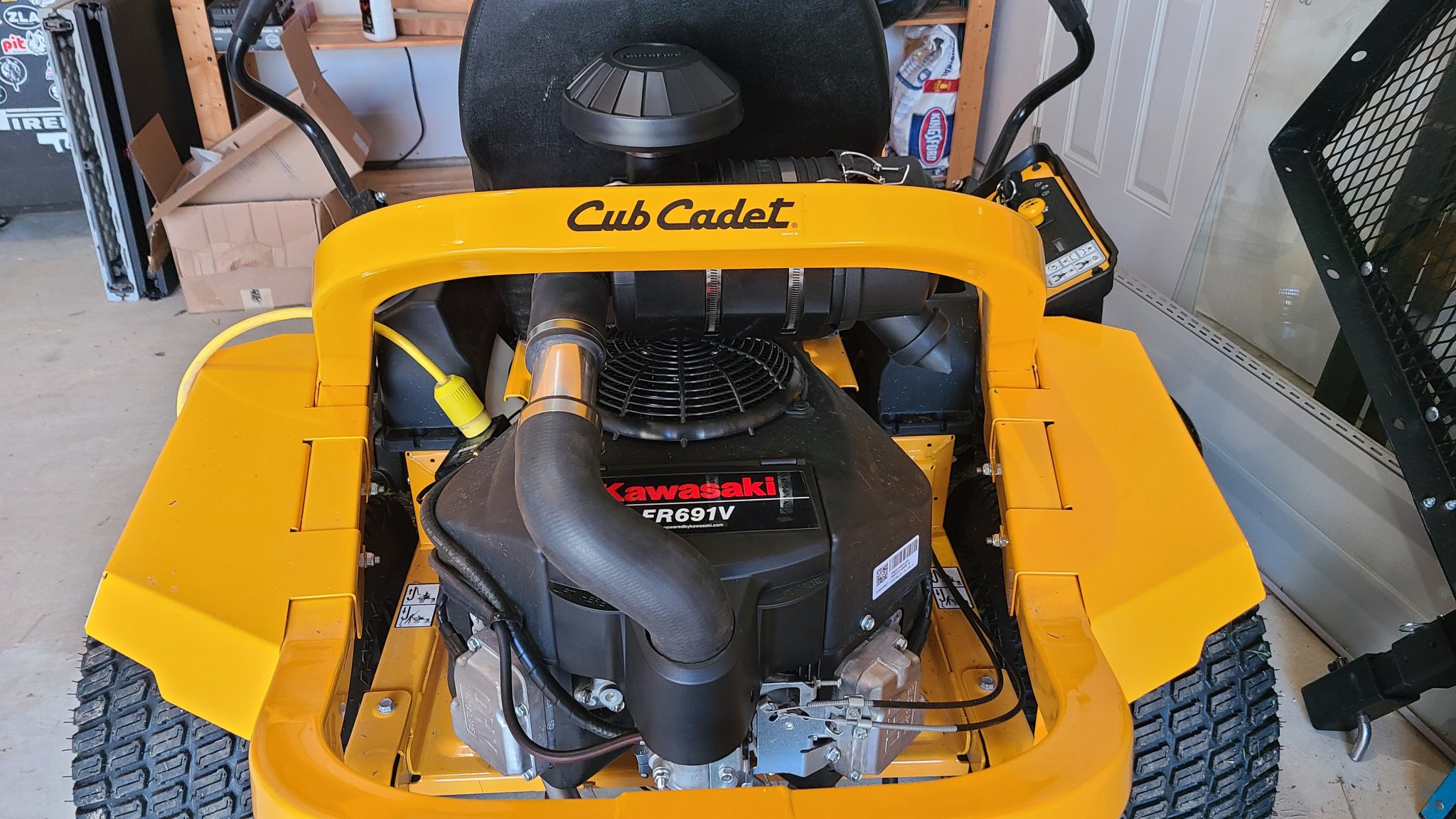

You could just go full redneck on it. get a new piece of hose to match the length, but then just zip tie the canister to your engine roll over bar :ROFLMAO:
No dont do that. It would look so janky, but the engine wouldnt know; it would work just fine lol. In all seriousness I think you could easily build a different mounting plate. Just kinda figure out where you need the canister to be then find a way to get it there. Sounds like youre on that track. Good luck. I mowed the other day for the first time with mine installed. My mower is brand new, but I do love the much beefier air filter. It has probably 4 times the filter area, plust the added inner air filter which acts as a protector when you need to clean or replace the outter filter. I do this same thing on my L2501 tractor - it has a very similar canister filter set up, but kubota does not include the inner filter element on the lower model L series. I added it for $20. Its good insurance. My air intake is never exposed to the dirty air box. The inner filter on my kubota seems to never get dirty. the outter filter does 99% of the work.
A little beer and a little thought!
The Evil Twin
L2501, LA526,
Jul 19, 2022
3,214
3,564
That actually looks better than the regular installation lol. You kept the original airbox hood I see, so you had to drill a hole in it. Is there a reason you decided to keep the hood in place, or just aesthetics? It looks good though, well done
Thank you!
I kept the hood purely out of OCD. Not only do I think it looks better, but I could see the empty cavity being a repository for debris. I bored a 2.5 inch hole on top and a 1/2" hole on the side to access the hose clamp screw.
