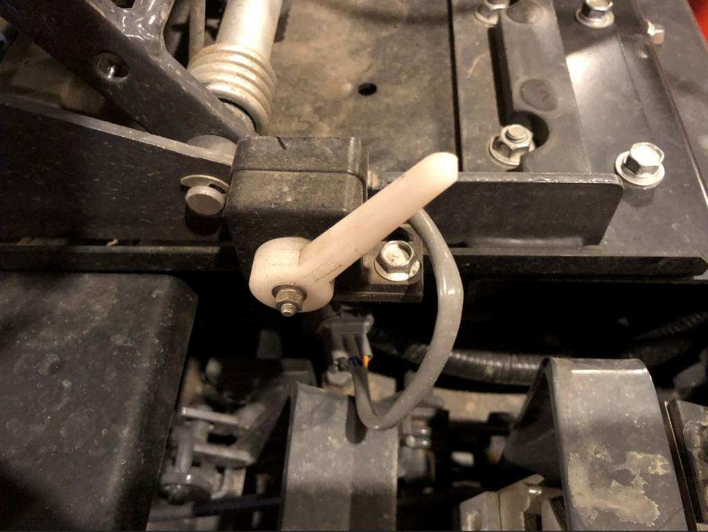

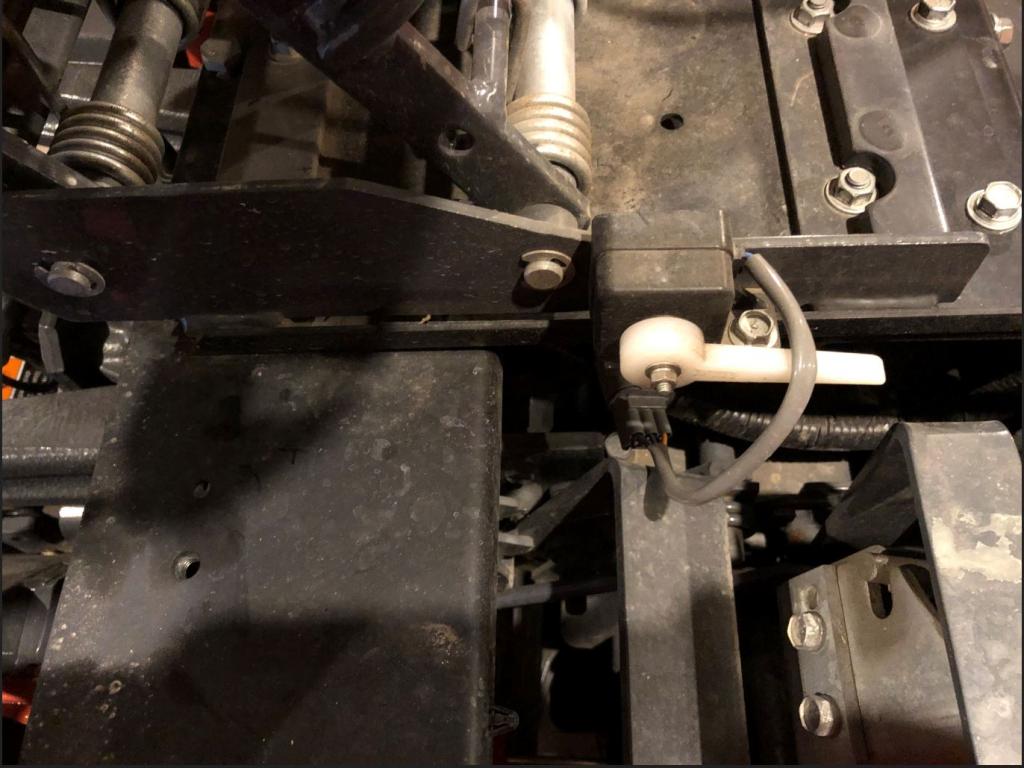

Here's my switch "fix" on the B2650. Not that I'm advocating it, but I'm on very flat land. It can easily be returned to the normal position if need be.
