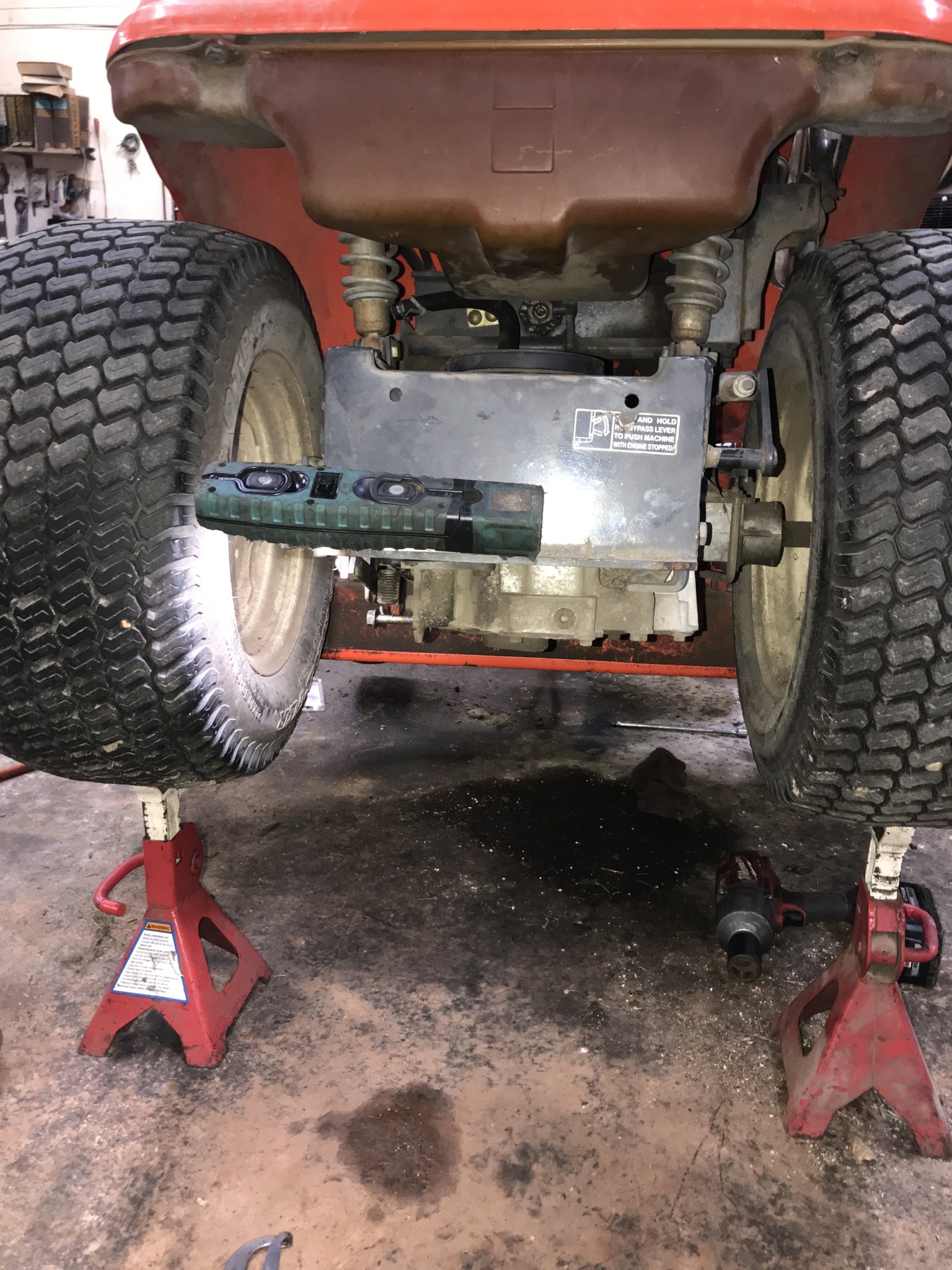

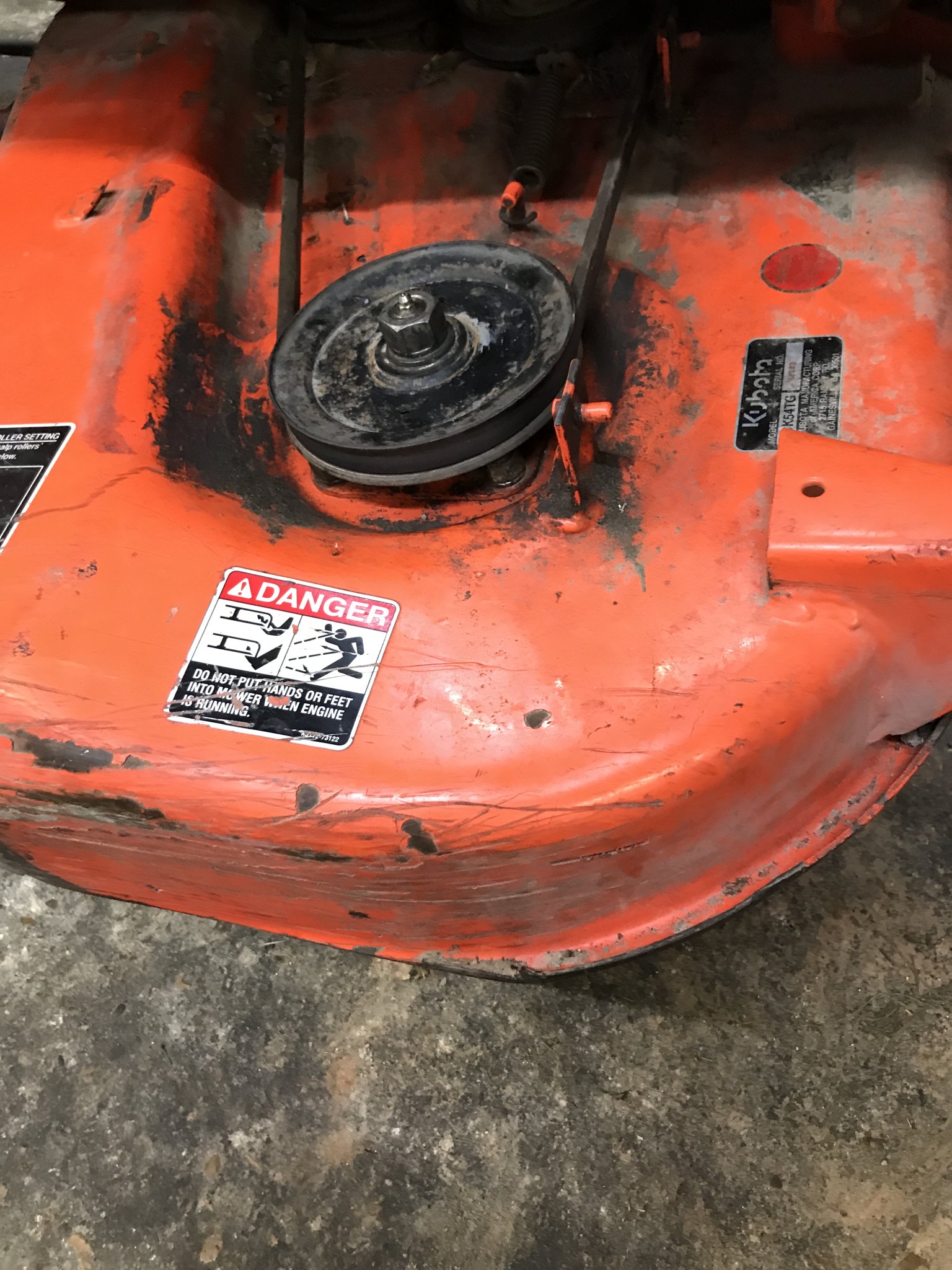

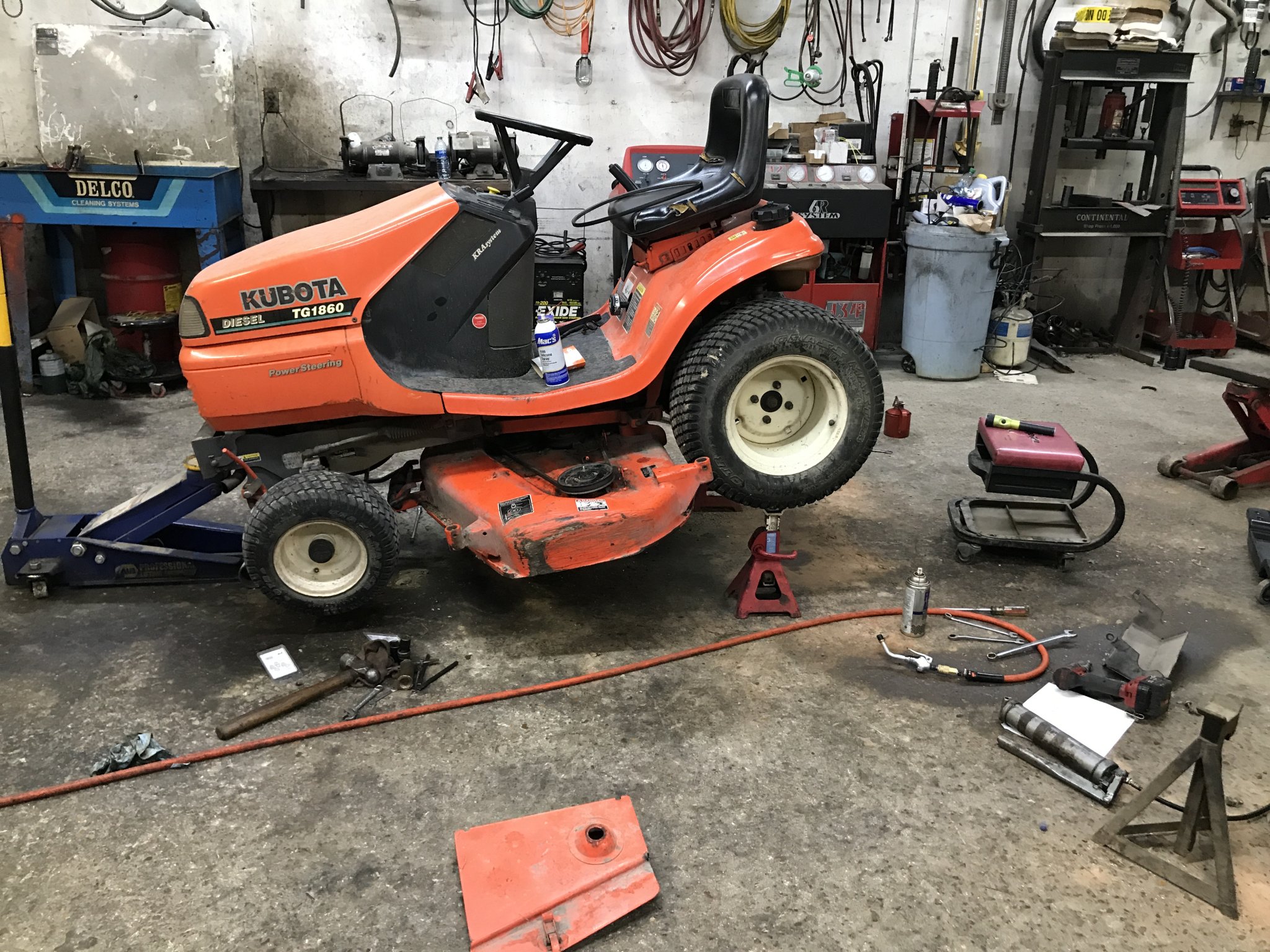

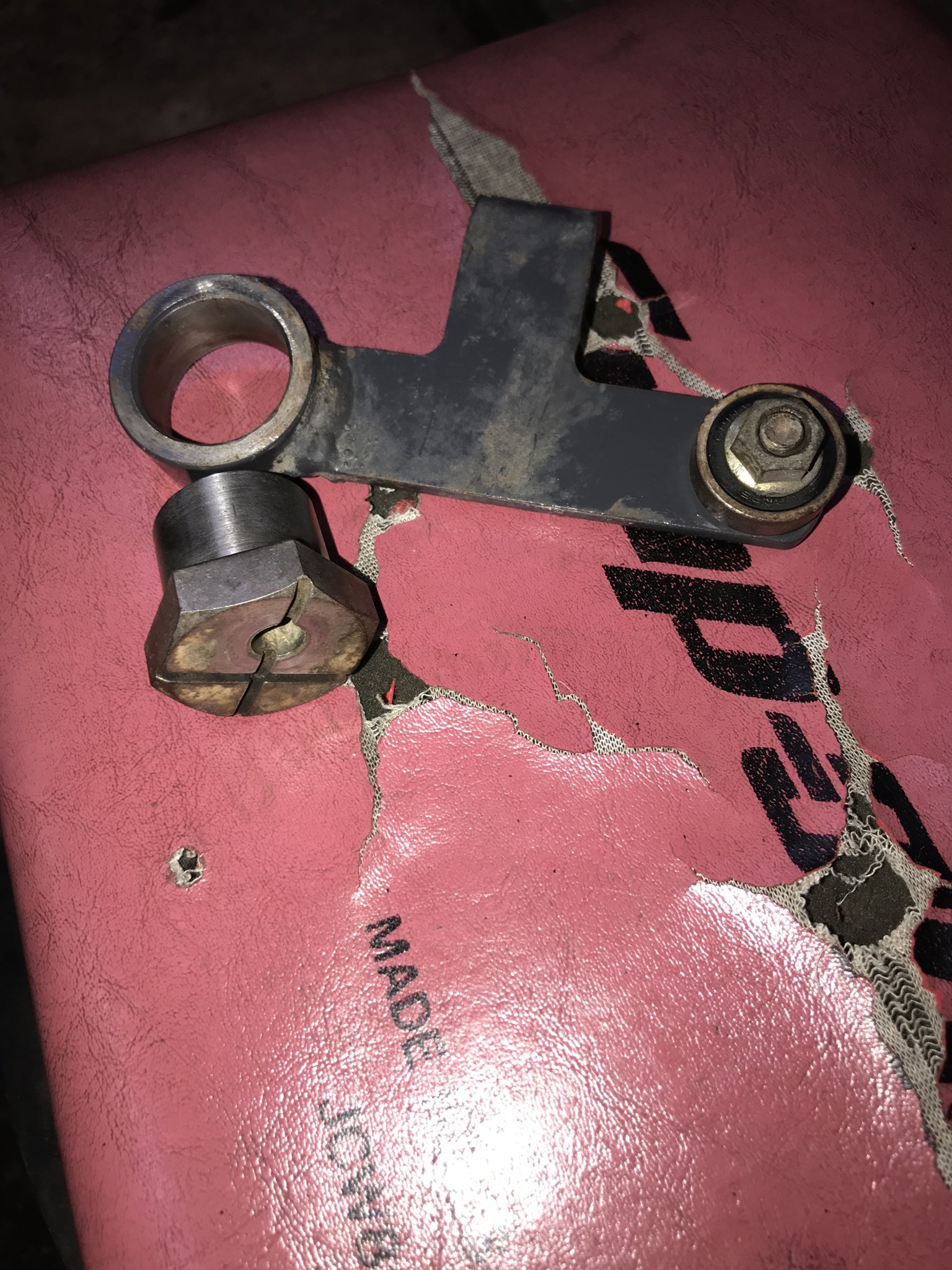

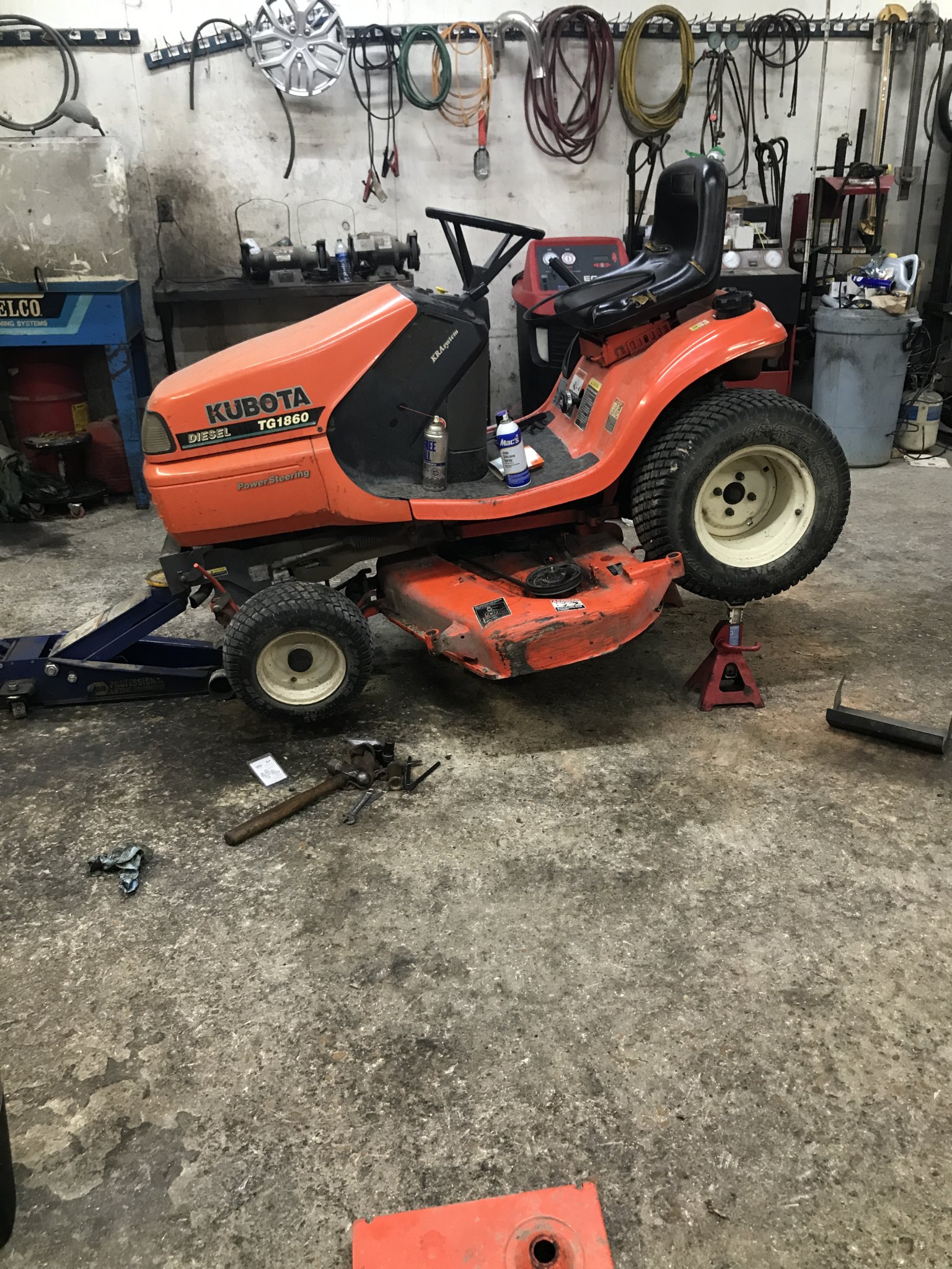

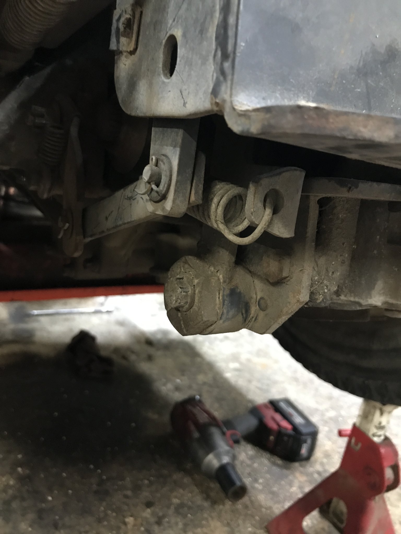

It was seized alright. I’ll tell ya, I did a lot to it. One set of gimbal bearings and seals, sharpened 3 blades. Oil and filter. Air filter looked to have never been changed, did that. Starter solenoid was clicking. Installed a universal relay. Starts every time now. 90* grease zert in center spindle shaft. Brake fixed. Hydro pedal now has a center, no creep.
New HST vent hose and belt. Battery hold down missing. The center bar is ordered along with all anti scalp wheels and hardware. I’m so tired probably forgot some things. Whew it’s hot in Texas 78475569-C920-45ED-B60E-A85EE6DF62AA.jpeg 59072056-29E3-4636-A25F-176BE29A2E6D.jpeg 7FC232B8-B283-4521-8F50-E0FDA9E77C49.jpeg EC7D0B25-9050-4484-BB16-78633B45B76E.jpeg 7FE76AE7-11C9-4595-BDD9-D6E13D89A15C.jpeg 48881CE3-BF85-4409-AB40-2CE62CC141AE.jpeg 10E300B5-0EE0-40CE-890E-D915EC523B07.jpeg

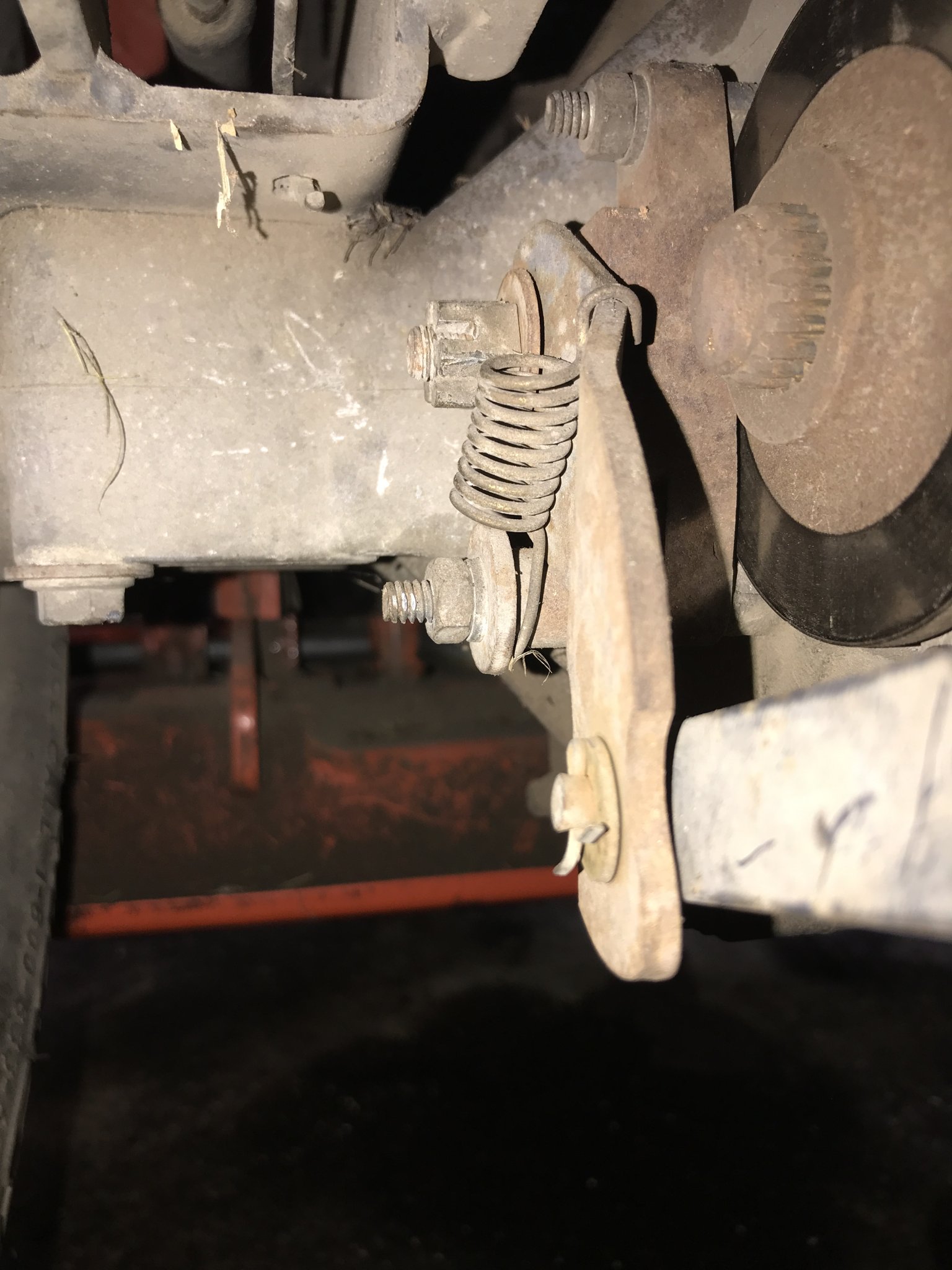

So I think that set screw on the neutral arm is loose on mine. I got an alan wrench on it but I can only get like 1/6th of a turn on it cause its such tight quarters. What’s the best way to gain access to that set screw?

Just a little update. I finally got around to working on my hrydo creep problem. I took the wheel off and got to the set screw on the neutral arm. It was backed way out. I tightened that down and that eliminated my creep issue! Also adjusted the brakes so they also work now. Gave the tractor an oil change for good measure. It's always rewarding fixing your machines yourself.
