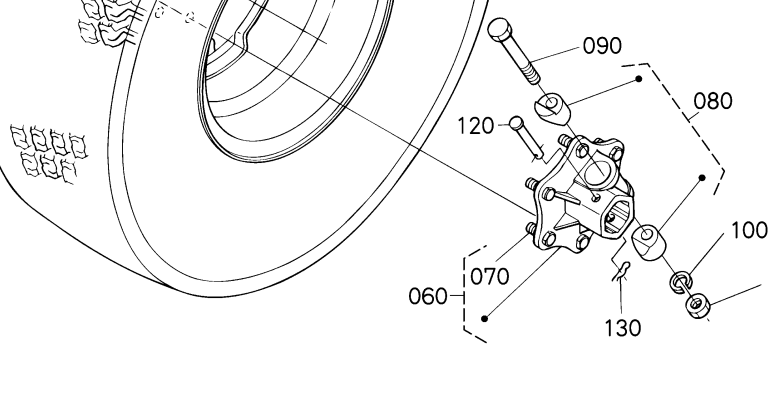

The large nut you referenced is on a bolt that travels through 2 round blocks with beveled ends. It forms a clamp to pinch the axel so the hub does not move. You need to get that nut to turn either by soaking it with penetrating oil or an impact wrench. Once loose then you my be able to tighten the nut to pinch the axel.
If the hub is very loose you may be able to take out the small pin and slide the hub off the axel to be able to work on it separate from the tractor. Hub.png
If the hub is very loose you may be able to take out the small pin and slide the hub off the axel to be able to work on it separate from the tractor. View attachment 78978
The clamping parts are called "cotters" # 80 in the illustration. They can rust into the hub and be very difficult to remove even after the nut and bolt are loose and removed.

Kubotasam, thanks for the illustration. That helps a lot.

I tried tightening up the bolt. Wouldn't budge. So I removed the pin and took the hub back to the shop.
The wedges (#80 in the illustration above) were butted together. That's why I couldn't tighten up the bolt.
The faces of the wedges were badly worn away. The axle must have been that way for a long time before I got the tractor.
I got online and found out where there's a Kubota dealer. Took them an hour to find 2 of the wedges. Now I just have to make the trip to get them. (It's unfortunately some distance away)
I'm not sure if the hub is salvageable or not. It's showing some wear. I figure I'll put the wedges in and see how it sits, and make a decision then.

You can grind the ends of the cotters to shorten them so the do not butt together. Then they should clamp tight to the axle.

The end of the old wedges were too far gone to grind down. They looked like the end of a chisel that had been beaten on for many years and mushroomed out.
I got the repaired tire and new parts. Wet to the pasture this evening and got it all put on.
The wedges looked tons better than the old ones, and tightened up nicely.
