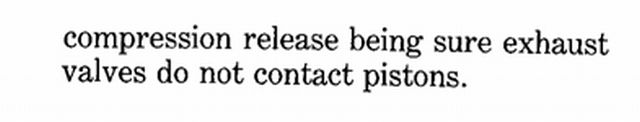

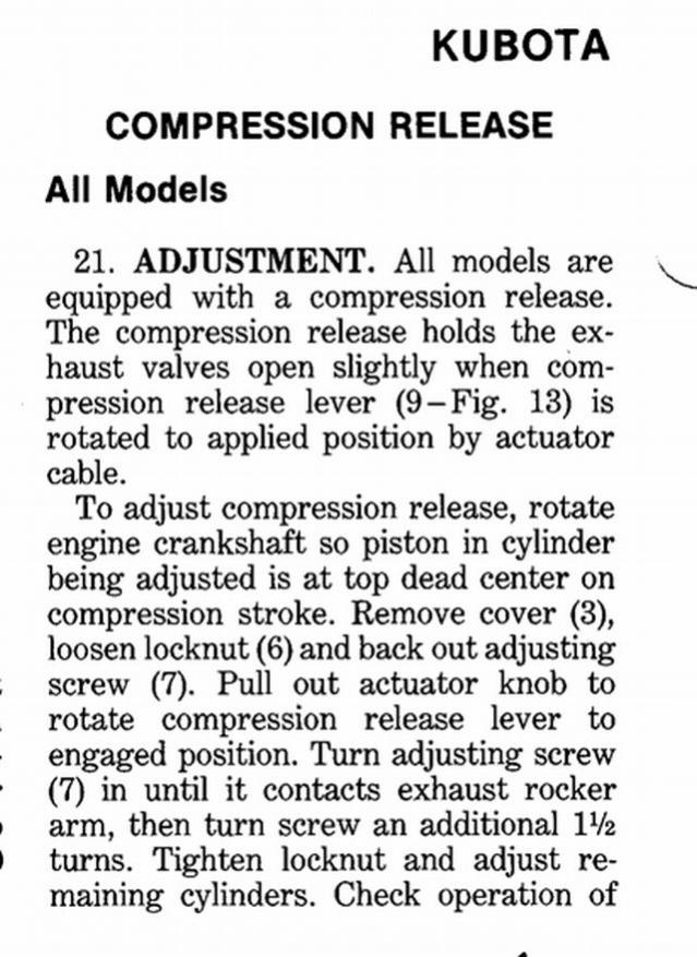

Just a quick status update on my situation, currently awaiting the parts to arrive for my decompression lever (sometime next week hopefully, depending on where the separate parts are shipping from) once that arrives I will attempt to install and see if that assists with the start up situation. Anyone by chance have any idea how to set the little screw that sits inside the valve cover that the decompression lever actuates to decompress? I asked the dealer and they had no idea unfortunately. I would have to say the length of it will be fairly important as to not allow the decompression when it's not supposed to be actuated. Thank you.

My B7100 has a D750 engine....excerpt from my B5100/6100/7100 manual:

Thank you Lilfoot, that gives me a good idea of where to start. Appreciate the insight.
