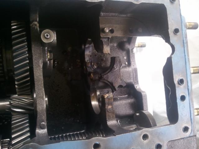

I was told it was because there is no frame bracing on the tractor, so all the stresses were concentrating on the bolts that hold the clutch/trans cover to the engine...which is where it cracked
34,235
9,423
Mine cracked due to an incompetent mechanic, he misaligned parts and forced it together.
Headed out to pick it up now from the welders.
