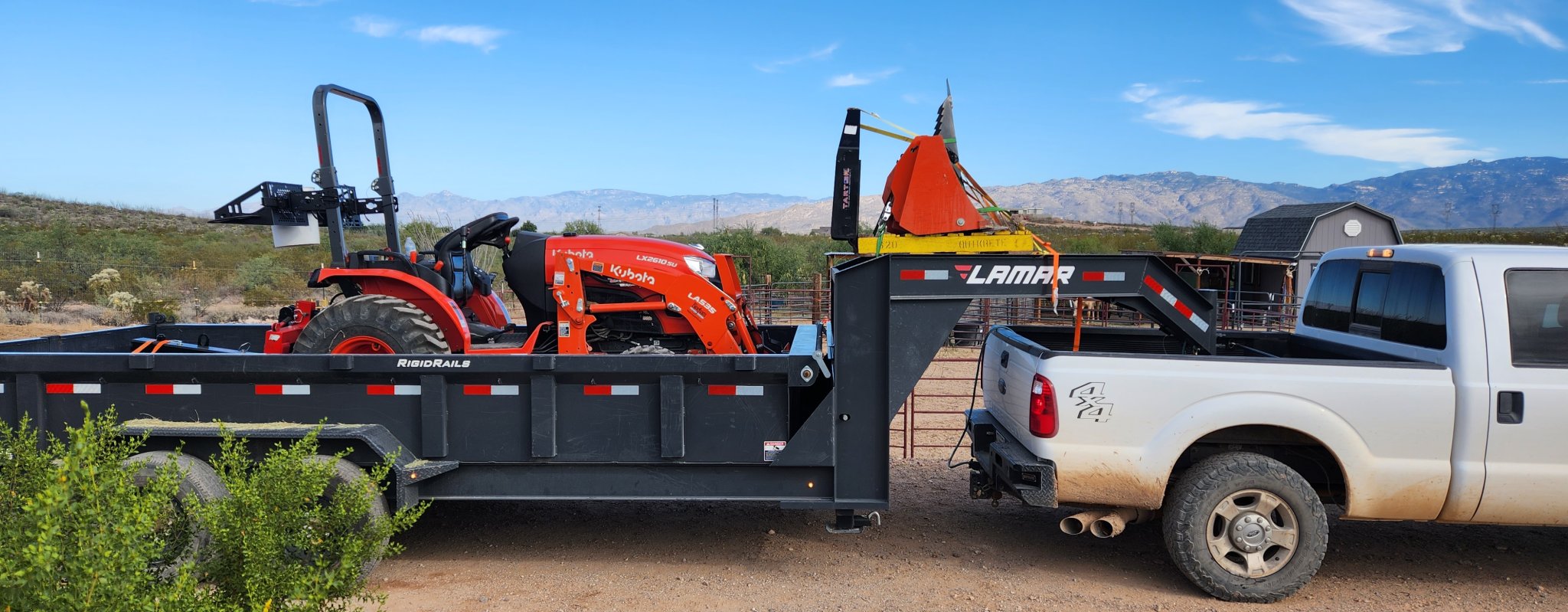

I am curious about the outcome here since i am interested in getting a combo bucket myself. Have an LX2610SU, am in Southern Az and already have a 6' rear blade and rake from everything attachments. Great implements. For the front i have the standard 54" bucket, pallet forks and a stump bucket. It seems to me that a 4 in 1 buck would be great for spreading loose material with the front of the tractor, without having to come at on the side or backing into it with the rear blade.
Also want to add that we upgraded from a BX1880 with a pinned bucket. It was super slow going loading my dump trailer due to limited lift, height and reach. LX does it in less than half the time.
Anyway, if the OP is still about, what did you decide?
