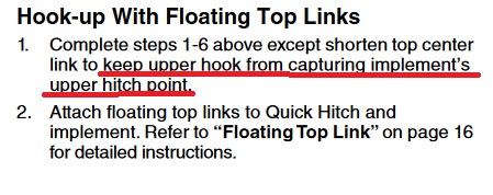

The concern with any rear mounted mower is that it have a floating top link.
If the top link is rigid, then when the tractor goes into a dip, the weight will be carried on the implement rear wheels which will bend the 3 pt hitch assembly.
Landpride has a floating top link. Some owners just use a piece of chain.
You do NOT want the Quick Hitch top hook connecting to your cutter as described in this Landpride manual excerpt
