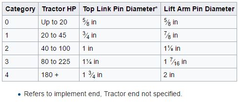

I'm looking at different implements, and I'm coming across, category 1, 2 and 3, and I haven't seen an explanation of what the specifications are for those categories. Any help is appreciated.

It appears you have a category one tractor. Buy the same implements.

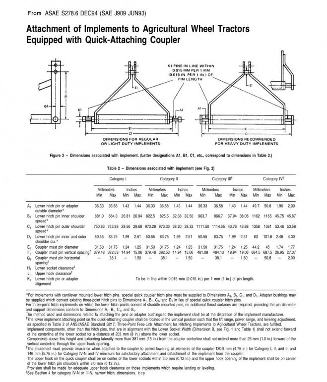

The difference in the hitch is the pin size and spacing. The implement difference is size, weight, strength, and horsepower required.
Attached are dimensions.
Bruce
35,704
10,781
Cat 0 I II III IV are category classifications, they are based on size, weight, capabilities, and HP required to use the implement.
Your L will only use Cat I implements.
How you can tell the CAT level is by looking at an Implements pins.
It also has a bearing on the height and width of the pin placement.
