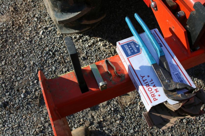

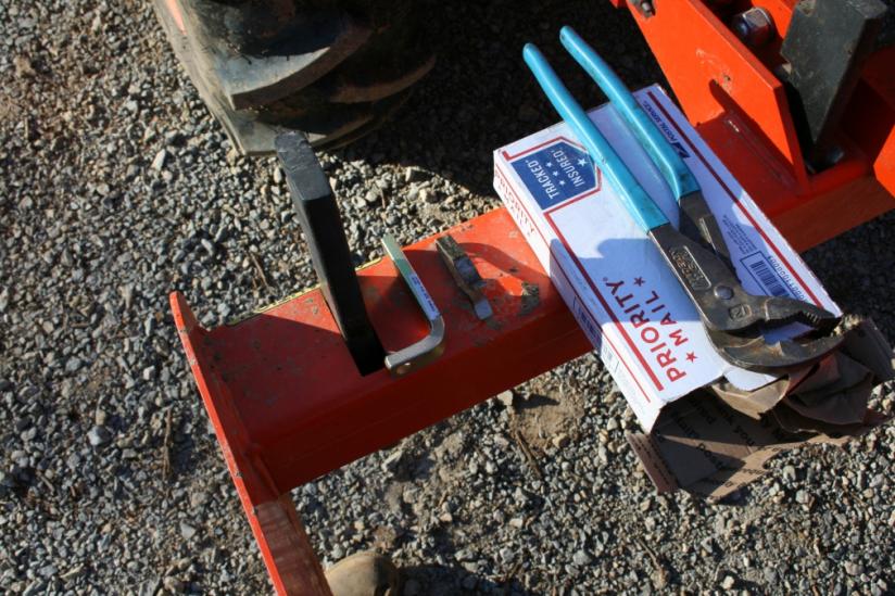

The keepers that come on the Land Pride box blade are a pain to get out when you are trying to do work with and move the shanks up and down. I saw these on eBay and thought I would give them a try. They call them F-pins and were $26.74 with shipping for five of them. Seem to work so far, I will follow up when I get a chance to try them our for real.
Here are a couple pictures to compare what comes on the box blade and what the F-pins look like:

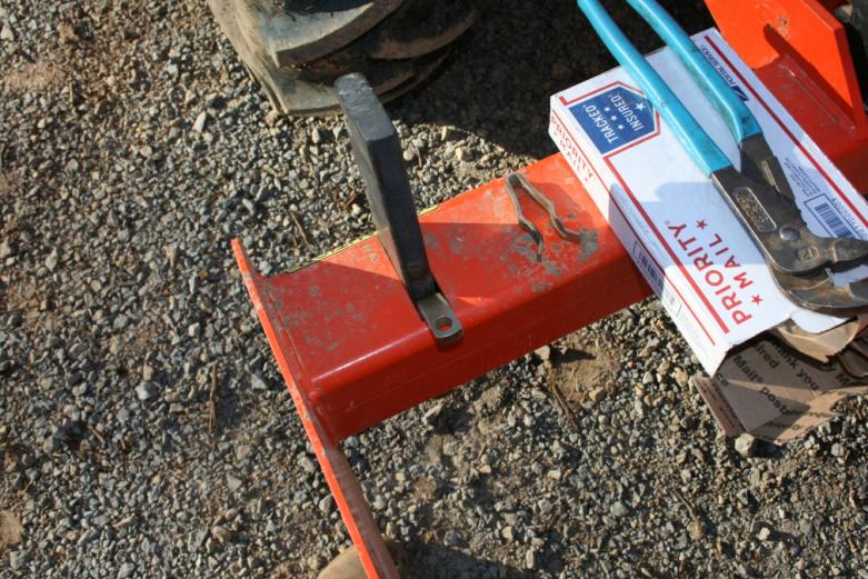

And a picture of the F-pin installed:

How does that keep the scaifer from moveing up or down.??
I think if fills the gap up so the tooth cannot come forward and unhook. It looks like it just hangs in the slot loose
7,285
2,240
Scarifiers are notched, f-pins keep them engaged. I have the same setup with those spring clips on my Gannon box blade. Kind of a pain, especially when one "boings" out of the channel locks & goes flying. I had some "L" bolts (for stem wall to sole plate) and cut the threaded portion off, for the same effect as the "F" pins. (but cheaper:))

For a nwb that hasn't used one yet, what would keep the new F pin from bouncing or rattling out on its own? I noticed a hole in the pin but nothing to keep it in place.
I'm obviously missing something :confused:
mdhughes
L3901DT
Dec 10, 2014
1,212
632
Ste Geneveive county, MO
When the shanks are are down, there will be pressure on the pins and I hope the length of the pins will keep them from bouncing out.
7,285
2,240
That is my experience, haven't had a single one pop out yet. When I'm not using the rippers, I reverse them so they're sticking up, and drop the "L" pins in. Haven't had any come out that way either.

Sorry to resurrect this one, but I have acquired an identical ripper, all I have is the shanks and the tool bar that they go into - no pins or keepers.
I cannot for the life of me understand how those keepers actually retain the shank though?
In the third picture is the f pin driven in and held by friction, or is it just hanging there?

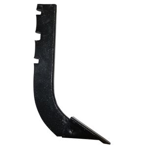

The scarifier has notches that engage in the box blade. The pin/keeper then goes into the space left by sliding the scarifier notches into the support. In the picture below, the scarifer would move to the left and the pin would drop into the open space on the right.
