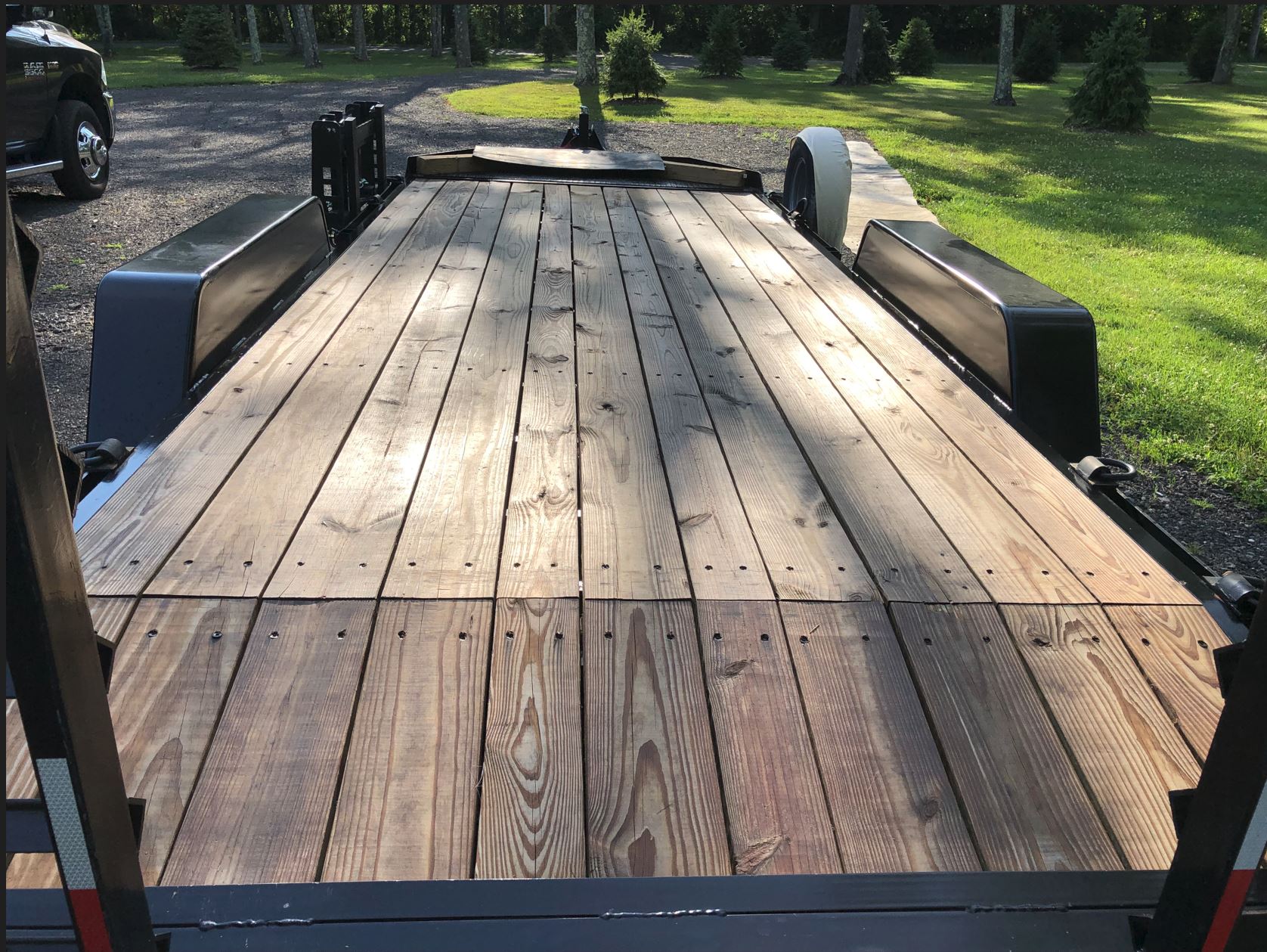

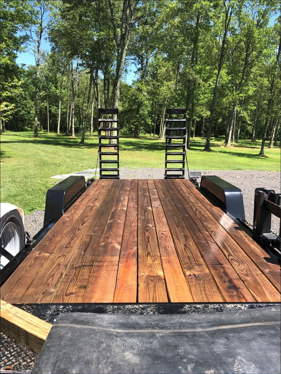

New decking on my trailer
Downeaster
Kubota BX1880, loader, mower deck, and ballast
Oct 18, 2022
197
84
Waterford, Maine
I saw it demonstrated a few years ago Before I ever bought any. The rep opened a gallon, stuck a piece of 4x4 in the sealant and within seconds it was moving up the unexposed portion of the 4x4. I can’t believe how long it has lasted on the wood I have used it in. It’s really a really good sealer/stain.
This was great for me to know. I have used the Thompsons before with no so good results. The trailer I have now is my 4th trailer, and finally alum. i bought it just before covid, and the cost of it doubled after that. The company is relatively new, but known here in Maine for quality work. The boards are the best I have ever seen on a trailer, but now it does need some sealant, and I am taking your advice, and will get the Ready seal. Too cold now to do anything..
Stopped by the store that sells the Ready seal. I had to look hard as they had every Cabot stain available, but I found it on a lower shelf in about 6 or 7 shades. I picked up a gallon of the shade that closely matches the PT boards. Of all the shades it happened to be $10. less than the others. $39. When things dry out in the Spring I will put a coast on the trailer boards, and probably have plenty left over for another coating. Thanks for your post...

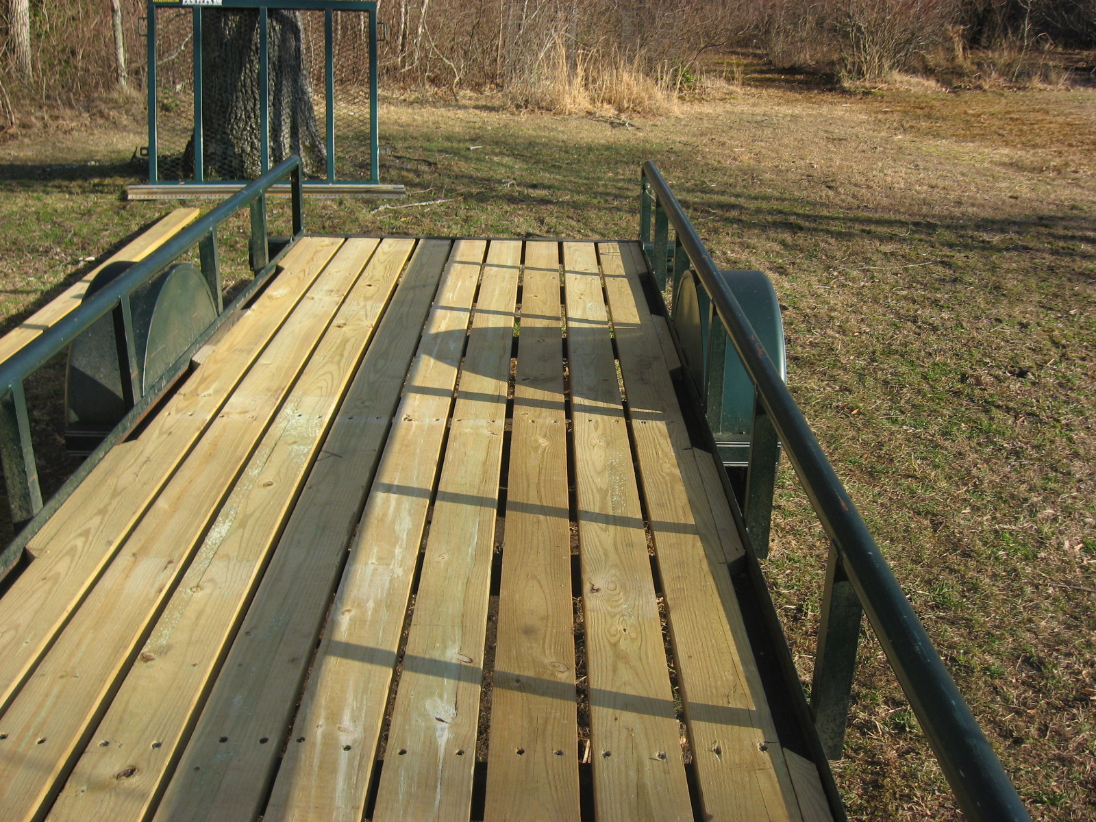

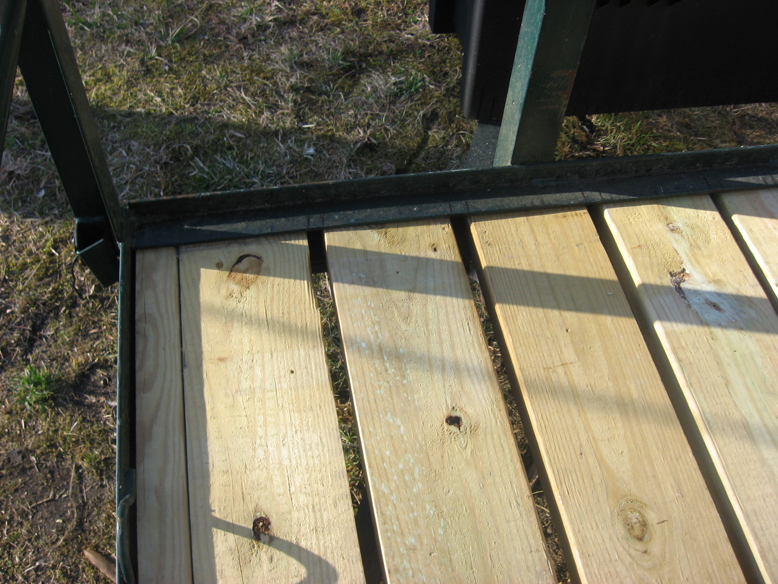

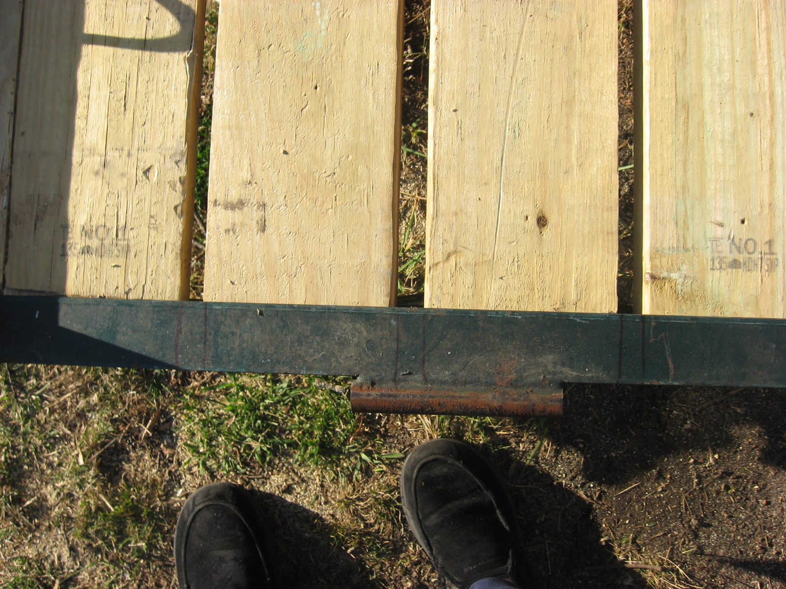

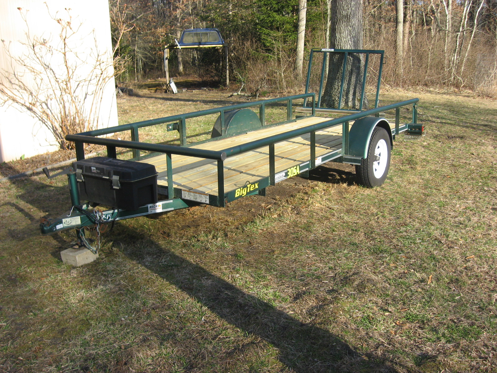

Purchased my trailer new in 2008, It is a Bix Tex 30SA, 14" x 5" deck single axle 3000 GTW, Anyway the original 2"x6" treated lumber decking was too close together and it held leaves and debris and last spring I had maple tree sprouts growing up thru the cracks, I power washed it and used it thru the summer but decided this spring that I was going to replace the decking, I cut the old decking off and used an impact driver to take the T40 deck screws out, I bought new screws and new marine grade treated 2"x6" s...Anyway when I went to put the new decking in I realized that the 2"x6"s fit in a channel in the front and back of the trailer and that I had to bow them up to get them to fit, well I have a kubota with a front end loader so pulling up on the center of a 14' 2x6 was easy peasy. anyway here are some pics, All done I stripped the old decking out friday and put the new decking in today.
View attachment 56671 View attachment 56672 View attachment 56673
Welcome to the group. I replaced a deck on my trailer also that was held in a channel at both ends, but I found the channel at the back was actually a piece of angle iron that was put on after the new deck was layed down and tack welded all along the length, all I did was zip cut the tack welds off take the angle iron off and lift the boards off.
