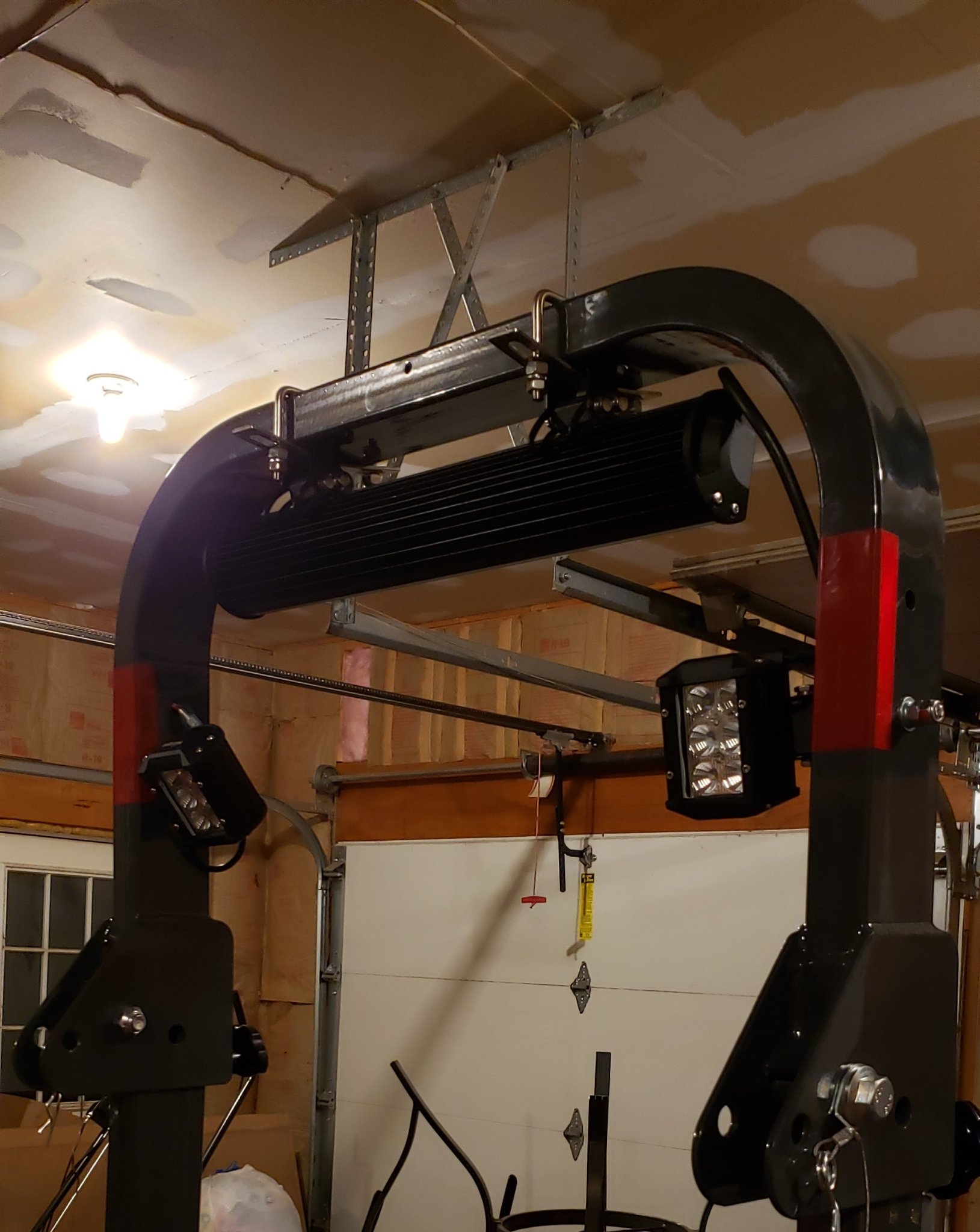

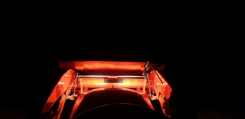

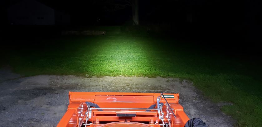

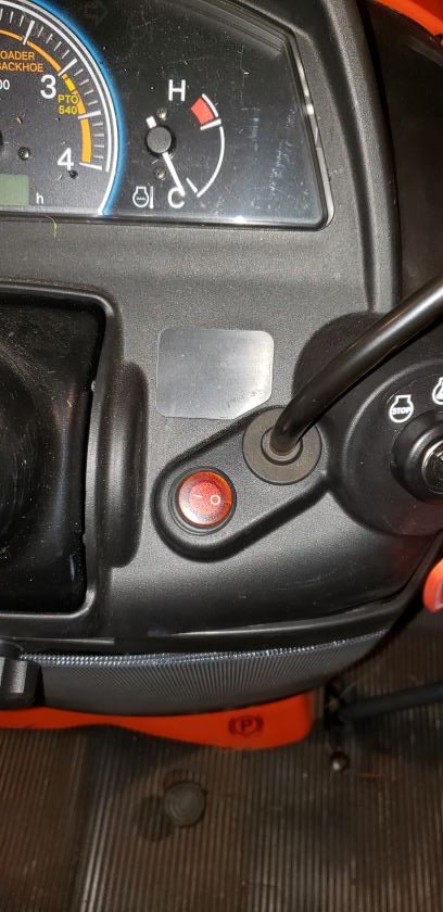

Here’s the kit I put on the BX. Same small lights as Daferris used but with a light bar, complete wiring kit with switch. I saw it on OTT somewhere.
Amazon.com: Nilight - ZH001 20Inch 126W Spot Flood Combo Led Off Road Led Light Bar 2PCS 18w 4Inch Flood LED Pods With 16AWG Wiring Harness Kit-2 Lead, 2 Years Warranty : Automotive
Easy install, hooked right to the battery so don't leave lights on too long if you turn off the tractor. I put the light bar facing forward on the ROPS and the two small lights facing backwards, one down for hook-ups and one pointing farther back for backing up.

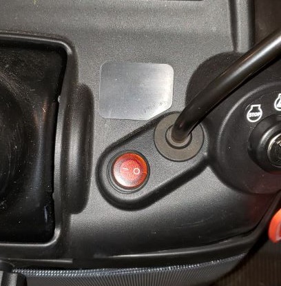

The on/off button it comes with fits exactly where the cruise control would go. Just pop out the plastic cover and pop the on/off knob right in. No drilling – fits perfectly and looks factory.

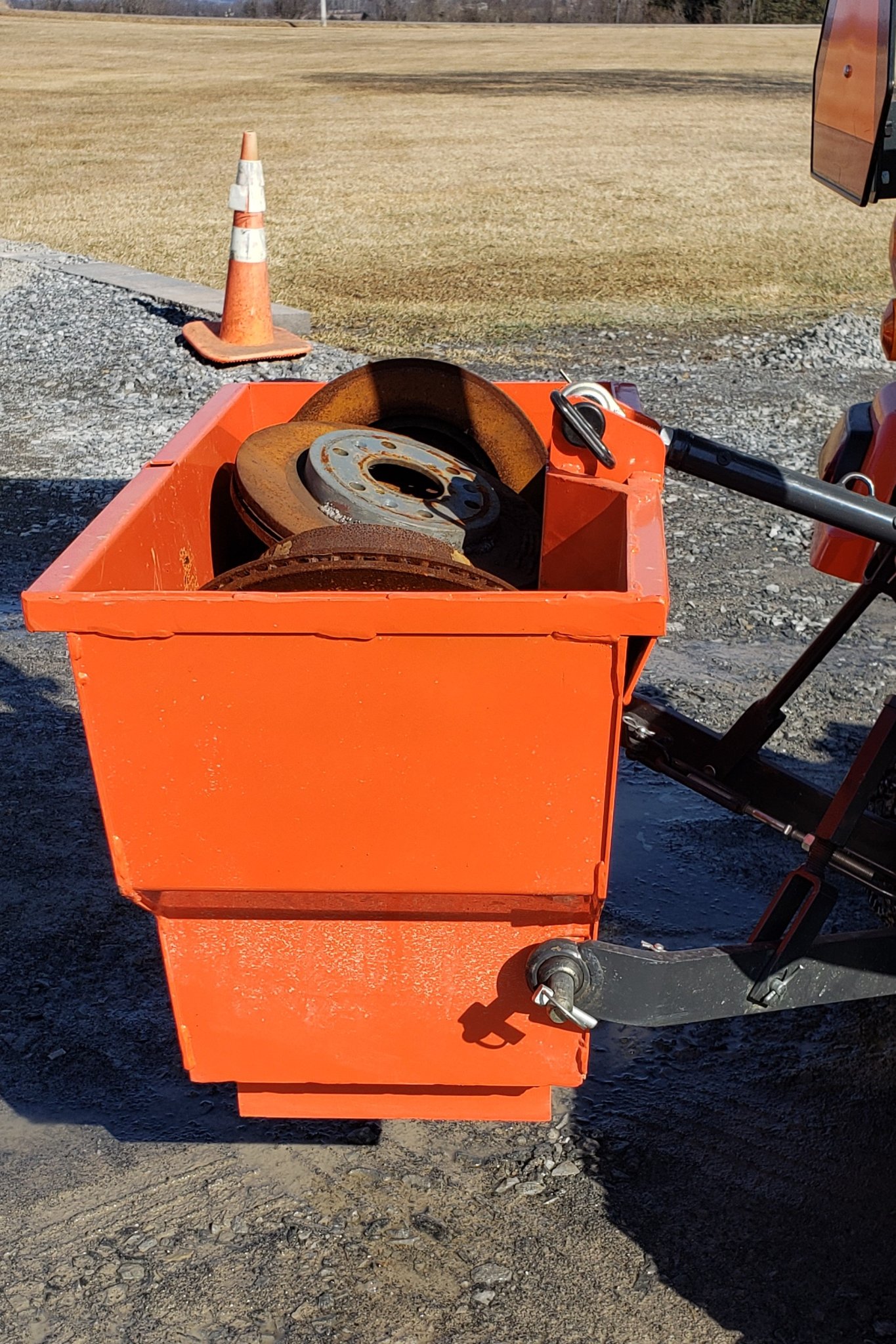

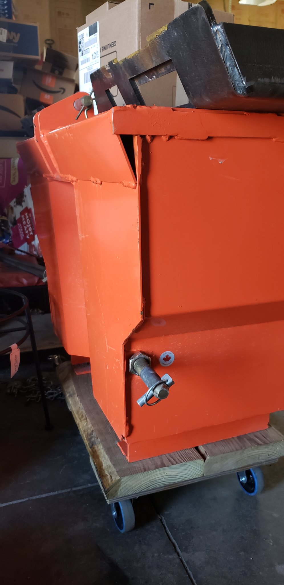

DO NOT get the ballast box shown below. Mine came with the tractor and the top angles out just enough to interfere with the quick hitch. I plan on welding some on some flat stock and moving the bottom pins back a few inches. You could always make your own too, or a carry-all.

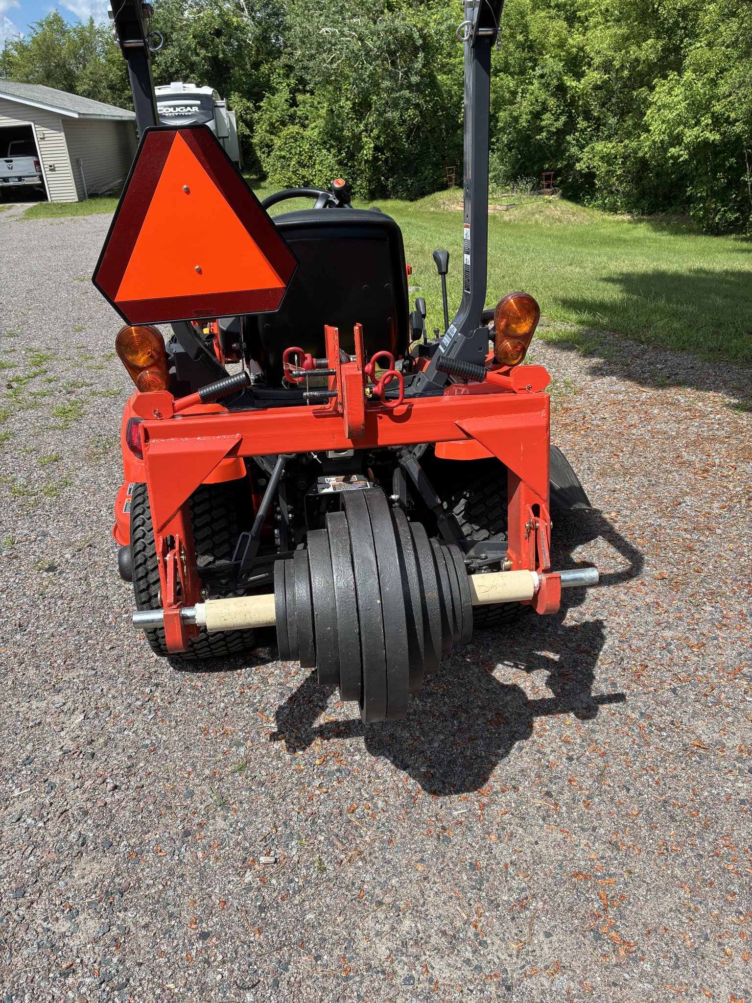

If you don't want a box sticking out back far, get a weight set and put 300 lbs back there. Works great. Don't have to worry about the back swing. Get the one inch bar. It took me 2 years to source the weights off craigslist.

I have Pat's Quick Hitch specifically so it would work with that type of box. I remember the days of trying to get implements to line up...what a P.I.T.A.
Pinning on implements when using a farm tractor that pulls the same implement for a month...sure, but for a Sub-Compact Tractor where implements are used a handful of hours and changed out? Nah.
The other game-changer is a hydraulic top-link. Doing landscaping I might need a short ballast box so the tractor fits tight spots and/or can go through ravines whereas an implement would bottom out, Then switch to a flail mower and cut some stuff down. Then a chipper and feed it some trees, all within the span of a few days. Not having to spin the OEM link to the right spot...huge win. Plus if picking up a log and needing more ballast the ballast box can be tilted out/back, for crossing a ravine in/up.
I'm still working with Summit Hydraulics on the hydraulic side-link "kit" situation. Once that's installed the 3-point should have a lower pickup point and hopefully the ballast box won't need to sit on a riser in order to grab it.
