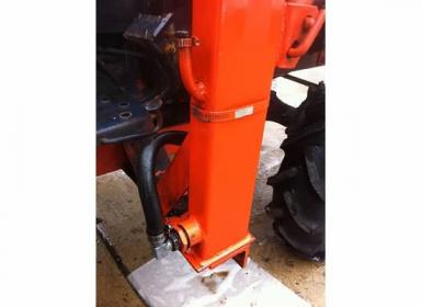

I think NIW is probably right on the hose, a pic would help.
The filter (screen) just unscrews like a pipe fitting (which it is, with a screen attached) not sure why it wouldn't come out. You are talking about the largest hex in the picture below, right? You should be able to remove the hose, the 90 degree hose barb, a threaded bushing, then the filter screen itself. Mine had a lot of sediment in the bottom of the tank, but nothing stopped it from coming out.
