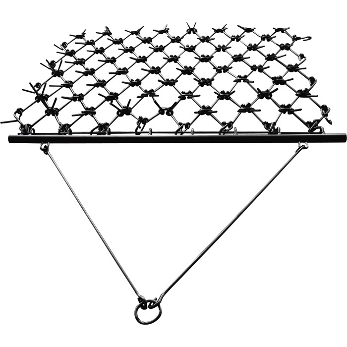

On my gravel drive;
I tried the chain link trick a couple years ago with no success. I dont think it was long enough and not enough weight.
So I bought this. My boss had one and raved about it for his beach.
http://www.northerntool.com/shop/tools/product_200365071_200365071
It weighs 80# and kind of cumbersome but I think thats what makes it work. I pick it up with hooks on my bucket to move it around.
Has 3 modes:
Tines down facing forward = very aggressive
Tines down facing rear = less aggressive
Tines up = smooth

that is a neat piece of equipment, but its about $150. to ship on top of the $180. that's a one piece solution to what my neighbor has with the ridged harrow and chain link drags. I guess Ill start with whats next door, and see if is productive.

Yes the shipping was my problem too. It took a year but I bought 1 while on vacation at a local store and dragged it home. Pretty long box for a small suv. The wife wasnt to happy. It sure works good on gravel.
