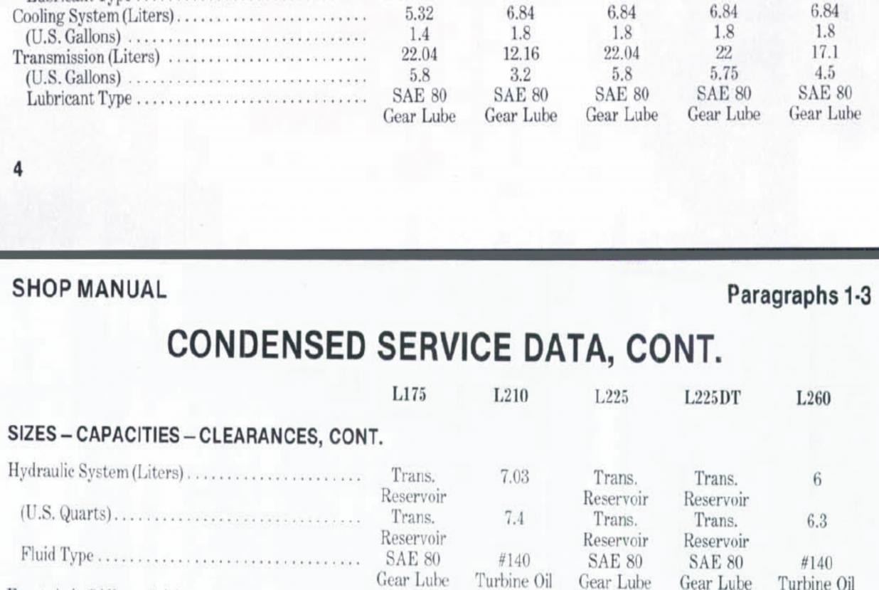

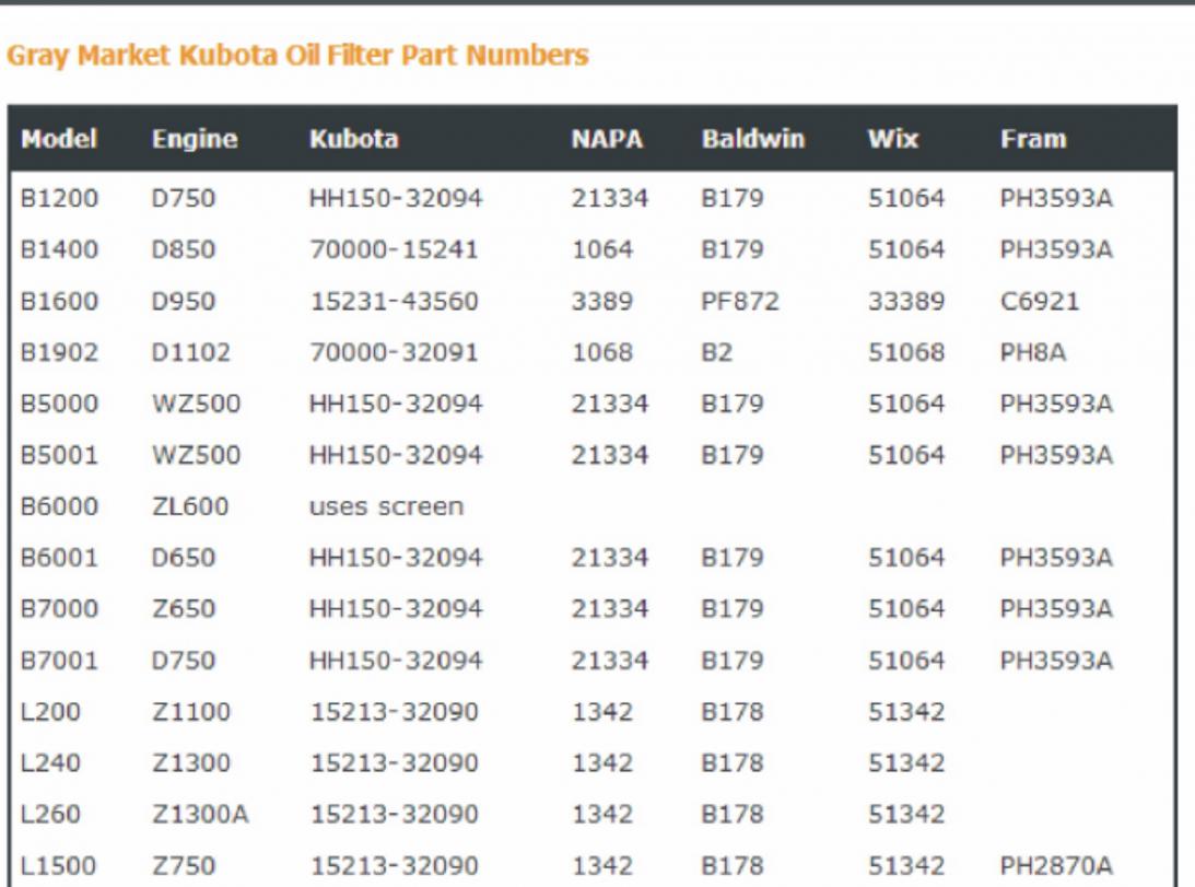

billrigsby Well-known member Equipment L1500DT Too many implements, or is there such a thing? Mar 17, 2015 1,003 152 63 Florissant CO USA 8213' www.facebook.com Dec 8, 2017 #2 For the engine oil capacities use the L175 and the L225DT for the Transmission/Hydraulic oil. Be sure to clean the hydraulic filter while the transmission is empty. I use the NAPA Filter, unless you have the cartridge type, then use Napa 7030 or Wix 57030. Use the L175 part of the manual for the engine and most body parts, use the 225DT part for the four wheel drive (if yours is a DT) Here is a link to the shop manual..... https://www.dropbox.com/sh/ddsz5ugy38pu95r/AABJNZ0U77SCnHcqn4bem2Tza?dl=0 Attachments Capacities.jpg 80.8 KB Views: 720 Hyd Filter.jpg 96 KB Views: 664 filters.jpg 82 KB Views: 623 Last edited: Dec 8, 2017
