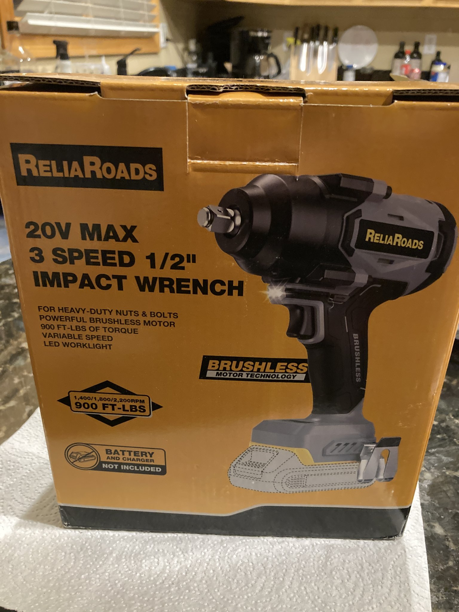

Funny that you should bring this up.
Last week I bought a 1/2 inch drive “Chi-Com” knock off impact cause it uses Dewalt batteries.
Although it removed my wifes minivan lug nuts, it did so “just barely"
So here it is, ready for the “return voyage” home……..
900 FT-LBS. my a$$…………….Their Torqu-O-Meter was WAY OFF on that.
I wonder if a “real Dewalt” would perform better?
YES. Mine isn't bad.
