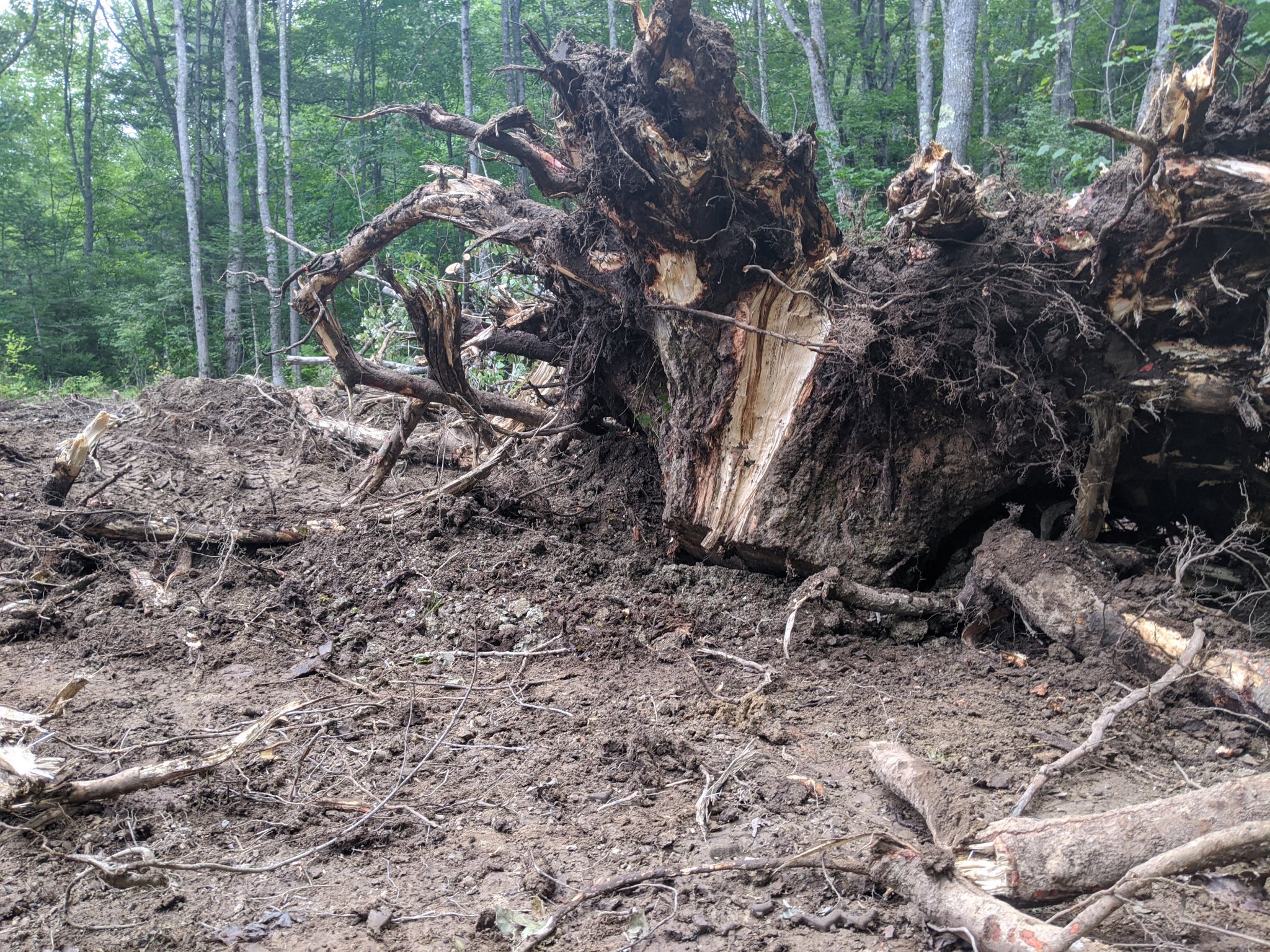

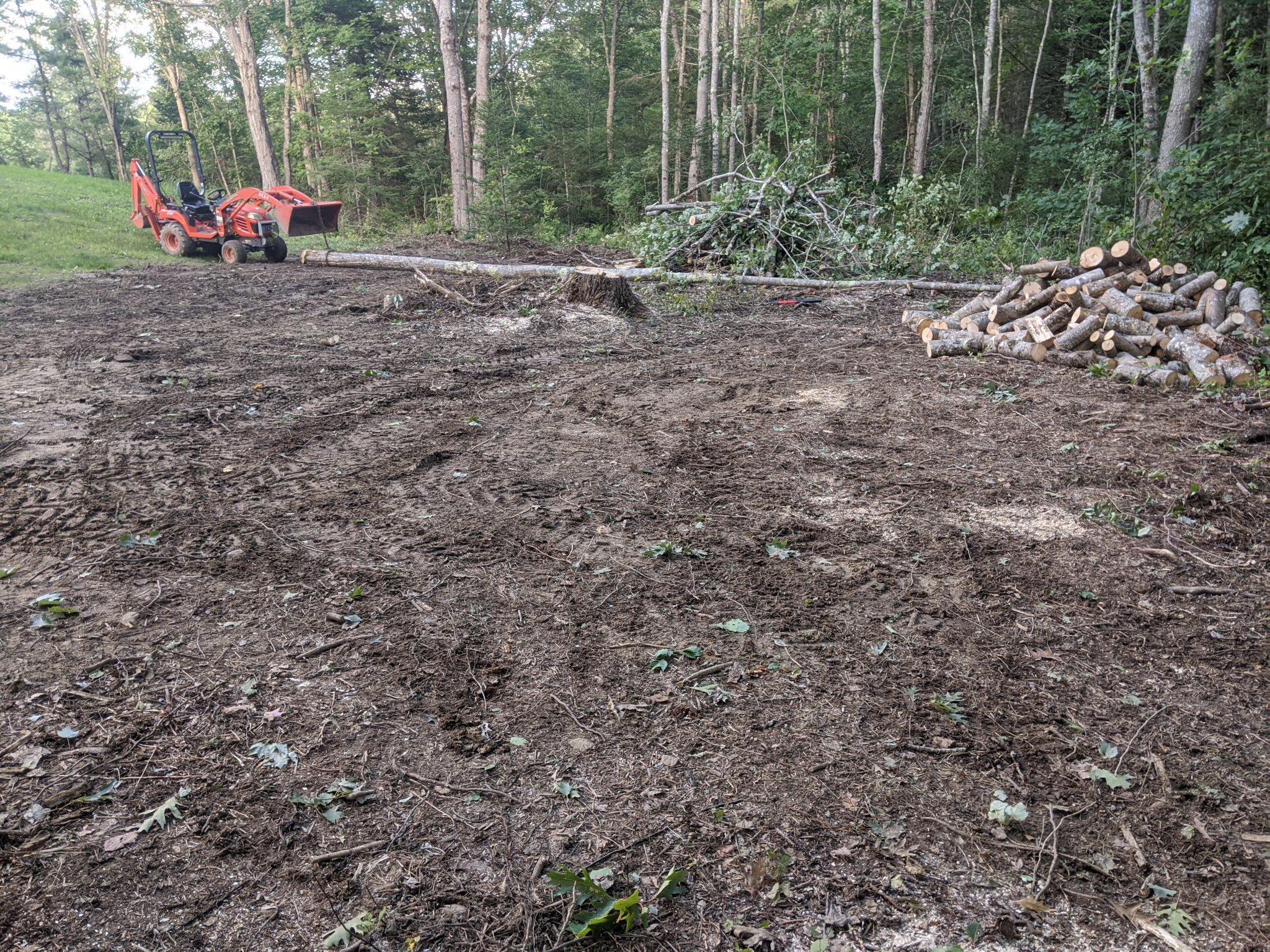

Did some grading and stump digging, and the ball joints finally went. Well, more specifically, the cotter pin and castle nut went missing on one side. I have two new ball joints on order, but there is a delay of course. The current ball joint is still functional, but I am having a hard time finding the size before I go to the store. Thread pitch matches close to both a metric 1.25 and a SAE 20, but I don't seem to have the right size to clean up the threads. If I can get a bolt on, I should be able to work the threads so I can use the ball joint for now. Thanks in advance!
