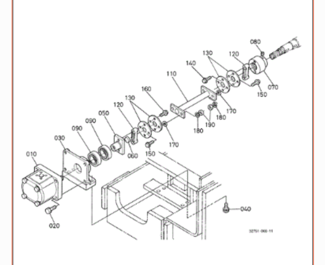

Here's how it's done on the L35. It uses flex disk couplings. All the parts, except the splined coupling could be easily made. Unfortunately, that piece is $145. Someone has mentioned replacing it with one bolted to the crank pulley.
Yeah those splines are really seeming like a deal breaker. I actually found an OEM style coupler for these, but they're not cheap, plus all the fabrication involved, along with the extra plumbing. Not a lot of room on these size tractors as it is, so I'm reluctant to go that route now. Boring and broaching the existing driven gear along with drilling a couple holes in the housing to accept the 2-bolt pump seems like the most viable option to increase pump displacement at this point.
