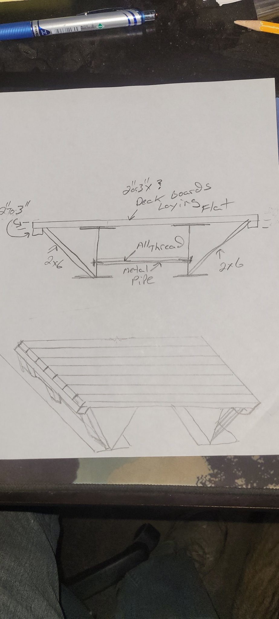

Running cross boards is a waste of time and won't do anything for strength.
You don't really need support in the center, but if it makes you feel good put the same blocking in the center as you do the ends.
14,894
7,543
Might check with local trucking companies and see it they have any trailers they're selling. Set that trailer bed on your I beams.

I was once metal detecting under a bridge very similar to yours, about the same size, and same type I-beams.
They had placed 3 or 4 heavy wall pipes, maybe 4"-5" in diameter, between the I-beams, and drilled holes in the webs for some large threaded rod. They clamped the pipes between the I-beam webs with the threaded rod, and then welded the pipes in place.
The "deck" was rough sawn lumber, (oak?) probably 3"x 10", bolted to the beams with carriage bolts.
Looked like it had been there for 20 or 30 years.

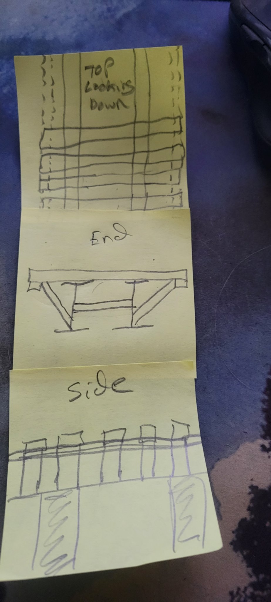

Just to be clear I understand what you mean:
Are you saying that "Running cross boards is a waste of time and won't do anything for strength." - you are referring to the cross bracing between the two i-beams? If so, I was only considering doing that in a few spots (maybe 3-4) in case of flooding to help keep them supported and from the left leaning toward the right. So far, one storm did wash a 2x4 I had laying across the top of the footers downstream (this was not long after I completed the footers)- so I know water can hit the bottom of the I-beams.
Also, I'm not sure how the creek will behave in a decent sized hurricane remnant. If I did this toward the top instead of middle of i-beam, I could then add some sort of wood beam between the two i-beams (parallel) to help support the wider gap between the beams. If I go the 2x8 route, then you're correct, there is no need for a "3rd beam".
Your top note is what I had in mind, running the 2x8 cross beams perpendicular to the i-beams - with a spacing between them. Then "covering" that gap with top deck running parallel to i-beams.
Interesting point on the middle note, I had not considered not doing a cantilever and bracing the far ends from the bottom of the i-beam. As I pointed out, kind of doing the reverse with longer cross beams to support the handrail to keep it from swaying - The current footbridge that previous owner made doesn't have support and the hand rails wobble like crazy.
I'm not sure on what you're depecting in the bottom - are you showing a side view of the bracing from the bottom of the i-beams to the bottom of the cross braces?
This is why I asked on here, to get some ideas and things I hadn't thought about. I'm digging the idea of bracing the bottom of the far ends from the i-beam.
