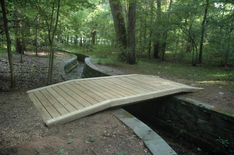

Down stream to my pond, I built this wall, took nine months, when I was younger and healthier.

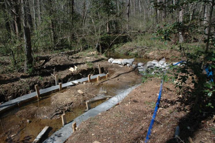

No picture of the area but if you look to the left of the first picture, you can see the curve (just past the sand bags). The ground to the right is being excavated out about 30' in.
The first picture shows the completed wall and a a bridge I made to cross the stream. 75' upstream (behind me when I took the picture )of the bridge is where I want to place the rip rap.

Funny tidbit. For years (since built the stream walls) I had just a 2X12X8' fir plank crossing the stream at that point. I'd walk across with the leaf blower or weed wacker a few times a year. I had plans for an elaborate curved bridge but I did not feel like making the investment of money or time into something that was somewhat hidden from view, being back in the corner behind a lot of trees. Well, last spring, my wife bugged me because she was uncomfortable 'walking the plank' and wanted a real bridge. So I decided to go ahead, make something simple and functional. I talked with a friend ho has a CAD program for building and we discussed construction and I realized to grossly over build the bridge (10 ton capacity) was not a big expense. Double up on the stringers, reduce the width to 12". So about $400 worth of lumber and screws and three weeks, working a few days a week made the bridge. A month later, I decided to get the BX25. I am so glad the bridge was not built just for foot traffic!

Whoa, okay, wow, nice little channel you have going there. I was picturing something entirely different in my head!
My OCD side would insist I do that all the way down my property... my wallet would scream an entirely different thing to me... then my wife would scream at me in agreement with my OCD side and I'd be off in the barn crying with my wallet! :D

My, my, what a wonderful setting -- and a magnificent job on the wall.

The wall does run the length of my property, about 875' long to my pond. Height (from the rocky base to the top varies from as low as about 3' to as high as 10'. All on a 18" concrete base fully rebarred. Ten years and no cracking. Only a few of the caps have been worked loose due to soil compaction and hitting with the edge of the mower. Idiot lawncare guy. Yet my wife stated married to him.
The area I am going to put the rip rap is actually not my land. I just want to ensure the water is coaxed to go down my canal and not start to try and erode it out from behind.
