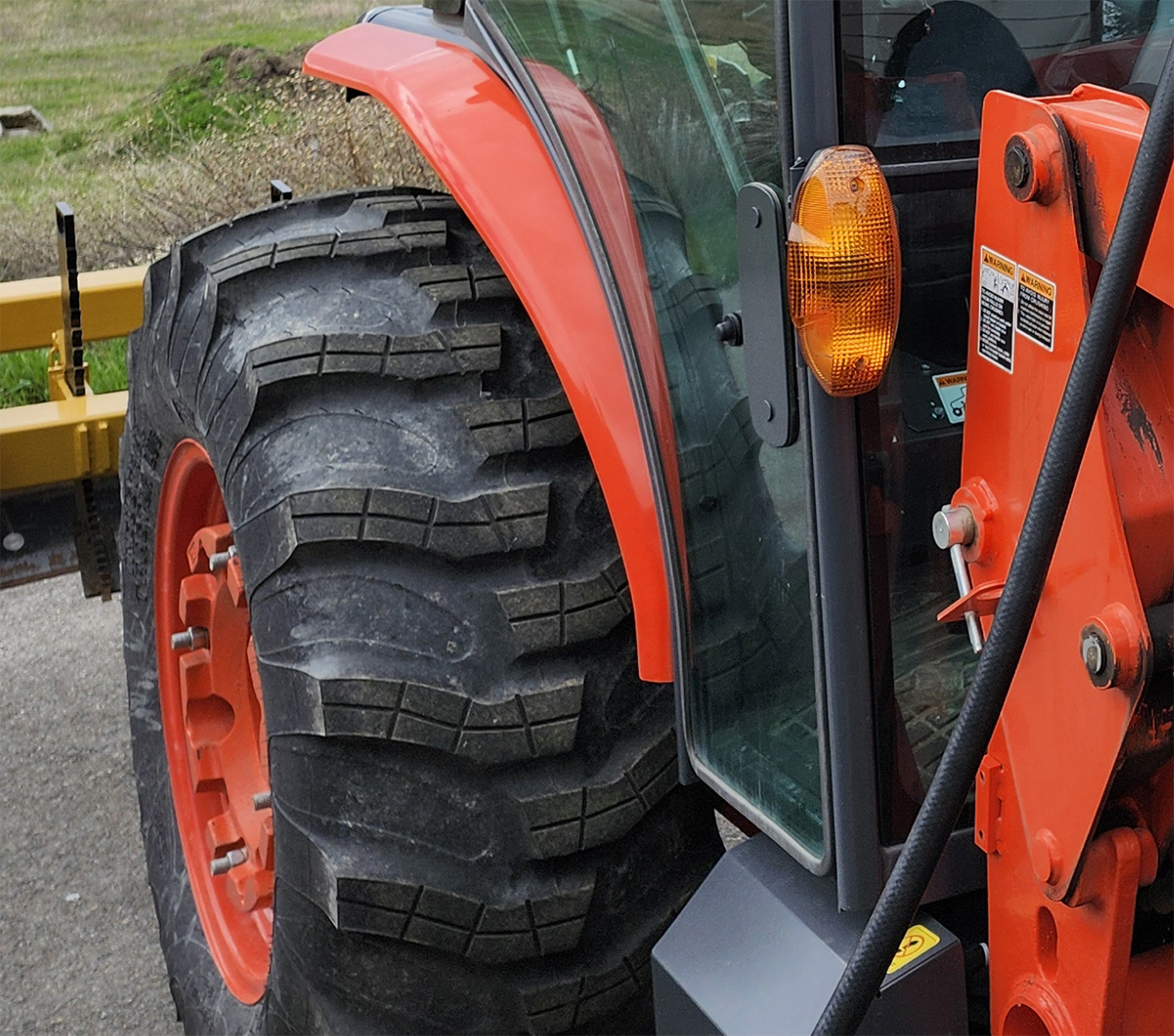

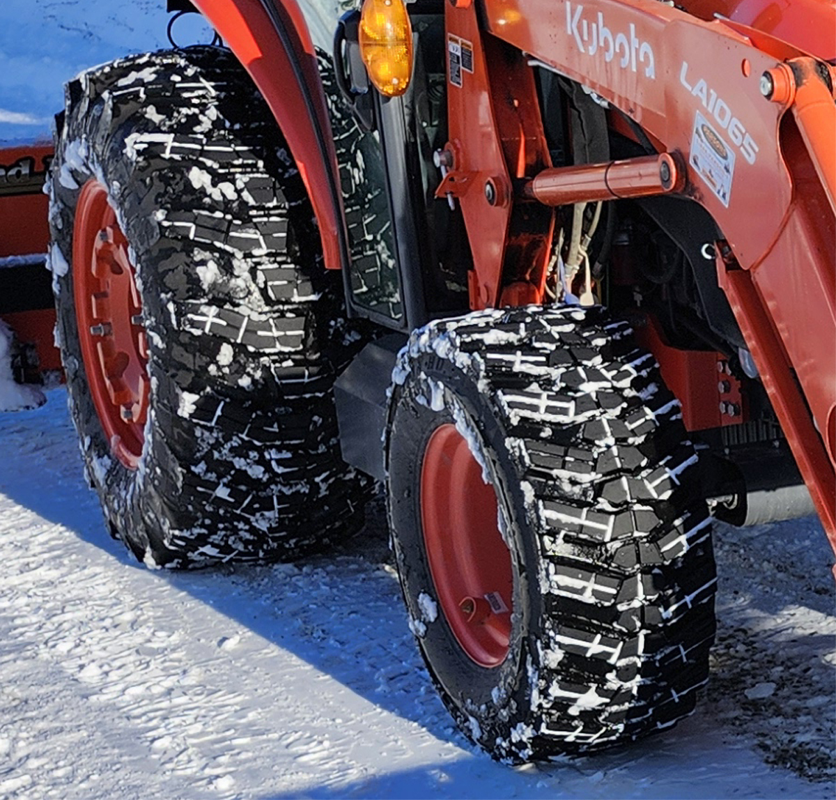

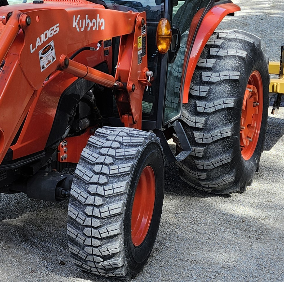

@chim & @HorsPower, nice grooving job there!
There are lots of tire siping threads on this forum, but I'll drop some images of my R4 tires here too and also make the claim that siping makes a big difference to traction. (y) My intent was to create blocks that can compress independently of the blocks around them to improve the ability of the contact patch to conform to the road surface. The grooves also provide additional "bite" of course.

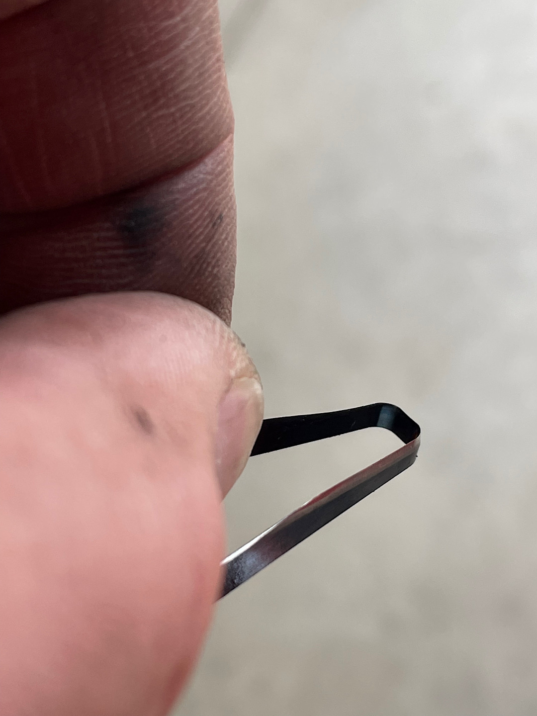

Sorry, a bit late but here’s a pic of the tip we used. I didn’t use enough heat and broke a couple I think @McMXi dialed the heat up and had no problems.

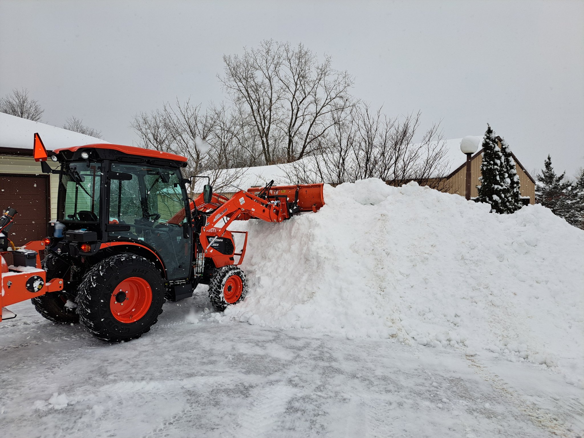

I have r14s and my driveway has a solid layer of ice from last weeks rain. I am amazed how they grip the ice, even on my hill they feel safe in 4wd. A couple pics from yesterday where you can see the ice. Getting ready to plow the 8 inches we got last night. I am very happy with r14s.
