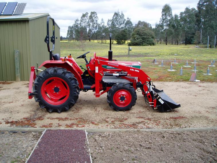

Ok, so am I missing something here :confused:
This ROPS in my mind anyway, is backwards!
Why would anybody want it to fold forwards and not be able to use the machine when folded seems to be pointless??
I removed the whole top section from the central column to find that the bolt pattern does not line up the other way.
Has this been manufactured wrongly?

Yep that is just plain wrong!
Any chance they put the bottom section on backwards?
Bottom section is not reversible and is also the top link mount :(
Im going to call them today and also the manufacturer which appears local.
On another note, I found the level indicators, the gearbox/hydraulics is a nice little sight glass behind where your left foot rests under a cover and the front axle filler plug has a dipstick on it :)

just thought i'd bounce this idea around guys, possibly made to fit a diffferent model:confused:
I have seen the same model sunshine as this advertised here in the uk with a differeing ROPS, it looked to fold backward as per normal.
It may be that the correct rops was not available so fitted the next best thing albeit backwards:eek:
justr a thought.

Hey Marc, welcome to the site. I have to say, that's one very nice looking tractor. Yup the ROPS is on backwards :confused:
That being said, you did good buying that machine. Congrats. :)

That ROPS is really weird. I have to lower mine to drive it into one of my sheds to attach the post hole digger. Mine folds backwards and I continually hit my head on it when I'm attaching the digger. My ROPS is pretty flimsy and I hope I never have a situation to use it as I really don't think it's up to the task even though it's commercially made and certified. Yours at least looks sturdy even though it's on backwards!! Most interested what you hear back from the manufacturer.

Very nice tractor mate :)
And wow, look at that flat land, wish I had a bit of that :D mines all steep, hilly, rocky, main reason I went for the shuttle shift as I just couldnt afford anything with HST.
I spoke to who I thought was the manufacturer but they turned out to be the certifiers and confirmed, no way should it fold forwards.
I spoke to the dealer today who said "ill pass it on to the warranty dept"
So by that statement, Im not expecting much. :(
